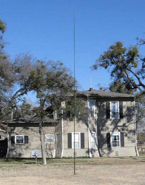

Verticals are great performers, especially in limited areas. While technically a perfect vertical is inferior to a
perfect dipole, in practice few hams put dipoles high enough to approach perfect efficiency, so the performance
gap is much smaller, and the radiation angle of verticals is concentrated at lower angles making them very
well suited for longer distance (500+ mile) work.
I've tried many, many antennas and with my constraints (no trees or towers that can get an antenna above 35'
or so) the 43' vertical has out-performed everything else I've tried.
