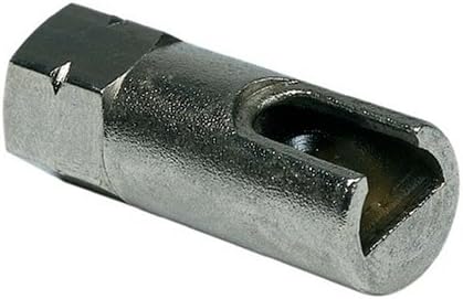

3/17/2021 2:55:42 PM EDT
[Last Edit: SigOwner_P229][Edited] [#8]
Originally Posted By Kitties-with-Sigs:
Yeah but THOSE don't lock, right?  They attach to the lock n lube, but they don't actually lock.
Some engineer type needs to make one that locks.
You may have missed it bc I posted 2 replies in a row. Due to its design the one I mentioned locks on. It has only 1 drawback I've found and that is due to the way it fits on the fitting the seal can't hold extreme pressures so if you have a fitting that is stuck and won't take grease it may not work but for normal flowing fittings it's amazing!
ETA, just screw a normal grease fitting into the female end of the adapter then when you need it clip it into the lock-n-lube then slide it on the fitting and pull back off when done, just as you would with a normal fitting.
Originally Posted By SigOwner_P229:
The best 90-degree grease fitting I've found is this Lincoln made for really tight fits... because you still push it on straight in line with the hose it can truly be a lifesaver is really tight spots where you can't fit a hand to push one on from the side.

4/20/2021 11:20:52 PM EDT
https://images-na.ssl-images-amazon.com/images/I/41csrhB0UcL._AC_SX425_.jpg
Ah Gotcha!  Yes, I missed that.

Recently joined the battery operated grease gun club. Have a new Skid Steer and mulcher being delivered next week, figure it will pay for itself quickly.
Used it last week for the first time. Had to change a hub out on boat trailer. Took about 30 second's to fill with grease (Half a tube). It was very nice.
Dewalt with an upgraded locking tip.
Did you get the locking tip mentioned here in this thread?

@NCUrk
Pounding the table..
The tube of grease I had for my gun exploded in the back of the truck (yeah, cleaning that up was not fun) so I have STILL not loaded my grease gun.
Just sayin.

Old man moment... Forgot I said this...  Give me to the end of the day.
ETA:
Tip I have.
Been called many things: Asshole, hey you, Boats and a few others. The one I cherish is when a Marine called me "Doc"
