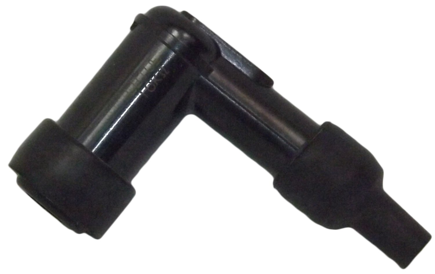

[Last Edit: MateFrio][Edited] [#19]
Don't forget a spark plug boot.  The one on the generator is awful.  May want to pick up some better fuel line as well.
http://a.co/dUzo662
https://images-na.ssl-images-amazon.com/images/I/61u0f-z8SYL._SL1500_.jpg
Good idea. I did the fuel filter upgrade, when I got it. My fuel line has a semi-hard 90 in it. I'll post a pic later. What is a good fuel line and is there a good small molded 90 elbow that could be used? I've never had any problems with fuel delivery and had to drain a second much larger pool. Took about 9 days to drain, only running during the day. Only ran it out of fuel 1 day, mostly because I got there well after dark. Was going through about 1 gallon of fuel every 2 days. Worked like a champ. One of the two pumps is from Harbor Freight. It has an advertised rate of 1600 GPH at 0' lift and 0 GPH at 25' lift. The deep end was approx. 12 foot deep so it was real slow.
Just about anything an auto store has is better than the ones that come on them.  I don't know about an elbow.

8/23/2018 8:50:48 PM EDT
Tried to start mine up for the first time in 7 months. Will not start. The plug boot came apart when I pulled the plug. I had upgraded to the NGK plug when I bought it, so I will upgrade to the NGK boot. I will clean the carb and maybe replace the fuel lines and hope to get it going.
