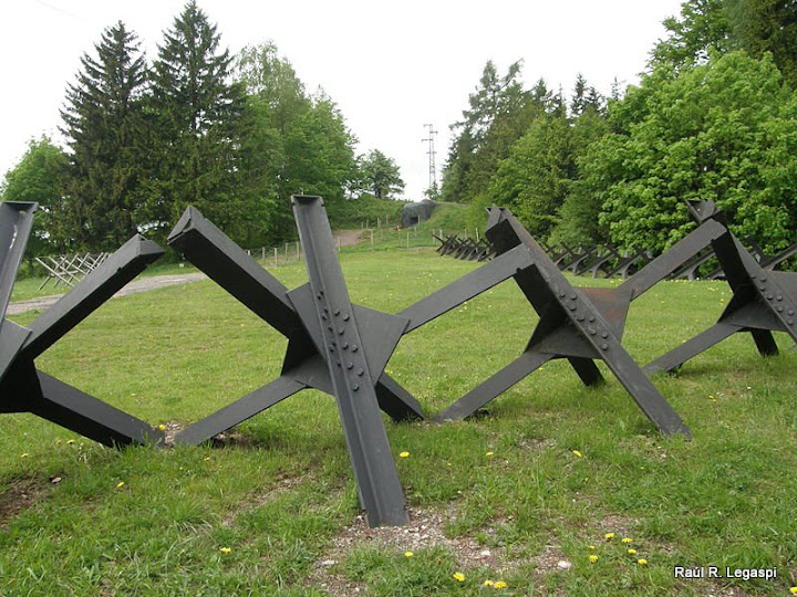

10/9/2011 8:44:19 AM EDT
Not what you are looking for, but cool pics anyways.

http://en.wikipedia.org/wiki/Abatis
http://www.flickr.com/photos/cwpt/3532796339/
eta: I wouldn't deploy something like that today, but it might be nice to have some premade/set aside.
