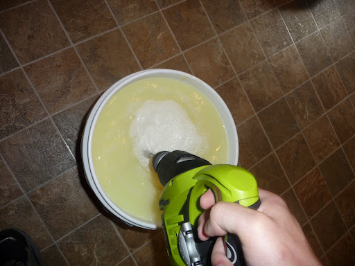

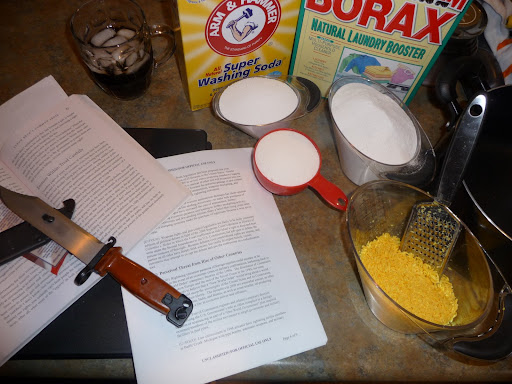

Got the green light for this.... here's how it went...
Got the supplies at the local Meijer store.  $1.39 for the Fels-Naptha, $2.99 for the Washing Soda, and $3.74 for the Borax.
Shredding the soap didn't take long, maybe about 5-10 minutes. Kinda looked like cheese too.
Measured out 2 heaping cups of each Borax and the washing soda (sodium carbonate) since I was using the whole bar.

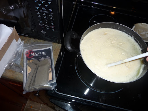

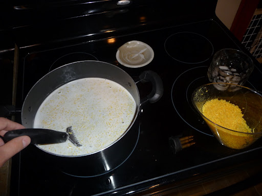

I used about 10 cups of water at first.  Then added a little more after awhile. I added the soap shreds slow.
About 20 minutes into the melt.  Still lots of clumps and unmelted shreds.  A package from Brownells arrived during the interim with a backordered MIAD.
About 30 minutes in, I was cleaning out the bucket and filling it up with hot water when this happened.  The boil over made a mess, but actually cleaned the stove surface better than it was.  Lesson: pay attention to it.

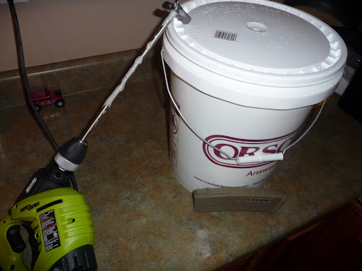

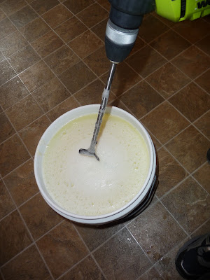

Just added the hot mix to the bucket, which I put about 1.5gallons of hot water into.  This is prior to mixing.
The drill with a paint mixer type propeller on the end worked excellently to mix thoroughly and remove any other lumps.
Now waiting for it to cool so it can be tested in the wash... more to follow.  Thanks to raven for the idea
