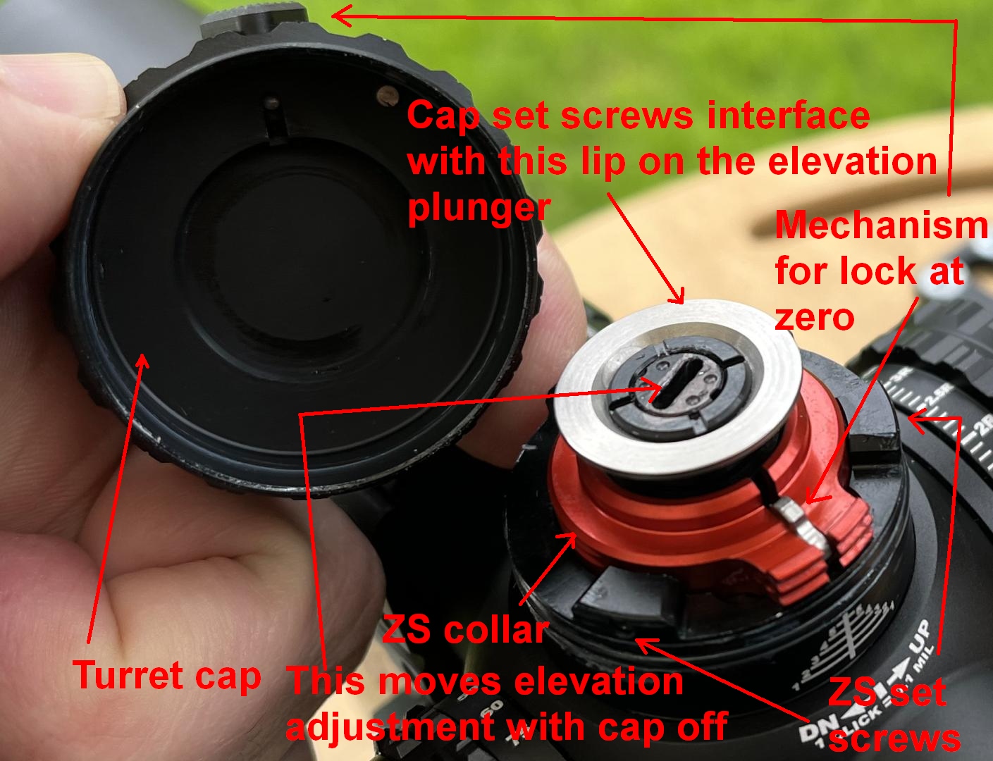

The first thing I notice on the GLx 3-18x44 and 4.5-27x56 are the turrets. Both feature elevation and windage turrets that lock at zero. These turrets are translating, which means the whole elevation turret moves up and down when the elevation is adjusted. As with most designs of this type, the rev indicator consists of markings on the turret housing stem instead of being of the pop-up variety and these markings do not reset when the zero is set, so to use them you just have to remember what their zero point looks like. On the GLx adjustments, the turret cap removes with the usual three set screws and underneath is a very unfamiliar looking zero stop and turret lock mechanism. It is much simpler than it looks. It works very much like the common collar style zero stops except that the collar in this design secures to the turret housing instead of moving with the turret plunger as on most others. The instructions PA gives for this are a bit confusing so I will substitute my own instead. In order to disable the zero stop or to have full movement of your elevation turret while zeroing, loosen all the set screws and drop the red collar all the way down. You can next zero the scope either by putting back on the turret cap or by using a little screwdriver on the top of the turret itself and counting the clicks. Once zeroed, to set zero stop and turret lock, slide the red ZS collar all the way up and carefully tighten the ZS set screws. Be careful and use very little force when tightening the screws, as they are small and impinge on the soft aluminum collar. Replace the turret cap aligning the zero with the zero marking and carefully, lightly, tighten its three set screws. The travel below zero will be a preset ~.4 mils and the turret will lock at zero. It’s a nice, functional, feature rich system. The turrets also have good feel and the relative stiffness of the clicks to the between click travels is well-calibrated so you won’t skip over clicks and lose count. Turrets are 10mil / turn and there is no stop on the windage so you can use its full travel range. Speaking of travel range, The GLx scopes have very high elevation travel. The 4.5-27x56 example I have had a travel of 39.8 mils and the 3-18x44 had an almost unbelievable 59.5 mils. Given the huge elevation range and close focus of about 20yds, you can be sure some rimfire guys are going to be interested.
Primary Arms Optics GLx 3-18x44 elevation turret with cap removed to show zero stop mechanism
As for the other adjustments, the diopters are euro type and aren’t about to accidentally move as they are super stiff. Side focus parallax and illumination are both housed on the left side of the saddle. The illumination is nice and stiff so it shouldn’t accidentally get adjusted when moving the parallax. Even if it does, PA has incorporated a battery saver feature called Auto Live™ that will turn the illumination off if the scope is not moved for some time or is oriented vertically as it would be when being carried. The parallax knob stiffness is nicely calibrated. The power adjustment is a bit on the stiff side but does include an optional throw lever. This attaches at only one location, but the fact the throw for the entire power range is only 180 degrees means you probably won’t need any optional mounting positions.
