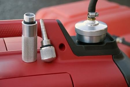

Originally Posted By Foxxz:
http://www.amazon.com/gp/product/B004ZSAS82/ref=oh_details_o04_s00_i00 http://ecx.images-amazon.com/images/I/41TZJPj2pdL._SX450_.jpg For the Honda... Oil change tube. Magnetic oil drain plug. Gas cap to allow attaching to a larger gas can. Fill the tank about half way full and put a tube on the gas cap into a gas can. The generator will siphon gas from the container as it runs. Any idea if this gas cap will work with a vehicle gas tank? I want to use my Honda generator with my motorhome. |
http://www.amazon.com/gp/product/B004ZSAS82/ref=oh_details_o04_s00_i00 http://ecx.images-amazon.com/images/I/41TZJPj2pdL._SX450_.jpg For the Honda... Oil change tube. Magnetic oil drain plug. Gas cap to allow attaching to a larger gas can. Fill the tank about half way full and put a tube on the gas cap into a gas can. The generator will siphon gas from the container as it runs. Any idea if this gas cap will work with a vehicle gas tank? I want to use my Honda generator with my motorhome. My post may have not been clear... You put that gas cap on the honda genny. The gas cap has threads for you to attach a hose to the gas cap. You run the hose into a gas can or in your case an RV gas tank and the honda should be able to siphon out the gas if it doesn't require too much effort. |
http://www.amazon.com/gp/product/B004ZSAS82/ref=oh_details_o04_s00_i00 http://ecx.images-amazon.com/images/I/41TZJPj2pdL._SX450_.jpg For the Honda... Oil change tube. Magnetic oil drain plug. Gas cap to allow attaching to a larger gas can. Fill the tank about half way full and put a tube on the gas cap into a gas can. The generator will siphon gas from the container as it runs. Any idea if this gas cap will work with a vehicle gas tank? I want to use my Honda generator with my motorhome. My post may have not been clear... You put that gas cap on the honda genny. The gas cap has threads for you to attach a hose to the gas cap. You run the hose into a gas can or in your case an RV gas tank and the honda should be able to siphon out the gas if it doesn't require too much effort. Nope, your post was clear. I wasn't sure that the siphon/suction would be enough to draw from a vehicle tank. In the pics I've seen here the gas cans were not elevated but neither were they very much lower. Thanks. |
