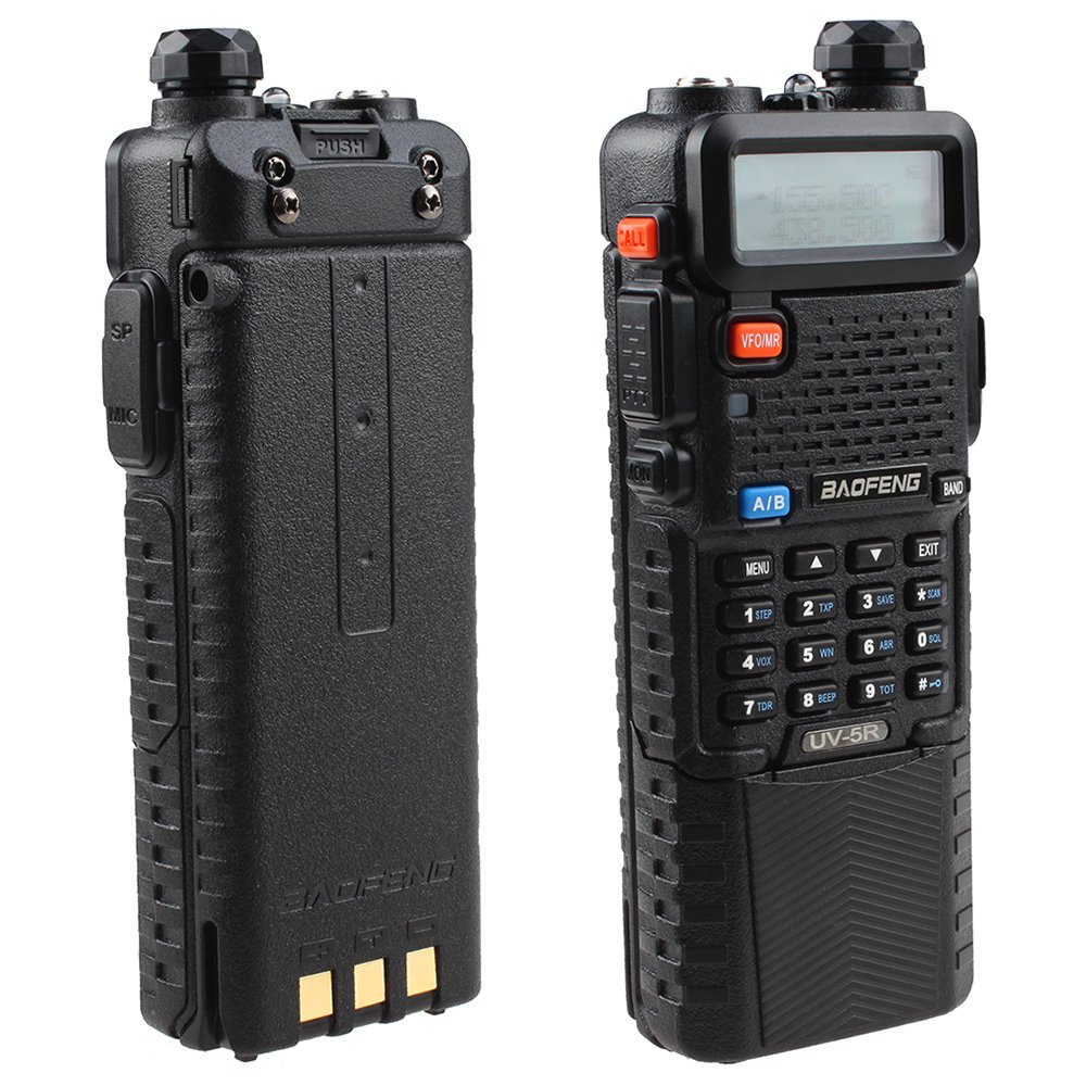

I bought the first UV-5R with the 1800 mah battery, then bought the large 3600 mah battery.  I later gave away the 1800 mah to a friend.  Then I bought two more UV-5Rs, both came with the 3600 mah batteries.  Plus I got some spare 3600's.
One thing that is really outstanding about the UV-5R, whether the stock 1800 mah battery or an aftermarket 3600 or 3800 mah, it is very stingy on power consumption.

Looks like a good deal to me.  The batteries I have are aftermarket.  The one in that photo is made by Baofeng.  Ignore the jack near the top.  There are presently no chargers that plug in directly.  You still need the charging base, which has the regulating components inside.
This is where I ordered two of my three UV-5Rs.  Don't know who makes the batteries, but the fit and performance are good.

Well mine hit a tx lockout :(
I guess ill try replacing the mic jack to get it working :(((((
What are you gonna do brother? When 72oz of Cola runs wild on you!
9/29/2013 10:41:41 PM EDT
It's really not worth the effort.
The mic jack is surrounded by surface mount parts in very close proximity.  There are, I think 5 or 6 points that need to be desoldered.  By the time you are done you'll damage the surrounding area.
Your time is better used elsewhere.  Just toss the radio and buy another.  Think of it as a broken Bic pen.
