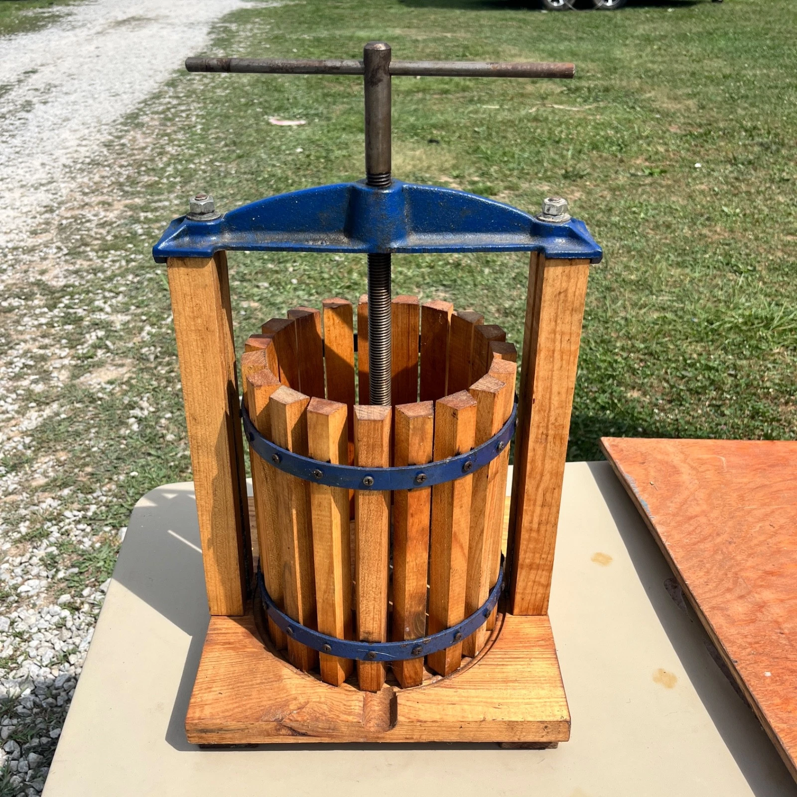

We have 3 apple trees.  If i prune them they produce enough apples to fill a pickup bed.  For the last few years a friend comes and gets them and makes cider. I've been thinking about just getting a grinder and a press so we can process a few buckets of apples at a time rather than throwing the windfall in the trash until my friend has time to come pick apples.
Any recommendations?  I'm looking at the Pleasant Hill Grainery apple grinder (manual with a weighted flywheel type drive handle, and their corresponding stainless tank screw type press.  Together it comes in at near $1,000.  I've looked at the bladder type which look awesome, but I saw the Amazon one has been known to blow up the bladder - which is not sold as a part, rendering the thing useless.

Growing up we had one similar to this.
We cut the apples into quarters and use the press. No need to grind them.

First try: 24 lbs apples (one 5 gallon bucket) gave me 1 full gallon of cider plus about 1 juice glass.  Press works really well, grinder / masher thing is a bit awkward to use by yourself.  It really helps to keep the wheel spinning and add apples.  But it can be done by yourself.

Yeah, I'm pondering it.  The frame the grinder is mounted on swings 180 out of the way, then the press plate swings down for pressing.  I dont think it would be to difficult to hang a motor off of the frame.  Kind of wondering if a cordless drill would run it - my milwaukee will drive an 8" auger through a 18" of ice with no problem.

Not quite knowing how much cider to expect I ordered 50 milk jugs (1/2 gallon) with caps.  I have seven left and there are still a few apples in the last tree, maybe 4 - 6 buckets worth.  Gave one 1 gallon jug to ex-son in law and his girlfriend, and I keep an overflow jug in the refrigerator.  I usually press two 5 gallon buckets worth of apples and it fills four 1/2 gallon jugs plus a quart +/-.  The quart goes in the overflow bottle.  So so far I've fiiled 43 1/2 gallon jugs, plus one 1 gallon, and filled several overflow jugs - probably 3-4 gallons worth.
Fairly impressed with the set up.  It only takes 2 or 3 minutes to grind a full to overflowing 5 gallon bucket of apples.  Probably another 5-10 to press the juice out.  1 bucket is about 100 apples and about 24 or 25 lbs.  I also bought mesh bags to line the press bucket with so the cider is free of larger chunks and it doesn't leave a layer of settled sediments in a jug even after a few days.
