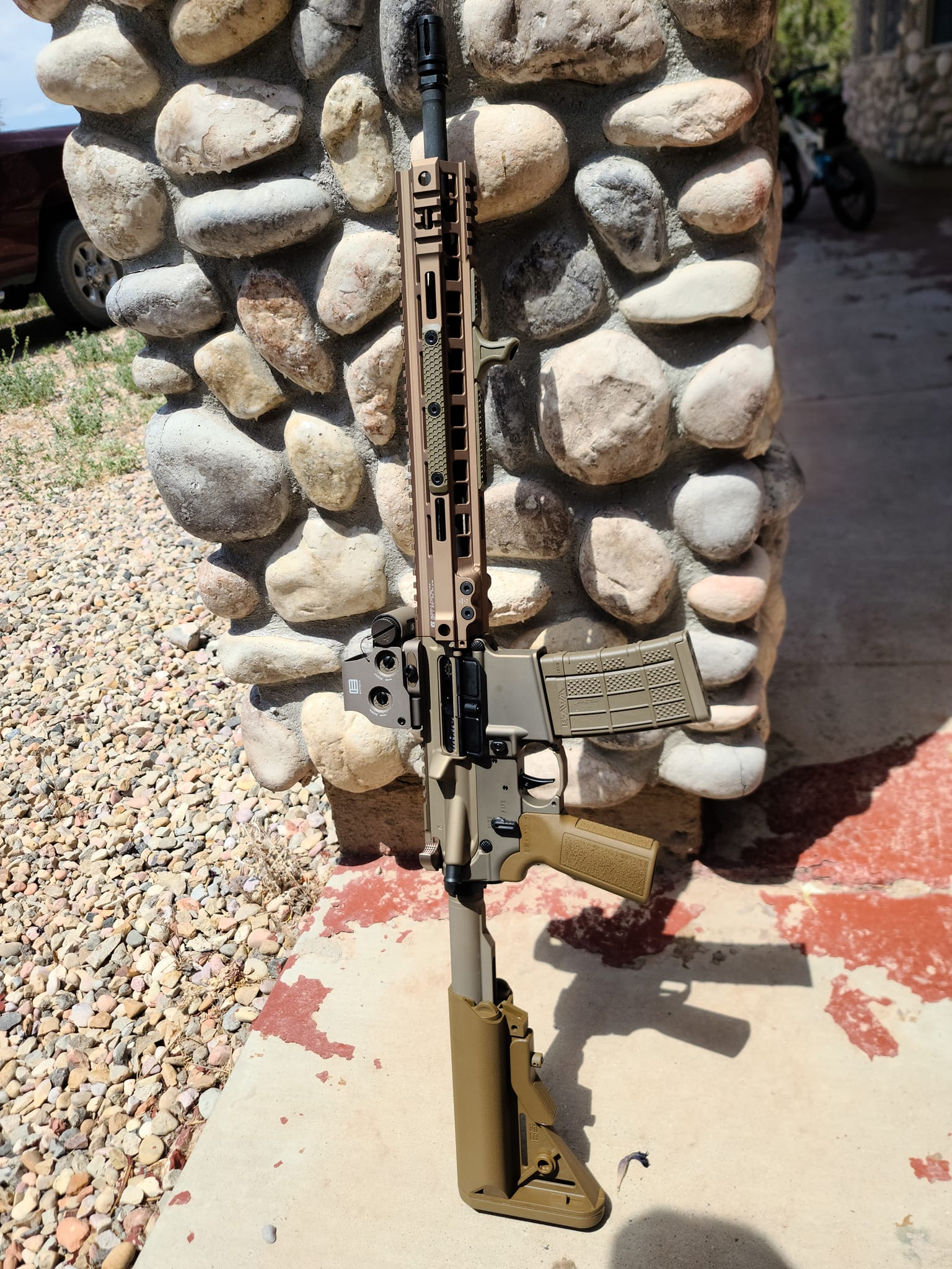

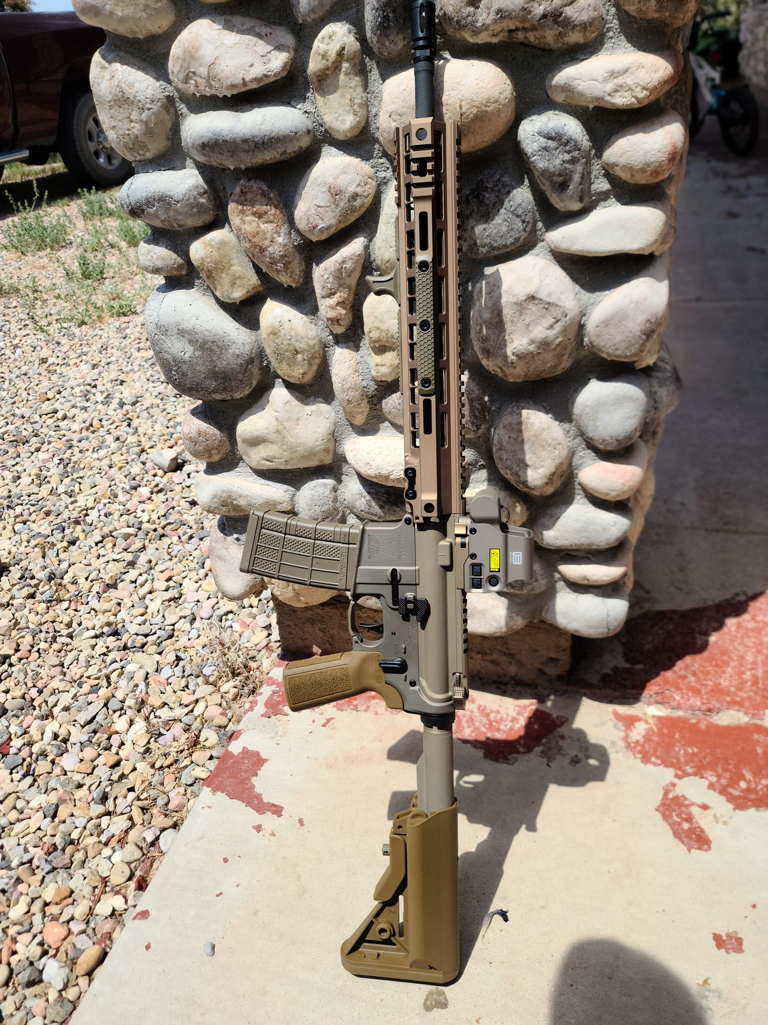

Hey all- I pieced together a Super Duty with a Geissele 16" barrel, Geissele gas block and everything else G except a CMT bcg that headspaced fine with this barrel. Anyway, I was running a Geissele H2 buffer and spring and it was like there was no gas. So, I swapped out a standard carbine buffer and standard spring and spaced the gas block .025" off the shoulder and it is cycling now, but short-stroking a bit (not cycling far enough to pick up the next round and a couple cases didn't clear the ejection port).
So, back to the drawing board. I put the gas block back to flush with the shoulder and I will test fire again tomorrow, but I haven't ever had a gun gassed so light that this was an issue. The gas key on the bcg is tight so I know I'm not losing gas there. Shit, I even staggered out the gas rings, knowing it isn't going to matter. BCG is lubed up good too. Anyway, I am using some Fiocchi 556, so I don't know if the ammo might be contributing, but I haven't ever had cycling problems with this ammo before. I'm sure it is loaded to NATO specs. Any thoughts?
EDIT to add: I'll try the H2 buffer and spring again tomorrow as well, because as best I can tell this is what the 16" SD ships with from the factory. Also, I did clean the chamber with a GI chamber brush with some Hoppe's as well.
