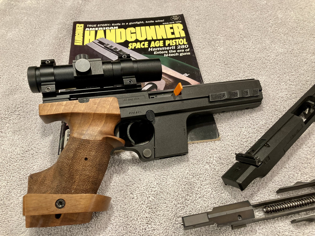

Look at these things.
So damn gorgeous and cool.
Now those are some proper space guns.

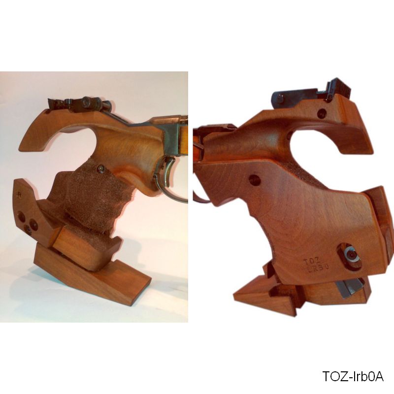

Link Posted: 4/21/2024 9:51:50 AM EDT
I've got a Baikal IZH-46M air pistol. With the 11" barrel and the mass of the cocking lever under it the thing is very nose heavy. The anatomical grips counteract that a lot, especially the palm shelf. Counterweights might be useful or even  tungsten putty.
But those type grips are designed for one handed shooting only.
It would be interesting to design a grip that had the support features of a target pistol's grip for both hands allowing two handed shooting.
Perhaps making the thumb rest lower so that your support hand thumb uses it and your strong hand thumb lays over it, as in the freestyle thumbs forward grip. USPSA Open guns have "gas pedals" that are thumb rests for the support thumb. Couple that with a palm support for the support hand, since modern grip technique transfers almost all recoil control to the support hand. Thus the support hand grip does what the classic anatomical grips do for the strong hand.
If the pistol's grip was purpose built to optimize freestyle shooting, without concern for a fast draw or ambi shooting, and no restrictions related to containing the magazine...a radically different grip might result. Anatomical grips support and stabilize the pistol but also help isolate the trigger finger. What if the "grip" was more heavily biased towards the support hand? Competition rules place limits on how far back the palm shelf can extend limiting its wrist support. Pushing that into the realm of an actual wrist brace(don't shoot my dog, ATF bro!) might be fruitful.
For that matter since this will be an SBR, some type of forward pistol grip might be worth exploring. There exists no orthodoxy regarding the value of one for accurate or rapid semi auto shooting, so who knows if there is a ROI.
Various pistol grips
Counterweights
The Pistol as Epee'

Link Posted: 4/21/2024 12:57:59 PM EDT
https://qph.cf2.quoracdn.net/main-qimg-82d8cb0dd3f38e2b7c65f1d3604b92a3-lq
https://www.formgriffe.de/thumbnail/a3/21/be/1663934186/TOZ-Klemmschraube_800x800.jpg
https://www.formgriffe.de/thumbnail/61/88/8a/1663933243/TOZ-lrb0A_800x800.jpg
https://img.olympicchannel.com/images/image/private/w_250,h_250,c_thumb,g_auto,q_auto,f_jpg/primary/v9fz7pouex2uqoggcujf
https://www.pyramydair.com/blog/images/05-14-08-free.jpg
Counterweights
https://i.ytimg.com/vi/z96BMiKPRks/maxresdefault.jpg?sqp=-oaymwEmCIAKENAF8quKqQMa8AEB-AH-CYAC0AWKAgwIABABGGUgVyhPMA8=&rs=AOn4CLBOtbmX2o7FZQOzccV0R_CQhGMDlQ
The Pistol as Epee'
https://www.albertonsportsshootingclub.co.za/disciplines/issf/free_pistol/free%20pistol.bmp
JESUS CHRIST! Those are some weird ass looking grips. Competition guns are a whole 'nother beast, apparently.

Thank you for the info and pics! I had thought about doing a highly true-to-anatomy two-handed grip like you’re describing, but I couldn’t figure out how to do it while keeping the gun truly able to be shot by lefties and righties without changing out the grip. Right now I’m picturing it’ll likely be similar in shape to the Benelli MP95 grip, with a larger palm shelf. But that could change in the future!

Link Posted: 4/21/2024 5:30:20 PM EDT
Counterweights
The Pistol as Epee'
The Free Pistol course is 60 single shots at 50 meters in 2 hours. The 10 ring is 1.9 inches in diameter.
They're basically trying to emulate a bench rest.
