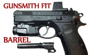

Looking into getting a threaded barrel for my 75, found this.
Now, Im assuming this should work, but its over $200 and would still require a gunsmith to make sure it fits. Are there other options available? Or is this the best option to go with?

When I last looked into suppressing CZ's the conventional wisdom was the bbl on the standard models was too thin and would result in accuracy issues. The thicker P01/SP01 were supposed to be good to go as hosts.
10/20/2025 6:57:19 PM EDT
CZ did sell the classic 75 with the omega trigger and a threaded barrel in the 2016-2019 timeframe.  I don’t think it diverged dimensionally from the traditional 75 at all.
CZ still lists a 75 threaded barrel in the parts store though it’s out of stock, so I assume it would work fine.
I do have an SP-01 with a factory threaded barrel and it’s pretty nice.

If you are marginally capable this is easy to fit.
Fitting a Barrel to a CZ 75 Style Pistol

I was able to get a factory CZ75 threaded barrel from a private seller on Sturm a number of years ago. The barrel required hand filling to get it to fit which wasn't hard. Its by far the quietest host gun I have. Think I have like $125 for the barrel 5-6 years ago.

Well, just got the barrel Saturday, gave it a dry fit, and it seemed to go in without any binding, even seemed to be a tad loose, but that was without the spring in the slide.
But the CZ custom barrel doesnt seem to have a dimple for the recoil spring's plastic bit recoil spring guide* to fit into, not like my stock barrel.

My CZ Custom barrel is the same as yours without the dimple, doesn't need it to function. Assemble has normal, you'll be fine.
