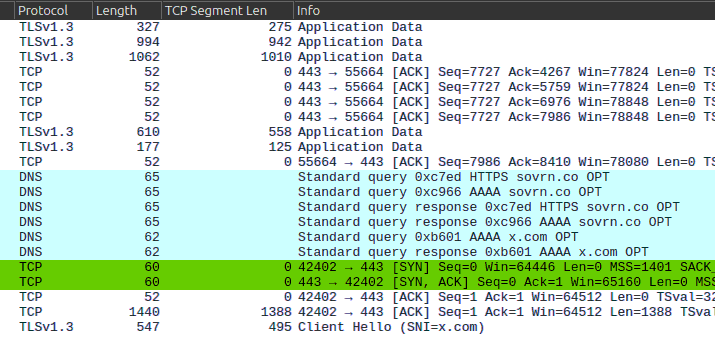

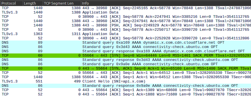

Want this to work so bad, but I visited the drag show viagra link in Firefox running the above filter in uBlock
https://www.ar15.com/forums/General/Man-Spikes-Drag-show-punch-bowl-with-Viagra/5-2859630/
Hovering over the date in the twitter box in the OP shows a link directly to x.com
Hovering over the x link posted below the twitter box shows a sovrned link
While running wireshark, clicking the twitter date shows query in light blue:
And clicking the sovrned link shows this:
