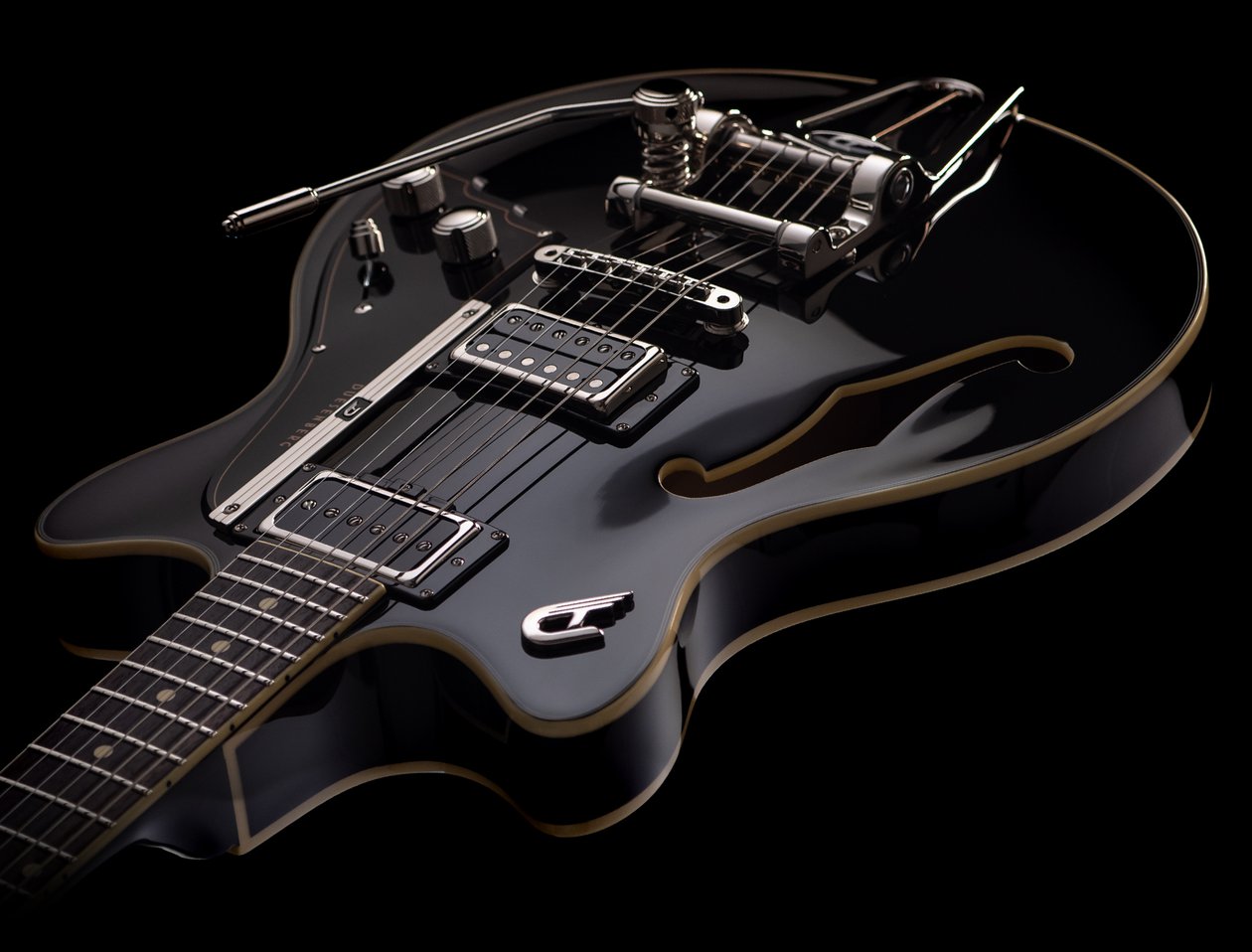

Next up, I'm giving my Schecter a more Duesenberg look, with open pickup covers.  Ordered a nickel silver ring for my bridge PU and an Artec neck humbucker size P90 (8k) that has an open cover...this look:
On this guitar...
From what I can tell, a P90 should do just fine with the 500k pots and .022 cap that's already in there for the stock humbucker. Always found Artec pickups to be hidden gems:
