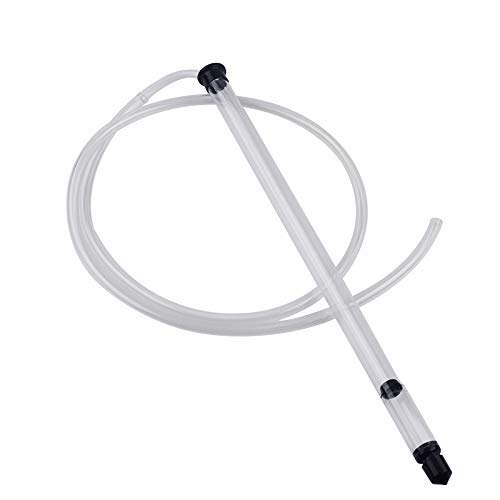

That's pretty clear. I've got to try that. Digging the oranges out should be fun tho. Lol
1/28/2019 4:26:08 PM EDT
@subvet707 There is a device that will remove the liquid and leave the solids. I use it.
Amazon Product
  • The Large auto syphon is ideal for most 3 to 5 gallon (25 litre) vessels
  • Easy to use and eliminates the need for sucking
  • Length 45cm.The tube of the main syphon is approx. 25mm at it's widest point
1/29/2019 12:04:54 AM EDT
Oh I've got one, I'm just thinking pulling orange sections thru that little neck will be fun. Nothing a coat hanger can't fix I'm sure
1/29/2019 2:26:29 AM EDT
https://smile.amazon.com/gp/product/B014T3LHFA/ref=ox_sc_act_title_1?smid=ATVPDKIKX0DER&psc=1
is the the correct setup? If so I am so doing this.
1/29/2019 7:15:35 AM EDT
That will work

1/29/2019 1:02:32 PM EDT
Yes sir, that's it.
