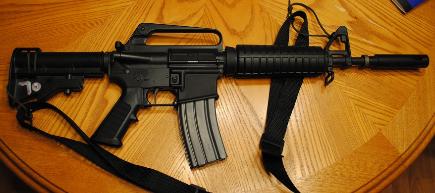

I have one in a CA legal config. It has a 10.5 inch a2 profile barrel and the 5.5 inch flashhider. bit heavier than the lightweight carbine i had but i like it alright. just dont shoot it much really. its different, though, so I like it for that

that's pretty much the set up I'm looking at, A2 upper and all

Um you do realize that is a 15.5" barrel right?
Not 16" so would still be an NFA SBR?
You need an 11.5" with a 5.5" to get 16" as measured with a rod from the "Muzzle" to the BOLT FACE.

Thanks it's not NFA. I bought the thing 3 years ago and the specs are a full 16", so yes, it is a 11.5+5.5. I only remember that the hider is 5.5 so in my head, and when writing the description, I accidentaly stated it was 10.5. I've taken to the range and to the LEO range with LEO friends and I haven't ever had trouble. Appreciate a fellow arfcommer lookin out, though
11.5+5.5=17 inches. Just sayin'.
The threads on the barrel / FH overlap by .5" each. 11.5 + 5.5 = 16". Next......

it's 11.5 + 5.5 - 1 as the threads are about an inch long, if I remember right?
So yes - if you simply placed the flash hider on the barrel without screwing it down, it would be 17". However, once you screw it down to the shoulder, it's 16 + a hair. I had the same argument with a guy from Bushmaster in 2001, when I sent an upper in to be rebarreled as whomever had the upper before me really botched it up
