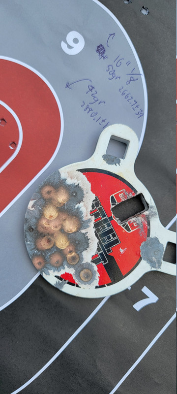

Steel.   You can shoot steel at 5 yards [CQB - 5 might be tight due to spall - I have tested at 15 yards just fine]  with an AR15 with these, and it works just fine, with no damage and no splashback.  The is MK311 Mod 3, AKA AA40, AKA XM556NT1 ammo.

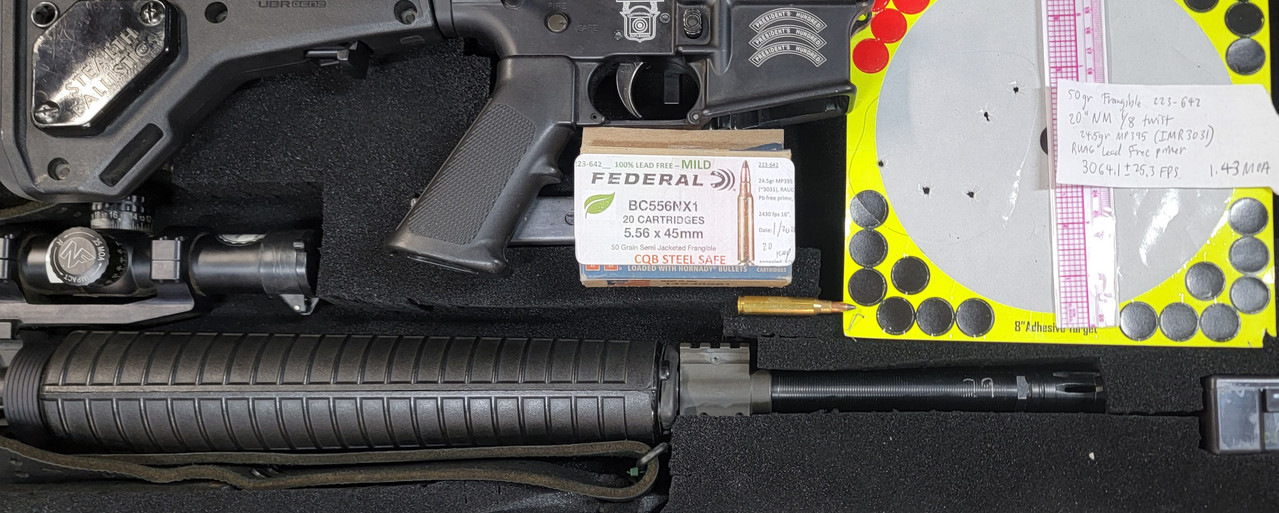

Here's some load testing to add to your thread. We've used these for over 6 years and they've work well with 1:8 barrels. I've stopped using lead projectiles altogether when doing dynamic training. Accurate enough to easily hit 8x11 plates at 125yds. I was hitting small oranges at 95yds offhand.
Haven't noticed any fliers. Can you say how far out these fliers were you've experienced? The targets below were at 50yds. I use 25gr of IMR4895 normally. It's a heavily compressed load. Have some other powders loaded up to test out. Just need to get to the range again...
As you say, they're great for close in drills on steel plates. No damage to the plates at all. We still cover our face/arms and wear eye pro when shooting at plates close in.

Great reply.
When I say "fliers" i mean i can get 4 shots in a sub MOA group at times,  but that 5th will throw a 2 or so MOA on me.  Still plenty servicable for the job.

Not sure I would shoot steel at 5 yds even with frangibles.  I have been cut more by copper jacket material than lead when frag comes off steel.  And a lot of the frangibles still use a copper jacket.
Besides, a lot of CQB training is hostage rescue focused for me, so just hitting steel isn’t cutting it, need to see that they were good hits.

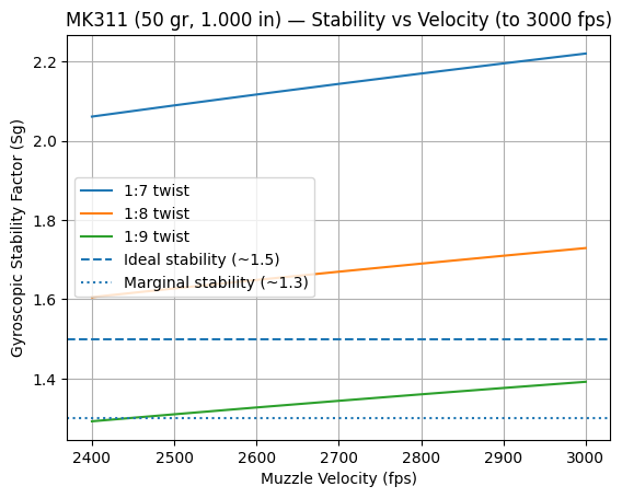

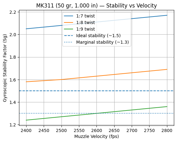

So - I asked AI to do it.   And yes, as much as I dispise AI, if you haven't been using it, or mastering how to use it, you are very quickly going to get left behind.   If curious, here is how I framed the question to ChatGPT
"This one will test your abilities. Berger Bullets makes a "stability calculator" on their website, which calculates indicates a factor which will show if a bullet in flight at certain conditions is stable or will wobble. My request is to use that calculator, or those mathematics if found elsewhere to calculate the stability factor for a specific bullet, at a spectrum of muzzle velocity and barrel twist rates. In particular, the bullet is MK311 (or "Frangible brown tip"), which is a lead-free 1" long 50 gr practice bullet for training, designed to shatter on impact at close range target encounters, for training safety.
Conditions for the calculation are 70 °F, 50% RH, 800' elevation. Distance to target is 100 yards (which I don't think factors in to this assessment, but just stating).
Conditions
1/7 twist BBL A) 2400 FPS B) 2500 FPS C) 2600 FPS D) 2700 FPS E) 2800 FPS
1/8 twist BBL (same A-E conditions)
1/9 twist BBL (Same A-E conditions)
Prepare a graphic showing those conditions and the resulting stability factor
This is what it gave me back
That's how scary-effective AI is rapidly becoming.  2 years ago this was pure fantasy.  1 year ago it'd give me a stick figure of a guy with a rifle.  Today, it's doing this.
Back to the assessment, for my load, in 1/7 at 2450 FPS, I have a solid SG of  >2  But my 18" AUG with a 1/9 twist BBL is going to struggle. I 'll get more MV, maybe pushing 2650 FPS or so, which gets me to the marginal 1.3 SG, which ... shoulllld  work OK with this load.  I look forward to testing it.  My 1/8 16" M4gery, should be fine with these.

So basically, the hard frangible center of this bullet, vs lead, causes nuances if you overstabilize.  and naunnces if you understabilize.  So recommended sweet spot for this bullet is:
1/7:   ~2400 FPS out of a 1/7 - slower would be better, but I doubt you'll cycle.  I run closer to 2450 fps out of my 1/7, and am happy.  when I go over 2500 FPS, groups open up biggly, just like AI hints at.  To get the right pressure cycle to run well at that kind of speed, this is going to do best in the shorter BBL's, like 10.3-12" BBLs.  Which is exactly what I bought these bullets for and use them for.
https://rumble.com/v6r5v8o-say-can-i-try-your-binary.html
1/8:  <2700 fps out of a 1/8.  Go as slow as you can and still cycle.  I haven't tested my 16", but estimate I'll be clocking about 2600 FPS or so with my load, which should be about perfect for this bullet

To follow-up, if you are testing these loads in your 20" 1/9 BBL, where the top end was pushing 3000 FPS, your performance is exactly what AI is predicting in the green line.  Where the stability at the top end is getting better.  Note AI is saying being between the blue dotted line (1.5) and below 2.0 is ideal with these bullets, and if you can't - the closest you can get to that window, the better your results will be.
(unstated, but assumed from other commentary in thread this is the 1/9 20" BBL and the top end was around 3000 fps - per posters links - but confidence in this assumption is not certain))
AI prediction is also in line with Blowouts post, of two different powders, where the only results were at the top end.  And of those two, the one with the higher top end MV, which had an SG closest to getting to 1.5, also had the tighter group, of the two tighter groups.  Also consistent with AI's suggestions that the faster speed in a 1/9, will give the better results.  But again, bewarned - AI is also saying that the SLOWER the speed in the 1/7, the better the results will be.  And my own (limited) tests, agree with that.
As to posting on this before - I have new analysis, and would have just added to the original thread, but it's already been archived (our archive timer is a bit quick)

Dont shoot rifles at steel at 5 yards....no matter what bullet is used.
Seriously, that is lethally bad.
Frankly, rifles on steel is problematic at 25.  You can mitigate it by sloping the targets toward the dirt and not having target stands that can splash...but it still gets dangerous if the target face is dented.
I've seen it and had to take shooters to the ER.  Rifle velocity + steel ends with penetrating gunshot wounds to the shooter unless you are very very careful and have 40+ yards of air space between you and the target.  Even then...frangible.
1/27/2026 12:47:53 PM EDT
FWIW, according to DOD Spec, 7 yards is the spec minimum distance with these.  And I'm running mine a lot slower than DOD spec.
https://www.energy.gov/sites/prod/files/2013/05/f1/June_2012_Bullet_Trap_and_Steel_Target.pdf
(see Sect. B6)
But sure, I'm shooting closer to 10+ yards.  5 is pretty close; I'll update OP.  And while I generally agree that 5 yards is pushing it; you've had that experience with frangible on safe-flat steel mounted correctly mounted, with shooters wearing eye-pro and covered arms and legs?  Doubt.  I fully agree with conventional bullets, or with damaged targets.
These bullets shatter on impact.
Mk311's do have jackets, so likely there will be more spall from those vs monolithic.  Of note though, I'm running mild loads in an 11" BBL, so I'm impacting at 2400 FPS.  Not 3000.

Finally had chance to do some testing
Merged it with dateing (once I figured out how to do that, it's pretty much the only way I can get to the range anymore..)
 She was cool and accommodating to help with the testing.  I'll ask her out again - maybe (maybe not), that's another topic...
So we are testing an 11.5" 1/7 (~Mk18 gun) and 16" 1/8 (~M4 gun)
Targets at 50 yards.
Mk18 11.5" 1/7 twist
The 50 gr jacketed frangible Mk311 did better aimed at the #8) than the frangible  42gr trash (1/4 of which broke in feeding).  Not great. But just a red dot, and good enough for service.
16" M4 1/8 twist
Did a little better than the 11.5 1/7. But 2.5x, scope which may have helped.  Decent service for CQB; I can do better with M193.  But good and servicable enough; that's maybe 2.5 MOA.
At 10 yards we fired the 50  gr MK311 jacketed browntip ammo into steel, using the higher velocity 16" gun.  No damage.  We both watched for splashback or spall and neither felt anything.
