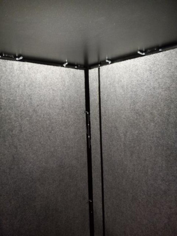

I've come back to share some of my disassembly findings.  I am not close to done yet.
Zanotti recommends that you lube the pins before installation.  I used a generous coating of CLP, but they want grease.  The half dozen pins I've pulled so far have come out without trouble.  The pins are clean and rust free which is the P part.  The L part is minimal and the carrier has long since evaporated.  I would recommend (as they do) a good lithium or silicone grease and plan to use one on reinstallation.  Don't go crazy; a thin coat is plenty as the pins fit tightly.
The pins are right-angled at the end.  Be careful when hammering them in with even a rubber mallet.  I have one that I bent slightly during installation because I hit it on the end instead of at the turn.  I have not extracted that one yet.
For disassembly, I made a short handle out of CPVC that I had lying around.  I slip it over the end of the pin and wiggle back and forth about 60 degrees while pulling the pin out.  It is working well so far.
When you finish driving the pins in, I don't recommend pushing the ends all the way over tight to the sides and top.  Leave a little gap so that you can get your disassembly tool in without having to pry the end of the pin away from the side to get hold of it.  1/8" doesn't intrude much on the safe but it makes a difference during disassembly.

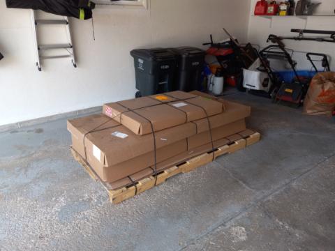

The safe has arrived! Truck shipped to my residence (for a fee of course), and the driver even wheeled the pallet around to the back of the house. 3 boxes on the pallet: top and bottom on the first, left and right sides on the second, and door and back panel in the third. The miscellaneous parts were distributed throughout the boxes.
Pics to come.

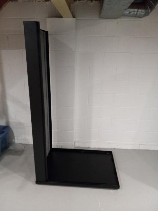

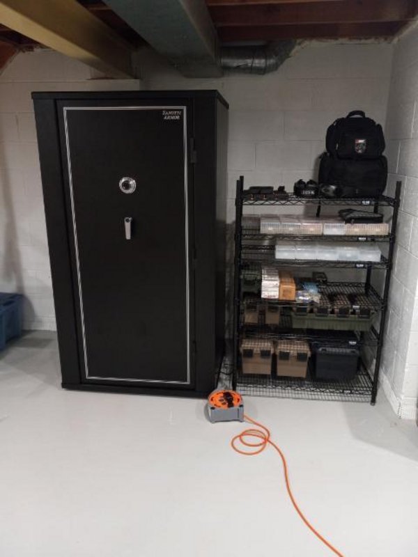

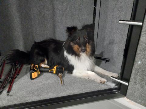

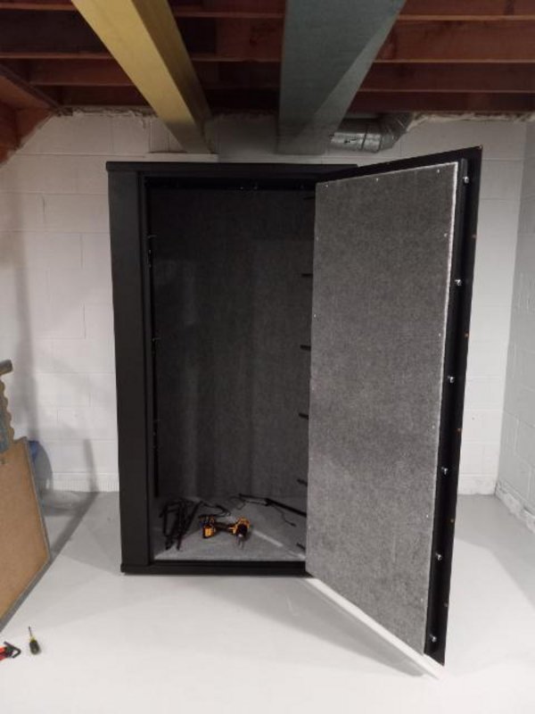

Finally! Got the safe installed, goldenrod installed, lights installed, and drawer...almost installed. pics and more description to come.
And the pics:
This pic shows how little clearance there is between the top and the ceiling. Makes it virtually impossible to tilt it over to take it out the door whole. I'm going to lie and say I planned it that way.
This pic shows the optional drawer. I'm not sure it was worth the cost.  It's handy for small items, but there are other, cheaper solutions.

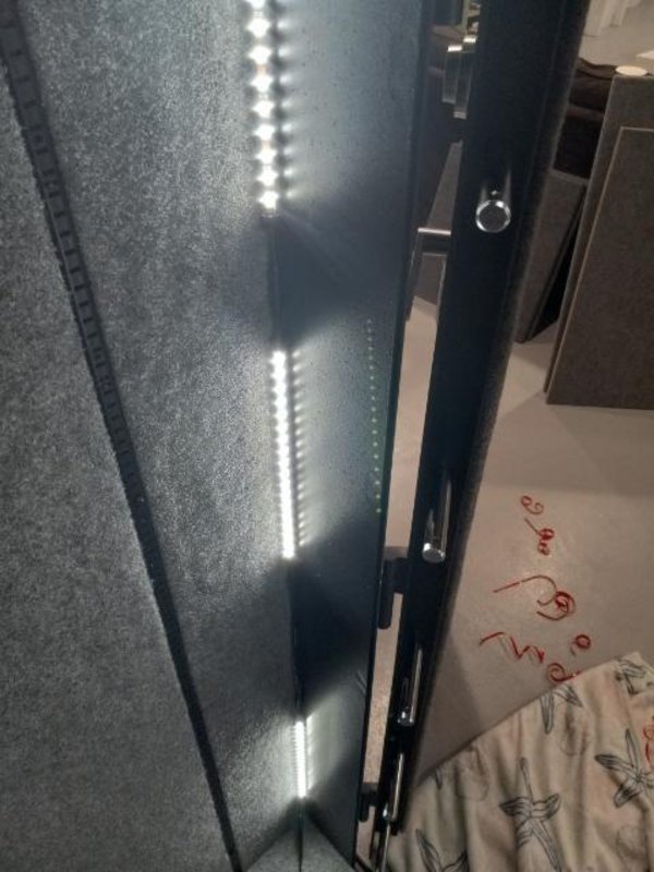

This one highlights the lighting system with room lights off.
