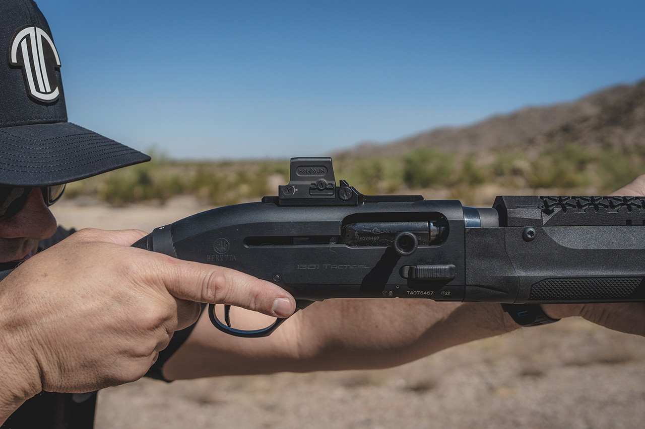

LTT Fastback mount. I'm about to order one. I'm hearing great things about it.

Another vote for the LTT Fastback. One of the advantages they sell it with (and you may or may not see it as an issue - that is up to you) is that it sets the optic more rear-set of the ejection port, allowing less obstruction to over-the-top ejection port loading of single shells.
