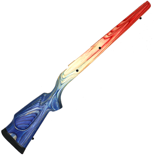

Saw two wood sets sell recently for large $ without any metal and they where not in perfect condition. Boyds makes like 10 different stupid ridiculous stocks for the Mini-14 that no one wants or buys. Why can't they make a run of replacement wood for the folders. If they can make a stupid pimped out BLUE laminate thumbhole POS styled complete stock that no one wants, a tiny replacement wood would sell much better. Yup, people are making a run on this model, they surely can't keep it in stock. Manhours, material and costs and DEMAND to make this POS compared to folder replacement????? https://www.boydsgunstocks.com/images/default-source/default-album/c10190.png?sfvrsn=b2247f6c_2 Maybe they just make poor business decisions?
