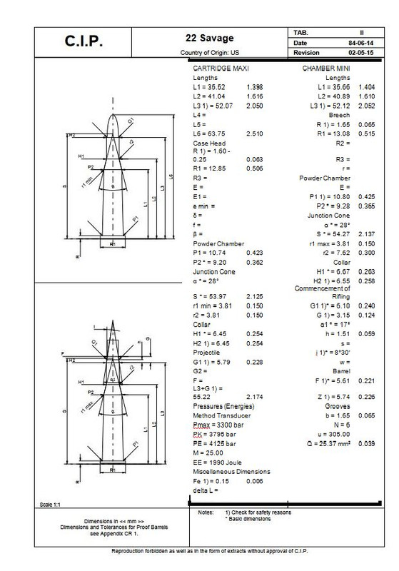

I checked but did not find SAAMI spec drawings for this cartridge.

CIP, the European equivalent of SAAMI, lists “22 Savage” (which is apparently one of several names for .22 Savage Hi-Power).
Here is the CIP page for 22 Savage.  It’s a pain to translate specs for what is an early 20th Century US cartridge from metric measurements, and even more so because the pressure standards CIP uses aren’t at all convertible to SAAMI-equivalents.  You can get comparative pressure numbers by looking at other, similar cartridge standards, which I think is about the best to be expected.

Today 9:28:19 PM EDT
[Last Edit: Trollslayer][Edited] [#15]
Does this help?  Dimensions in inches next to mm dimensions.
