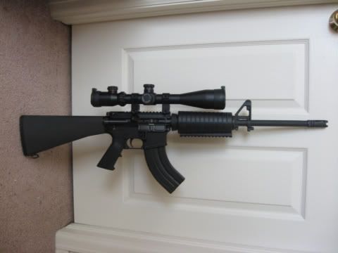

I can only answer part of you question. The FSB doesn't get in the way with most optics as you will usually need some sort of riser (or extra high rings)  to mount under the sight. If it is a scope I needed a riser to access the charging handle.
This is without the riser, haven't got around to taking one with it on for some reason. I have since put a .83" riser on this. You can not see any of the front sight but pulling the charging handle is a PITA. With a red dot or holo sight you use a riser or mount to raise it for co-witness.
