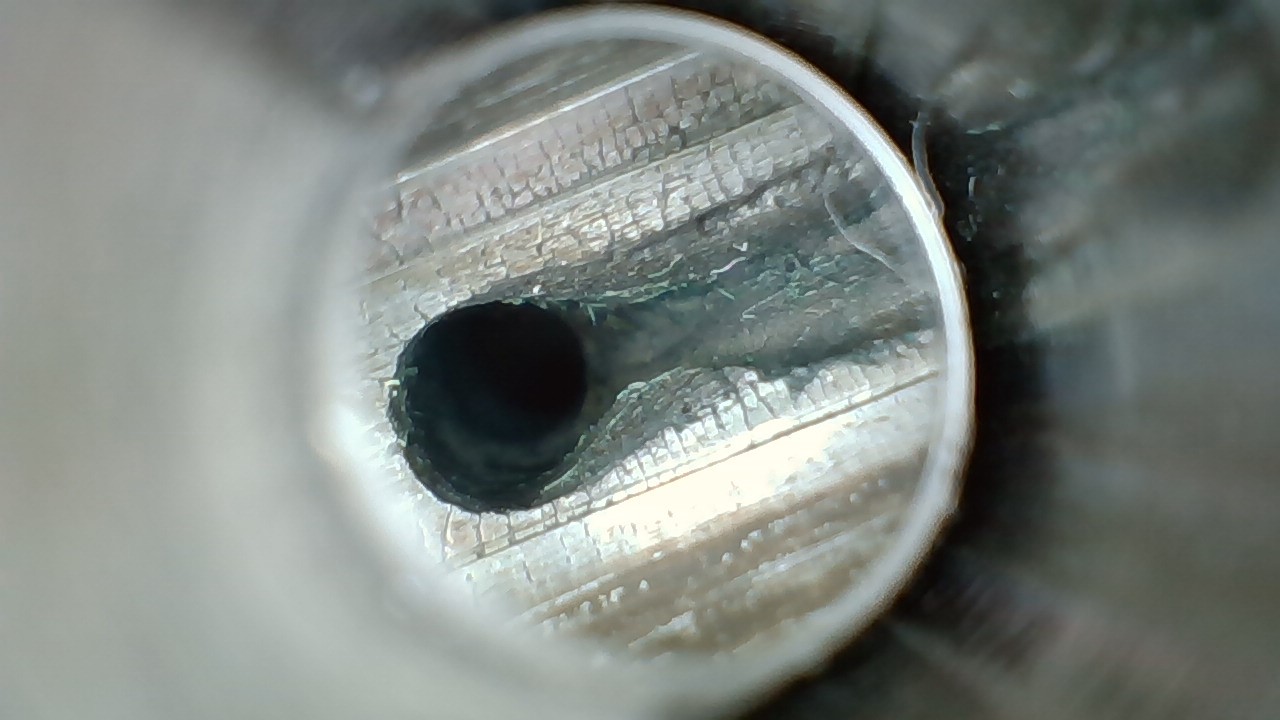

I'm no expert, just curious, are the copper deposits shown on the side of the gas port closer to the muzzle or the side closer to rear / chamber?
Closer the the muzzle. For reference, here is a proof with 400 rounds on it

Shoot it enough and it'll knock all the high spots off. Looks like they pushed the drill hard when they drilled the hole instead of letting the drill do the work.

The gas port has had a chamfer on it. Most high end barrel makers do this so there is no burr. It looks like 50 rnds to me.

If there is a burr the erosion will eventually remove it.
5/14/2026 7:43:27 AM EDT
This is what 15k+ rds nearly all mag dumps looks like.  Ie., OP has zip to worry about.  Pic taken after Patch-Out application.
