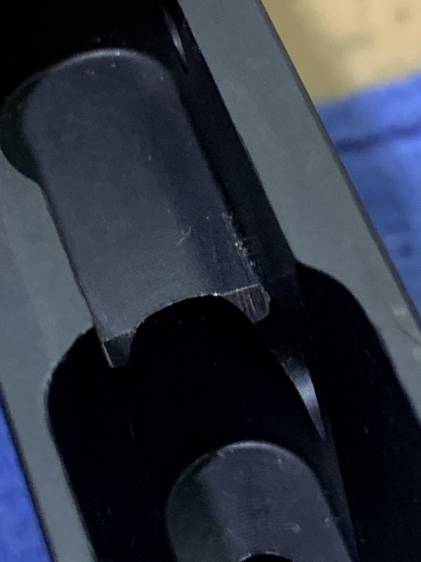

This is exactly what I have been doing with mine in Anderson receivers and PAA uppers.  Out of sick curiosity, I modified one of my receivers today with a needle file reducing the area behind the cam where it was milled.
Using a new lever, it still bound up slightly.  I considered reducing it a little more until the circular cut would have been straightened out between the walls.  I opted to just use the modded lever that is in it now and working.  I do think this will allow for a little more rearward travel and eliminate the need to mod levers in the future if there is ever any breakage.
Regarding buffers and weights, I have had a 100% success rate with H3’s in carbine tubes and standard and the KynSHOT buffers for standard tubes.
9/15/2025 1:31:25 AM EDT
Thanks IdahoPCCinc for starting a dedicated thread for this unsung hero style of FRT!  These work and work very well.
https://i.postimg.cc/wMDpNDDP/IMG-3468.jpg
Regarding buffers and weights, I have had a 100% success tate with H3’s in carbine tubes and standard and the KynSHOT buffers for standard tubes.
