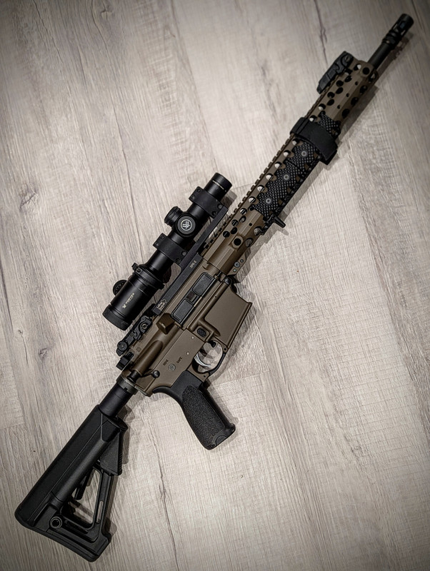

Originally Posted By Buckeye67: I built this in 2014 or so. It's still my favorite AR. Barrel and BCG are Centurion Arms also. https://i.postimg.cc/zGyqkt4z/PXL-20250211-021252079-PORTRAIT-2.jpg That brown is good looking, I've been kicking around the idea of doing one of mine in a similar "medium brown". You may have just sparked the fire that will get me into the paint booth again. |
Originally Posted By Buckeye67: I built this in 2014 or so. It's still my favorite AR. Barrel and BCG are Centurion Arms also. https://i.postimg.cc/zGyqkt4z/PXL-20250211-021252079-PORTRAIT-2.jpg |

That is just simply beautiful. Who did the camo job? I so want to do this to my go-to rifle. |

Originally Posted By Stickman: I have friends who have a hydrodipping shop. I have had them do a few of my builds and am quite happy with them. Originally Posted By Stickman: Originally Posted By urbankaos04: That is just simply beautiful. Who did the camo job? I so want to do this to my go-to rifle. I have friends who have a hydrodipping shop. I have had them do a few of my builds and am quite happy with them. Can you PM their contact info? And does the finish come off easily? Or is it fairly robust? I dont care if it comes off with use, just wondering how durable the finish is. Thanks! ETA: Just saw your follow-up post. Thanks for the additional pics. Super nice! What length barrel and rail? |

Originally Posted By urbankaos04: Can you PM their contact info? And does the finish come off easily? Or is it fairly robust? I dont care if it comes off with use, just wondering how durable the finish is. Thanks! ETA: Just saw your follow-up post. Thanks for the additional pics. Super nice! What length barrel and rail? Hydrodipping involves a lot of surface prep, the weapon has to be taken field stripped, and all parts disassembled. Everything is degreased, blasted, then degreased again. The primary components are coated with multiple light coats, then dipped, and then multiple coats of 2 part automotive grade finish (matte). It gives a very durable finish. The key to cerakote, or hydrodipping is in the prep. It isn't like you just dunk something and its done. |

Originally Posted By Stickman: Hydrodipping involves a lot of surface prep, the weapon has to be taken field stripped, and all parts disassembled. Everything is degreased, blasted, then degreased again. The primary components are coated with multiple light coats, then dipped, and then multiple coats of 2 part automotive grade finish (matte). It gives a very durable finish. The key to cerakote, or hydrodipping is in the prep. It isn't like you just dunk something and its done. @Stickman Sounds very thorough! Would you be aboe to share the shop’s name via PM? If you don’t feel comfortable in doing so, I understand. As the rifle in the picture, is that a 16” barrel? And what length is the rail? Attached File |

Originally Posted By urbankaos04: @Stickman Sounds very thorough! Would you be aboe to share the shop’s name via PM? If you don’t feel comfortable in doing so, I understand. As the rifle in the picture, is that a 16” barrel? And what length is the rail? https://www.ar15.com/media/mediaFiles/22392/IMG_9436_jpeg-3535945.JPG @urbankaos04 Let me talk to them. They are setup for commercial work and not individuals, but they are family & friends who own and run it. That rail is either a 10 or 11", I can't remember which. |
