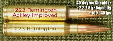

I believe the answer is the old .223 AI chamber for High Pressure ammo:
-.223 AI will not chamber in regular 5.56, preventing High Pressure ammo in regular rifle
- Legacy brass 5.56 can be fired from .223 AI chamber, so existing ammo can be fired
-.223 AI has more powder capacity for even more performance
Basically .223 AI to 5.56 would be akin to the .357 mag to .38sp relationship

The steep shoulder of the AI cases would likely cause reliability issues in any autoloading firearm.
With the significant increase in pressure it would be best to alter the gas system length and port size.
Would be easier to just change to a different cartridge.

I'm sure this "brass" is already niche enough without changing to an oddball chamber which would rule out 99% of the existing uppers, but I do agree that .224 Valkyrie, or even .222 Remington Magnum, might be a better choice than .223 Ackley Improved.

AR15's have already been chambered in .223 AI, and users report no ill effects in feeding:
https://forum.accurateshooter.com/threads/223ai-ar15.4059045/
"I have yet to have a single failure to feed, my bore count on the current build is 5532. The internet insists that Ackley cases don't feed from magazines, but it hasn't happened to me."
https://forum.accurateshooter.com/threads/223ai-in-an-ar-platform.3882975/
"After many thousands of rounds thru an AR, using the 223AI case in competition,I would say go for it. I don't recall having one feeding problem."
5.7x28 looks to have a comparably steep shoulder to my eye, feeds well.
I think the key to these rounds taking off is the ability to fire legacy brass cased ammo, hence the AI. Which I agree will probably need a adjustable gas system and other enhancements.
If you cant use cheap, common ammo out of the weapon then a high pressure round will do no better than all the other weird niche cartridges that have been tried from the AR15.
