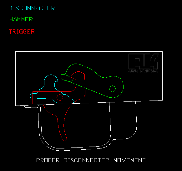

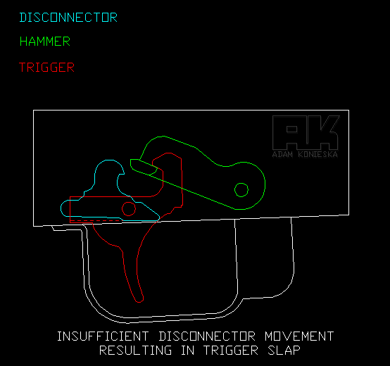

Here is an animation to clarify what trigger slap looks like.  Take note of where the disconnector is in relation to the rivet when trigger slap happens.
Watch the animation closely, trigger slap does not happen when the rifle is idle, it happens when the trigger is held to the rear.  While in this position, it is impossible for the disconnector to contact the rivet.
Bottom line:  trigger slap is caused when the disconnector does not have enough room to move when catching the hammer.  It is not related to the rivet.

http://www.adamkonieska.com/images/ak47-proper-disconnector-movement-animation.gif
http://www.adamkonieska.com/images/ak47-trigger-slap-animation.gif

Watching these videos of the FCG animation may clear things up.
https://www.youtube.com/watch?v=uZ9l1X1cdBc&feature=youtu.be&t=1m22s
https://youtu.be/Ad_4whlPGzU?t=23s
https://youtu.be/jasTr0EQjms?t=3m46s
Note the position of the disconnector while the trigger is pulled, its elevated, as as such its not able to contact the rivet.  The height of the rivet and a tail on the disconnector have nothing to do with preventing trigger slap.

Ak-, I'm not sure what you're trying to show in the second animation (very cool by the way).  The hammer hits the disconnector, camming it back.  The tail of the disconnector hite the rivet.  It does NOT push the trigger back forward as you show.
Now if you were to remove the (mauve?) rivet from the equation, then it would hit.
Thanks.  The animation is showing the failure of the disconnector to move through its full range of motion, causing trigger slap.
Like you said, ff the disconnector is not sized correctly, either too much material on the underside, improper hole depth, improper spring, etc, it'll cause the trigger to slap.

Quoted:Thanks.  The animation is showing the failure of the disconnector to move through its full range of motion, causing trigger slap.
It doesn't.  It  shows the the disconnector bottom out on the rivet head as it is supposed to.  Then the trigger magically slaps forward with nothing contacting it.
Watch it again closely, the disconnector does not move as it normally should, resulting in a malfuction.
Normally the hammer pushes the disconnector out of the way, the disconnector compresses its spring, and then catches the hammer.
When the disconnector cannot move, i.e. compress the spring and catch the hammer, it forces the trigger to rotate forward thereby allowing the hammer enough space to move past the disconnector.  This is what causes trigger slap.

Thats the point, its showing the malfunction (trigger slap) that happens when the disconnector cannot move enough to allow the hammer to pass by.
how is this happening?
It could happen for a number of reasons, disconnector spring worn or not installed, the disconnector hole is not drilled to the proper depth, the disconnector itself is incorrectly sized, etc.
The inability of the disconnector to move through its full range of motion is the cause of trigger slap.

You seem unwilling or unable to answer the simple question - but I'll try one more time.
How is the trigger in your animation moving forward?  The disconnector does not contact it.
6/24/2015 9:11:40 AM EDT
Trigger return spring or disconnector spring tension. The disc. isn't slapping it.
6/24/2015 9:27:52 AM EDT
Quoted:The disc. isn't slapping it.
'zactly
6/25/2015 1:00:13 AM EDT
Your question was already answered:
Quoted:It could happen for a number of reasons, disconnector spring worn or not installed, the disconnector hole is not drilled to the proper depth, the disconnector itself is incorrectly sized, etc.
You realize the disconnector spring is not shown in the drawing, right?  If the spring hole is not drilled to the proper depth and there is too much tension the disconnector may not move far enough.
Further, if the disconnector is not properly sized it can cause the same issues because its not able to travel far enough to allow the hammer to pass, as shown here:
6/25/2015 8:45:03 AM EDT
Quoted:Your question was already answered:
No, you did not answer the question.  You continue to dodge it.   Your animation does not demonstrate the mechanism of trigger slap in an Arsenal FCG.  Because what you "drew" doesn't actually happen.  You can't wish it into existence.
Yes (as I stated earlier), a grossly defective trigger/disconnector casting (that could somehow still be assembled),   could theoretically cause contact.   I've installed  over a thousand sets and never seen such a grossly deformed Arsenal.  In fact, they are quite uniform.  Which I guess makes sense, as molds do not typically expand to allow more metal to be poured in.
Drawing a picture of a modification to a Century disconnector does not explain trigger slap in an Arsenal.
Yes, an oversize spring  "going solid"  would function the same as an oversize disconnector.  Basically disabling the rocking  motion.  Good luck in installing such a thing. Possible, perhaps.  But the fact remains that your animation is something you made up, and does not depict an actual event.
I don't believe the OP is accurately describing his mechanical system. He's missing something, somewhere.  This makes diagnosis difficult.    The event he describes does not make sense, because it physically cannot happen within the parameters he described.
You drew an animation of a system other than that which he described, to illustrate an even that can not occur as drawn.  The only way to make it occur is to imagine defective geometry in the parts or the spring - neither of which is represented.
So while I'm jealous of your  animation, and would like to utilize something similar in the classes I teach to forensic firearm examiners (so much cooler than my Power Points), it does not depict an actual event.
6/25/2015 12:00:17 PM EDT
The question was answered, please re-read the post if you are unlcear.
Here are some updated animations, one including a spring hole that is too short, and a second showing a disconnector that has too much material on the bottom.
If the disconnector is not sized correctly, as in this photo, the animation shows the malfunction that will occur:
If the spring well is not drilled to the proper depth in the disconnector, this animation shows the malfunction that occurs:
Failure of the disconnector to move through its full range of motion is the cause of trigger slap.
6/25/2015 12:49:25 PM EDT
Now you're finally understanding - good, we've had some progress!
Now what evidence is there that either of these two theoretical possibilities is actually happening in the Arsenal fire control group the OP Is using?
Of the two, the spring pocket of insufficient depth or incorrect (too long) disconnector spring going solid, are the only ones that make sense.  I'm not seeing why Arsenal would make a different mold, that was oversize, just for certain people, so lacking evidence to the contrary, I think we can rule out oversize disconnector for the Arsenal.  TAPCO, they are far more likely to have an incorrect  pocket depth, and actually had a recvall for them being too deep on some.  I've had others that were not drilled at all.
Failure of the disconnector to move through its full range of motion is one possible cause of trigger slap.
Fixed it for you.
