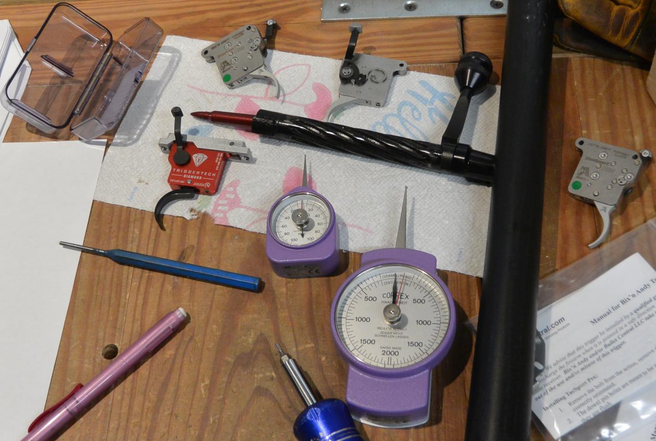

Trigger testing gauges supplies and triggers laid out
As part of this review and others I did a great deal of pull weight variance testing using some very precise and pricey Correx gauges. I found the pull-to-pull break weight variance on the TriggerTech Primary right in line with conventional technology aftermarket triggers, whereas the Diamond was significantly better than average. Significantly, most of the conventional tech triggers had the advantage of being lubed. This is an advantage in indoor benchtop testing that is decidedly a disadvantage in a dusty field environment.
