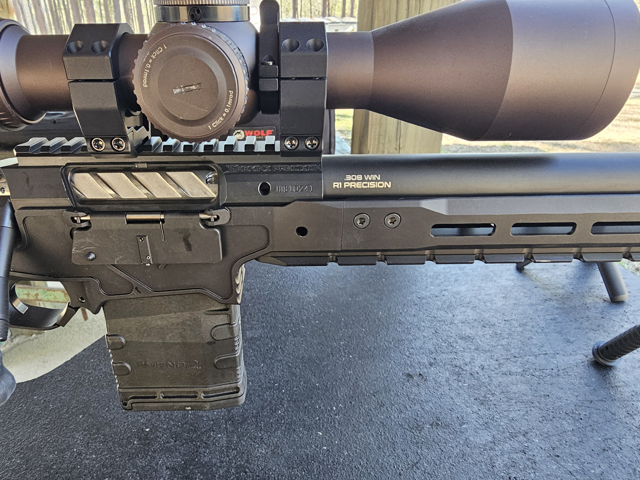

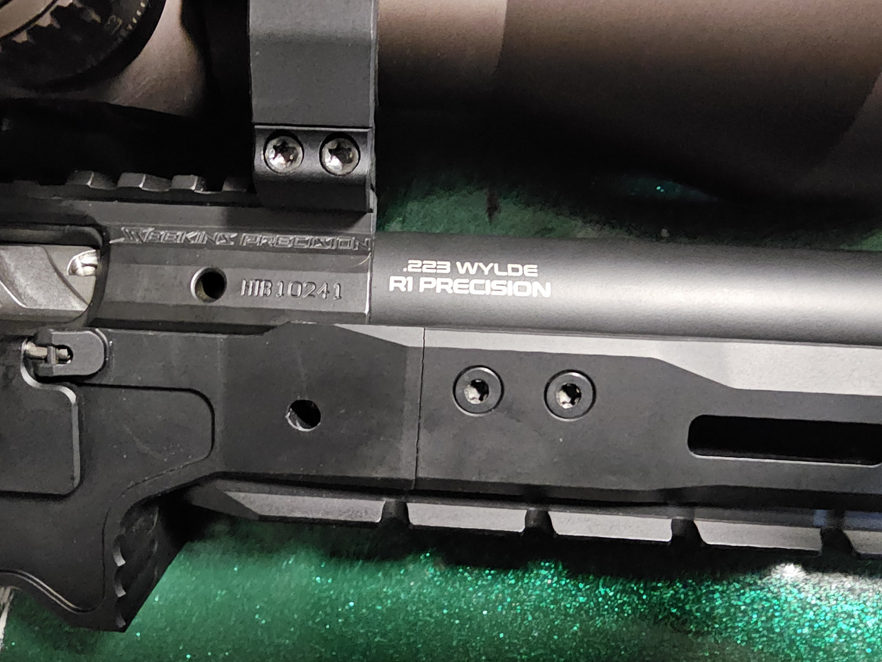

If you kept the rifle I wanted to show the barrels R1 precision did for my M3.  They are perfect and can do them for previous versions.
2/10/2026 9:35:23 PM EDT
That’s good to know. Thanks for the information.
