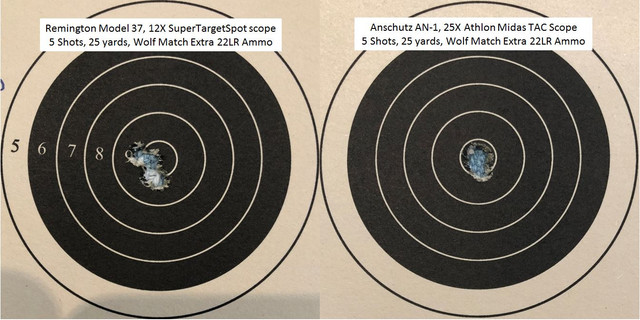

Skip the chrono and put the rounds onto a target.  I was shooting Wolf Match Extra today.  Yeah, it was worth the small cost increase.

[Last Edit: Trollslayer][Edited] [#9]
I'm hoping this does not stray too far off topic.  I just want to reinforce the idea of shooting decent ammo, although Wolf ME is double the cost.
As I drove home, this was bugging me.  I'm not sure if it was me or the lower power scope that caused the difference in the pictures, above.  I kept forgetting to reset the old, vintage scope (pull it to the rear after firing), so maybe that explains the two different vertical groups.  Also, it is lower power.  Still, it's not bad for a nearly 100 year old rifle and scope that have both seen some serious use over the years.
Oh well, in the end, it was a long-overdue, fun day of shooting.

That compares to Wolf ME which was about 0.35" to 0.5" as shown in the photo above.
