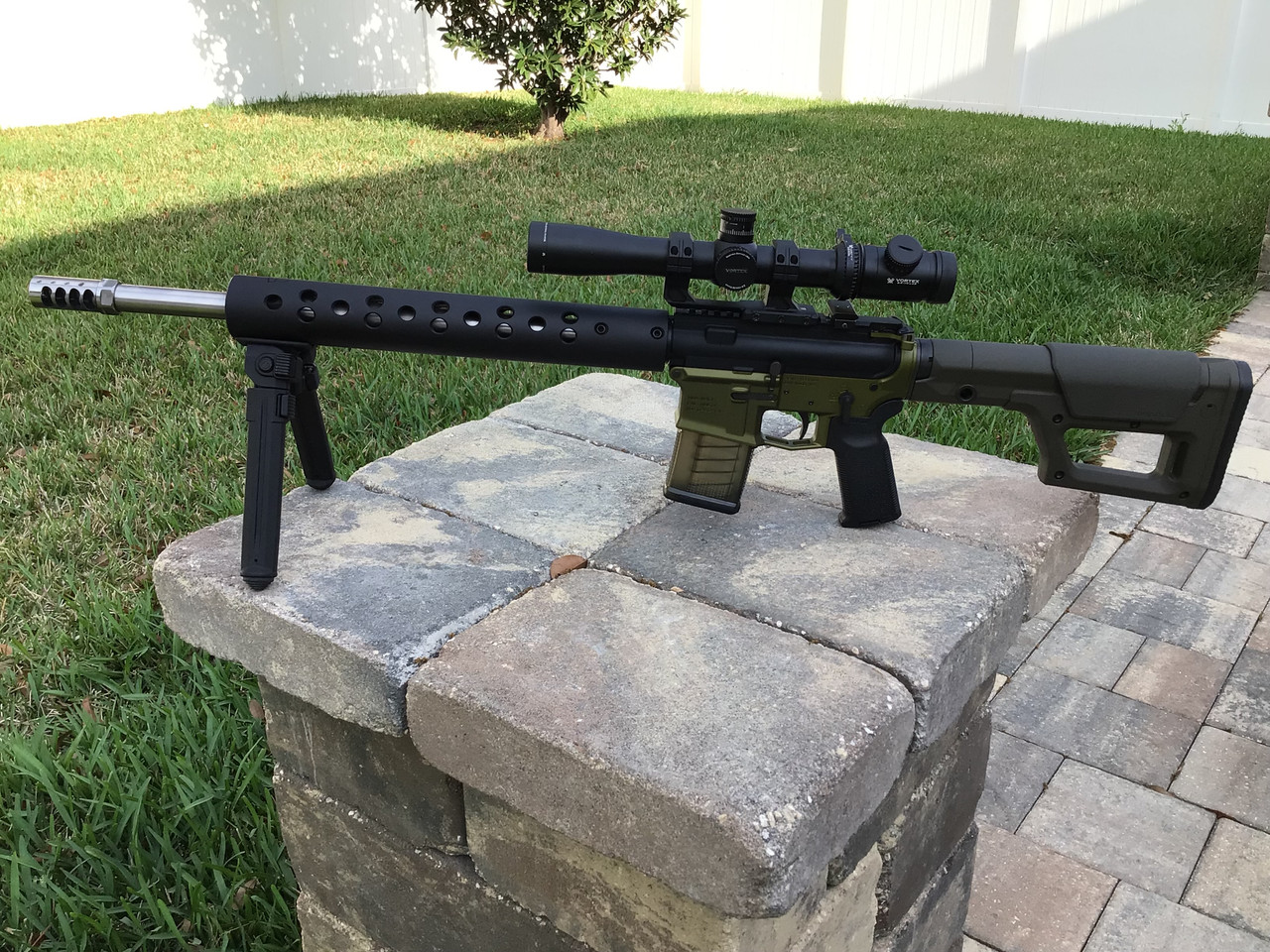

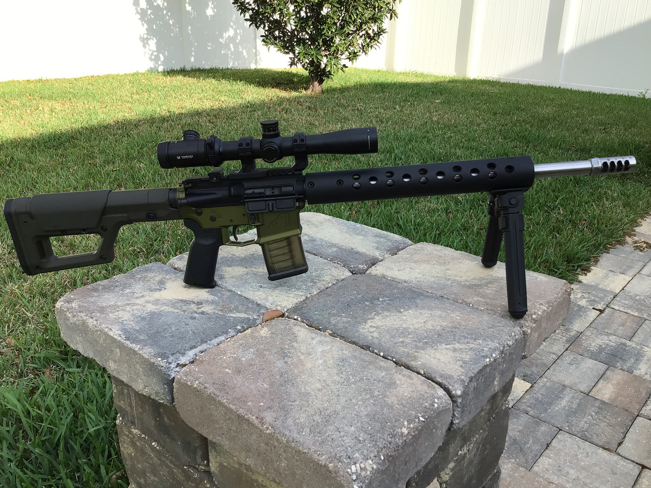

I'll be up front and say I'm not a great shooter.
I built an SPR style AR rifle with 18" White Oak Armament SPR 1/7 barrel.  I'm using a Vortex Diamondback Tactical scope and a Geissele SSA-E trigger.  I've been reloading my own ammo, the pictures shown are shot with the following.
Brass: LC
Primer: CCI
Bullet: 69gr Sierra TMK
Powder: Ramshot TAC 24.5gr
Shooting was done from a bench on bipod with rear squeeze bag.
My question is this.  Should I be happy with these groups knowing that I have some work to do on my technique?  I feel that at this point my equipment and ammo is decent but it's the shooter that needs work.  I'm curious to get the thoughts of accomplished shooters.

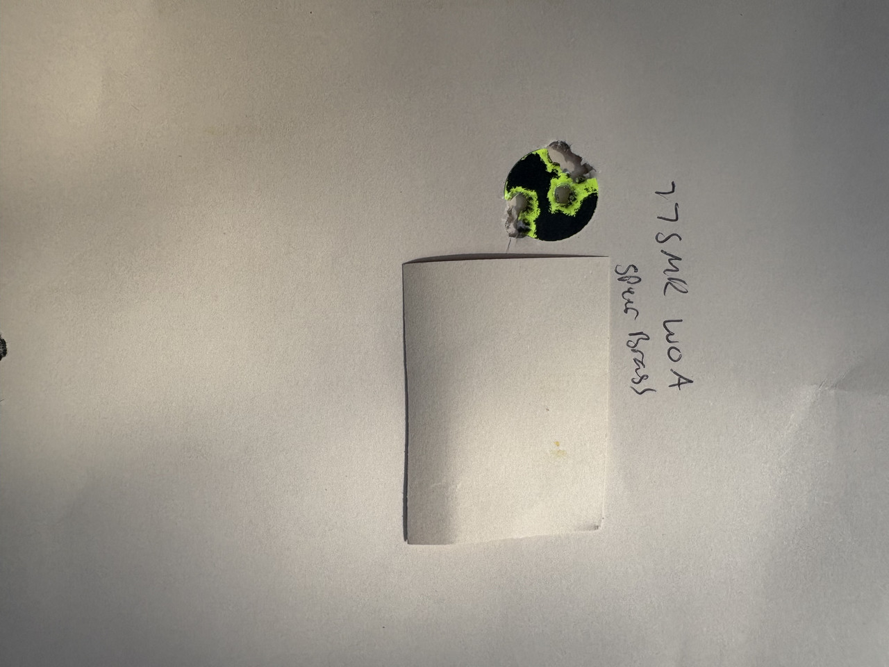

I would definitely not be happy with those groups. This is a WOA upper with 1/7 18” barrel. With 77gr SMK and  23.5gr Varget loaded to 2.26 . I’m getting nice tight groups at 100 and 6” plates at 600 are pretty easy.
10 shots 100yds
10 shots 100yds

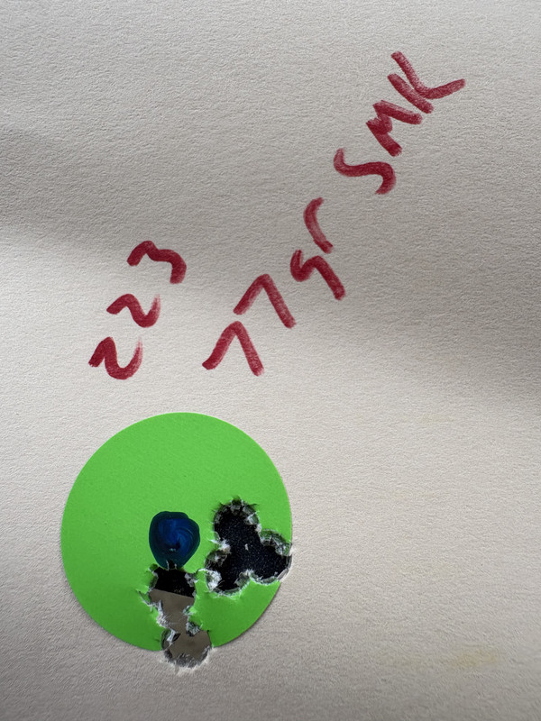

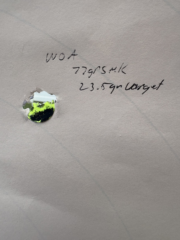

All my WOA barrels will shoot .75 5 shot groups with handloads.  I have had two that would shoot .5 or better.  I shoot with a accutac bipod and rear bag.  So I would keep practice and see if you can shrink those groups down.
I shoot 77gr match kings with 24gr of varget or 23.5gr of 8208.  It took about 200 rounds for one of my barrels to settle down and really start shooting well.
