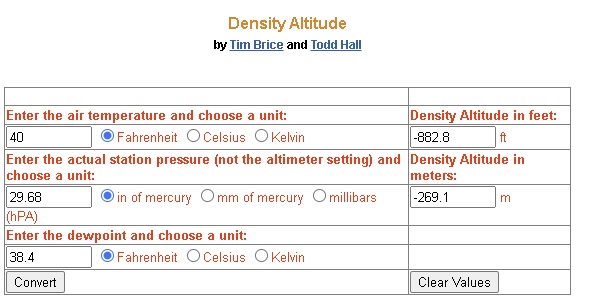

So I checked your weather and everything is working correctly. Density Altitude can be a negative number. Here is a link to a calculator for you: FAA Density Altitude Calculator. Since you will need dewpoint here is another one for you: Dew Point Calculator
Here is some more information that should help explain what Density Altitude is: FAA Density Altitude Educational Information
Keeping in mind the app actually has decimal place information there that isn't visible it coincides quite well with the calculator:
I checked the bullet library, and the app. I also briefly looked for anomalies in your profile/logs from your email. The app did not provide you a G7 BC of 1.000. The app provided you a G7 BC of 0.293 after you selected Ammo ID 1655 Norma 0.264 140gr FMJBT.
I am reviewing your email now, and we will get back to you after we check the data from the logs. However the app does not automatically change the weather. In order for the weather to update, the user must press one of the buttons under each input they wish to update.
2/14/2025 4:11:50 PM EDT
https://i.postimg.cc/g2SZvr5N/Untitled-DA.jpg
