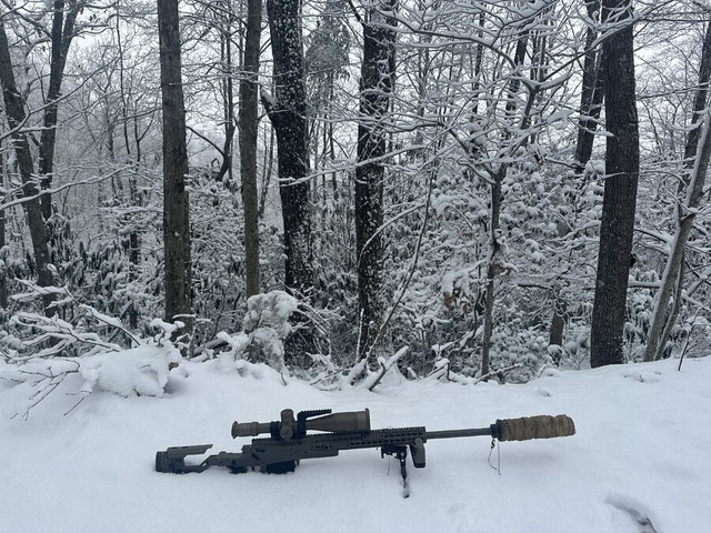

12/14/2025 9:16:19 PM EDT
[Last Edit: taliv][Edited] [#12]
Originally Posted By bigbore:
IMO, the AI isn't anywhere near worth the cost over the MRAD.
What I like about the MRAD:
10rd double stack double feed mags.   You can top load with the mag in still in the rifle, great option in the dark.
MLOK rails, not the proprietary attachment system on the AI
New barrels come with new bolt heads.
Barrel swaps for me have never been more than .2 off from return to zero.
You can get parts everywhere
https://www.ar15.com/media/mediaFiles/12678/20250310_124517-3487900.jpg
Those are great features.  Not sure if you meant to imply they’re not found on the AI, but for clarity the AI also uses double stack/feed mags and I single feed mine by hand with mag inserted all the time.  And barrel and bolt swaps are quick and consistent like mrad.
I think the AXSR is worth the price.  However, it’s not great camo in the snow!
OP, if you are serious and plan to shoot 2k often, and like the AI platform, my recommendations in order of preference would be:
1 step up to the AI ELR 50bmg, then swap barrel out to one of the ELR cartridges. 375 or 475 somethings.  That’s going to be a lot more $ but you’ll prob hit more.  2000yd is a hike.
2 custom 338-based or 300nm based ELR cartridge, impact action, foundation stock (pm me for info on smiths)
3 AXSR in 300nm.  Then when you burn that barrel out, replace it with a 338lm-based ELR cartridge (same bolt head as 300nm so all you’d change are the magazines)
4 AXSR in 300prc
5 MRAD in whatever
ETA: check out the mag range others are using before you buy that 8-40.   FOV at 40x is tight.
