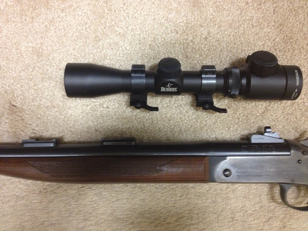

Same thing here.  I have a Buffalo Classic shooting 405 grain coated Missouri Bullet Company #1 hard cast bullets.
I settled on RL-7 powder.  It is quite versatile and can be used with trapdoor pressure level all the way to near African big game loads.  This is a very strong action.
36-38 grains with that bullet will replicate original blackpowder loads.   Fun to shoot.  About 1300 fps.
You can go as high as 51 grains in the Buffalo Classic with no pressure signs, and as listed in the current Lyman Manual.  It chronos from our long barrels at 2100 fps!  That is 4,000 ft/lbs of energy.  It is has bruising recoil, however.
I drilled and tapped the barrel for scout scope mounting so I could keep the Williams receiver sight.  The scope rings and mount are Talley steel precision machined quick detachable lever operated return to zero design.  When I want to use the target sights the scope comes off and will return to zero well within one MOA.  The scope is a Burris 2-7x35 illuminated duplex handgun scope.
