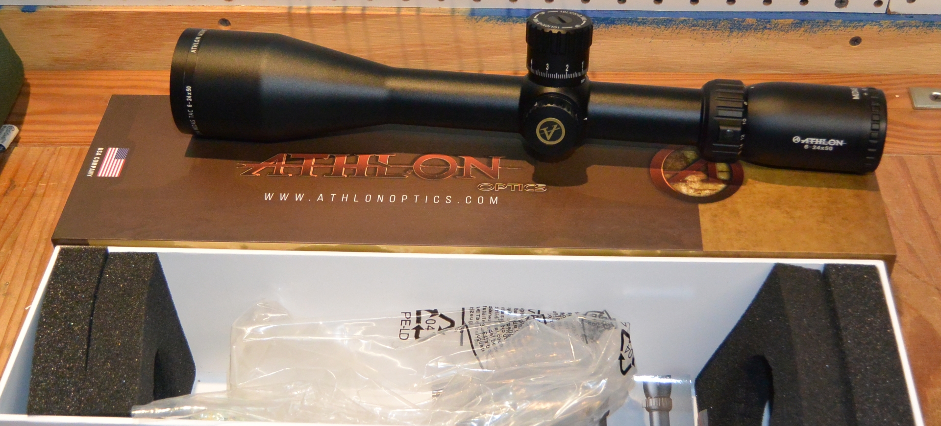

I have continued working with the scope companies on the sub $1k long range optics reviews later this year. The Athlon Midas TAC 6-24x50mm with APRS2 FFP Mil arrived not long ago. Yet to arrive are an Athlon Ares BTR 4.5-27x50 FFP IR Mil as well as a Nikon BLACK FX1000 6-24x50 MRAD. These and the previously mentioned Sightron SIIISS624X50LRFFP/MH are what I currently expect to make up this series of reviews in the fall. You will see the scopes from time to time before that as I'll be using them some on the rifle reviews.
Athlon Midas TAC 6-24x50mm just out of the box.

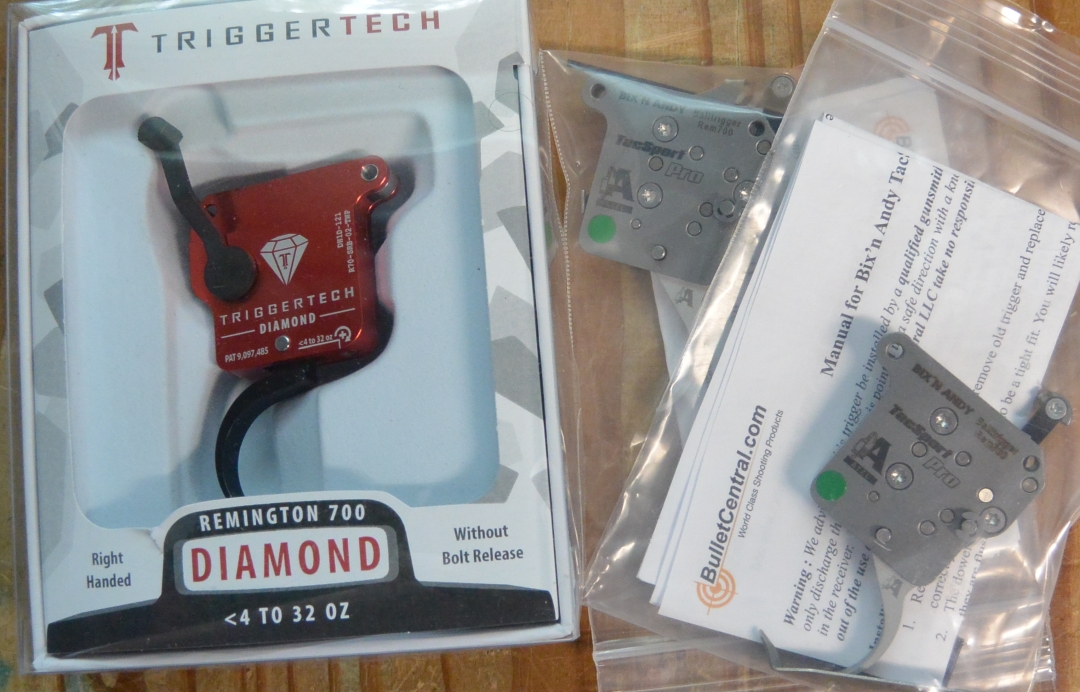

While playing with the Bix N Andy trigger in the Kelbly build I have found myself running down the rabbit hole regarding trigger design and theory. Their concept of using ball bearings to take the bulk of the down force from the topsear is very interesting and my testing is indicating that it works very well. The writing about this is now somewhere between a subsection and it's own review in length so I am not exactly sure where I am going to end up on that. For now I will tease you with a well labeled picture of the operating mechanism so that you can take a gander at the concept as well as the quality of the machining.
Bix N Andy Tacsport pro prototype labeled for clarification.

In scope news, I just recieved the Athlon Ares BTR yesterday. I will probably get to working some with that this weekend. I have done some mechanical and optical work on the Athlon Midas Tac now that I received my test target back from the laminators. The Midas reticle is spot on in size and the adjustments are also tracking right on. There is really nothing else you can say about that. No further news on the Nikon Black. Hopefully, it will get here by the end of this set of reviews.

Over the last couple of weeks I have received the last few test samples for this years reviews.
As many of you know, during the process of reviewing the Kelbly's Atlas custom rifle and Mesa Precision Arms Crux custom rifle, I got a little sidetracked on the triggers. Each of these rifle makers uses, as it's preferred trigger, a unit featuring an new and unconventional technology. Kelbly's uses Bix'n Andy ball triggers that have balls to decrease force on the key pivot points. Mesa Precision Arms uses TriggerTech triggers which, in addition to a few other changes, interpose a roller between the sear surfaces to reduce friction. Though I was initially skeptical of both innovations, I have found that both perform in accordance with their manufacturers claims. It is probably not surprising then that these two brands have been growing quickly in popularity in the shooting sports. Even to the point that each is beginning to look pretty dominant in at least one discipline.
Last week, I received the last test samples from each trigger maker. This consists of a few Tacsport Pro production units from Bix'n Andy and a TriggerTech Diamond. I will be finishing up the testing on these and should have a Bix'n Andy review next week as well as some updates to the TriggerTech section of the Mesa Precision Arms rifle review. This will involve further testing of pull to pull variation as well as looking at topsear force.
TriggerTech Diamond and Bix'n Andy Tacsport Pro's arrive for some testing.
On the optics side of things, it looks like the 3 scopes I have in so far for the sub $1k precision optics series this year will be all for the year. The Nikon black will probably have to wait for next year as the testing on the others is half done, there are not many sunny months left, and Nikon is still backordered on the scopes.
As for the three scopes I have:
they are looking better than I expected. Optically, they are all performing better than I expected at the price point. These three, together with the two legacy comparisons I have (Zeiss conquest 4.5-14x and Leupold Mk 6 3-18x), are closer in optical performance than any other large group of scopes I have ever compared to each other. Their mechanicals have also been solid so far with the Midas actually being indistinguishable from perfect in the tracking. I am really pleased that this much performance can now be had for a pretty moderate price. I expect that the first of these reviews should be done and up in a month and a half or so.
Optical comparison testing for the sub $1k ffp mil/mil precision optics series.
