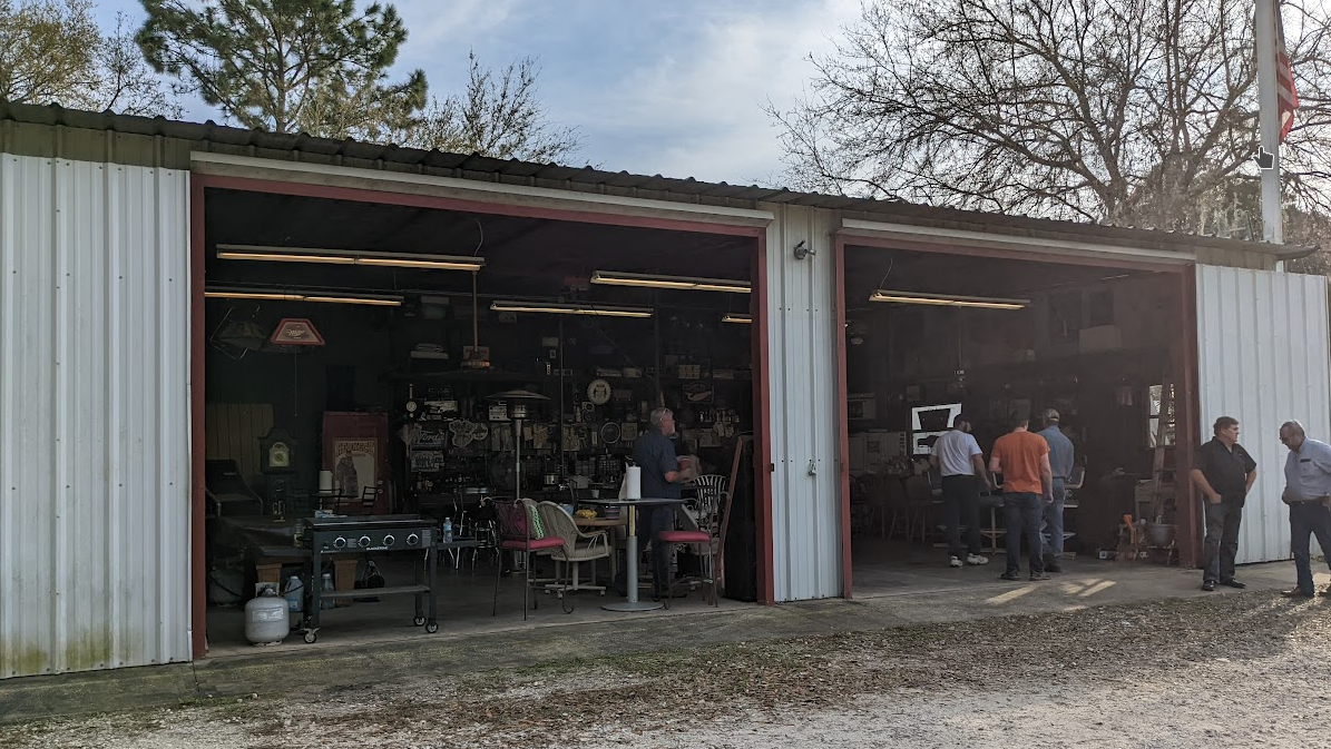

Lol @ something with more sqft than most peoples' houses being called a "shed".
I have roll up doors on mine.  12' post spacing, so 10' doors.  Most cars are like 6-7' wide.
On my grandpa's "shed", he had huge folding doors.  You just pulled a pin out of the ground and one door swung to each side, and folded.  It was like those bi-fold closet doors, except yuuuuuuge.  That gave him the ability to essentially open up a hole in the side of his "shed" from floor to ceiling.  Opening the door was faster and easier than a roll up.  It did not require an extra 2ft of space above the door that a roll-up requires.  They are pretty wide, too.  Much wider than your average roll up.
https://iili.io/C20sssf.png
Ohhhh!  I've never seen those shop foldies!  That's awesome!  Makes me think of the folding glass patio doors some of my customers have on their homes.
@giantpune
Are the doors in the picture sliding or folding?
I have one older outbuilding that has a sliding door and it is a pita.

[Last Edit: giantpune][Edited] [#18]
Originally Posted By Deuskid:
@giantpune
The ones in this photo fold.  Each of the bigass holes is covered by 2 panels that hinge together.  I dont recall if the top of the door rode in a track like in a closet door or not.
Thanks @giantpune
I don't think that design will work for my build as I'll have 3 big doors and couldn't open all of them without one obstructing another.
