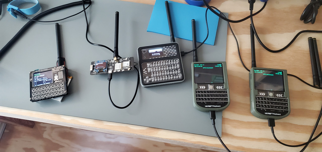

I have a pile of different Meshtastic radios, however I've found them all to be fairly unreliable.  Using 3 different brands I've had hardware failures and software failures.  At this point, it's nothing but a toy.

Yes, I was super hopeful that they would be better and for the most part they've had less problems than some of the others.  I have two of them sitting on my desk, one up on the roof and one in my truck.  They regularly completely forget their settings and I have to reconfigure them.  It's annoying, I was hopeful this would all be something pretty cool.

This is a disappointing thread to have found.  I got excited about the technology and bought a Heltec V3.  Despite various online maps and forums showing dozens of active nodes in my area, I have found precisely zero, including several hours-long drives around town where other nodes were specifically listed to be present.
I'm wondering if I'm doing something wrong as far as configuration goes.  I've looked at all the online guides and youtube videos about common misconfigurations, and as near as I can tell I'm good.  I have a second one on order just to see if I can get them to see each other.

No issues with my devices, and I prefer standalone units with their own keyboards vs needing a BT device to interact.  W/o an elevated node, LOS becomes more important between users.  ~900MHz does give good range though.

No voice. LoRa is a very low bit-rate and isn't suitable for much more than very small data messages (text, position, etc).
I've done some LoRa development just to learn. There are a pile of encoding options designed for different ranges and speeds, and some of the supported data rates are measured in bits-per-second. Not kilobits, megabits, or gigabits...just bits...
The highest data rate is something like 20 Kbps, and only at extremely short ranges. Still not suitable for voice.
My metropolitan area has a pretty good mesh (~200 nodes and a few relays in very good places). But I lost access to it with my last move, which was only 2 miles. I can occasionally see a few nodes, and I get no acks when I send test transmissions, and this is with a really nice antenna. It's so dependent on having line-of-sight that in some places it just doesn't work. I want to get a Yagi and point it at the city and see if that helps me re-join, but I don't have high hopes.

I ordered some different hardware and have been playing with Meshtastic the last few days.
...  i think it's a pretty good solution for a very low power and reasonable distance "maintain contact with my vehicle" when in the outdoors.  I'll prob keep a node configured in my vehicle as well as a couple to hand out as "trackers" for guests (lollollol yea right) who might be along.
One thing i wasn't expecting.  The firmware is very much "these are the features you get."  Not arduino-ish "here is the basic framework now you can build on top of it."
With meshtastic you can configure each node in a variety of roles.  "detection sensor" for example allows you to configure a GPI pins on the board as on/off there was some state change on this sensor so notify the network" type of function.  Meshtastic firmware is already configured to work with serveral breakout boards for reading things like temperature, humidity, etc and then passing it along.
Don't expect to be building your arduino sketches using the Arduino IDE.  Meshtastic is built with PlatformIO which is far more powerful but more complex to use than Arduino IDE.  I didn't know it was a thing until playing with Meshtastic.  If you want to do your own custom things directly on your Arduinoesque meshtastic board you'll be forking the Meshtastic github and building your own non-supported version using PlatformIO.
For example; Meshtastic firmware has a built-in ability to be a gate sensor via a digital (on/off) pin.  But not a gate controller.  And adding the logic to it much less a remote-control ability will require some exporation into programming with the casual Arduino hobbyist may not have dealt with before.  At least i hadn't / haven't.
What you can do is put another Arduino right next to the Meshtastic node and then run your Arduino IDE sketches there, communicating with the Meshtastic node over two wire serial to handle the radio messaging part. Which frankly - may be a better way to do things than otherwise.
Mine all seem to reliably communicate with each other - when in a fairly short range here in the piney forest of North Carolina.
Meshtastic has an in-built way to gate RF messages over the net using MQTT.  You can think of this as analagous to an Amateur Radio operator igating where Node : mqtt :: Amateur iGate : APRS.fi.  If i configure a meshtastic node to gate to MQTT I get US-wide nodes and messages, but only on that node.  It doesn't appear to repeat over the local RF despite being set to do so.  But it's possible i have something misconfigured elsewhere.  Possibly in the channel details.
All in all it's a fairly inexpensive way to spend a couple days learning about something new.  Utility of it... you'll have to decide for yourself.
With not a lot of money you can get decent range, encrypted communications.  Which gives it a leg up over Amateur for local non-voice info sharing type nets, in my opinion.
