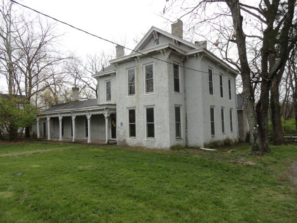

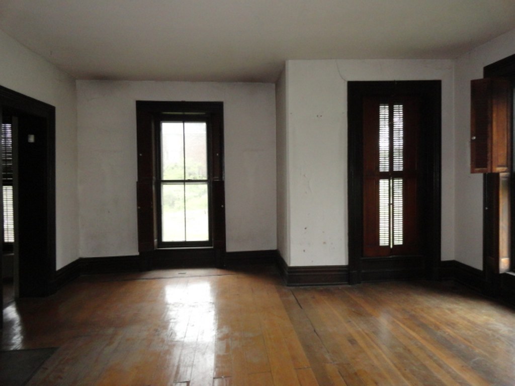

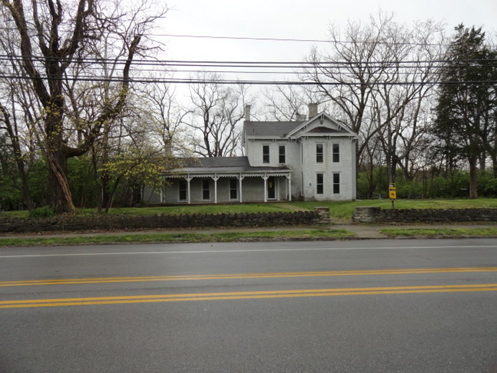

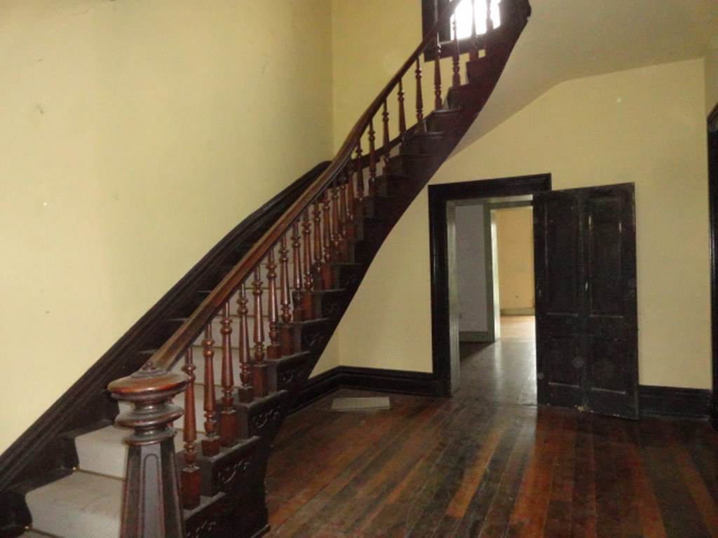

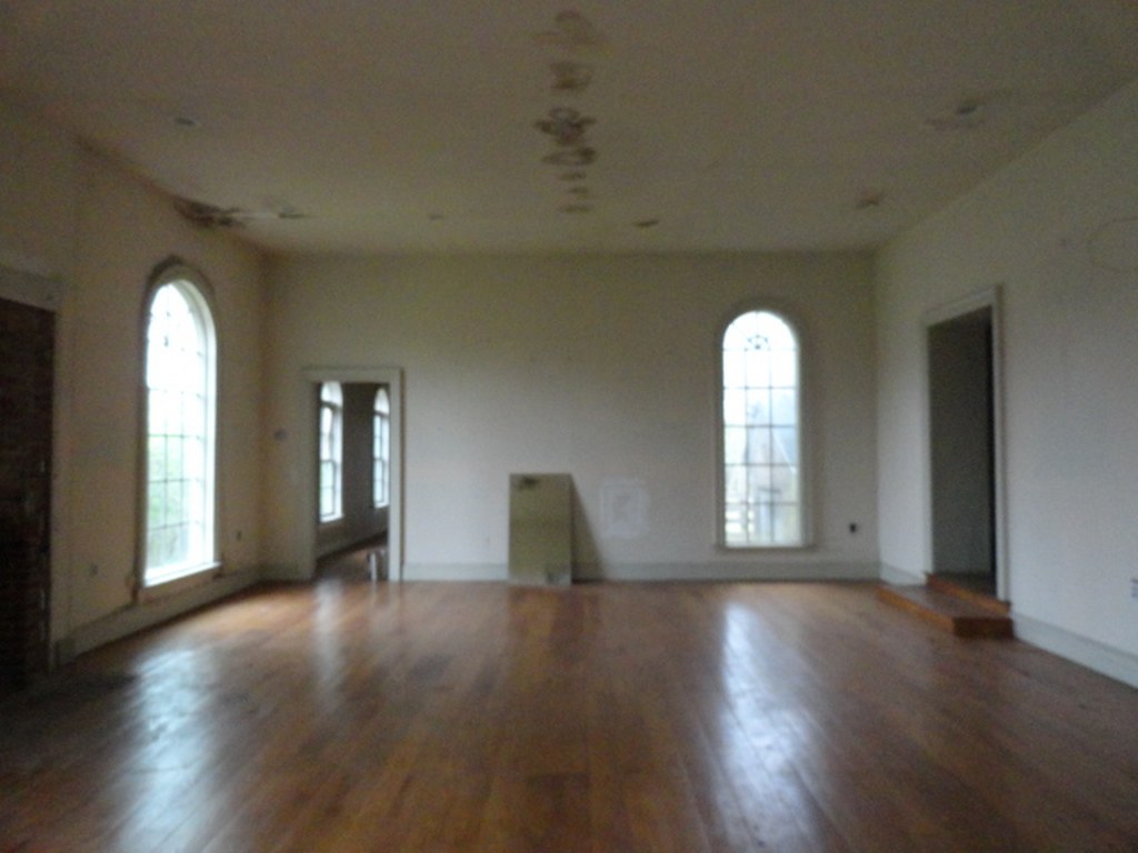

Present Day Pre-Auction Pictures April 2016

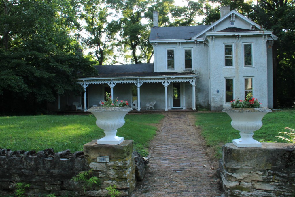

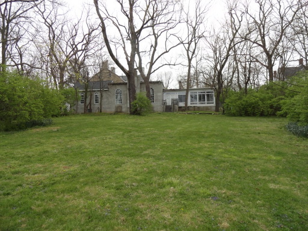

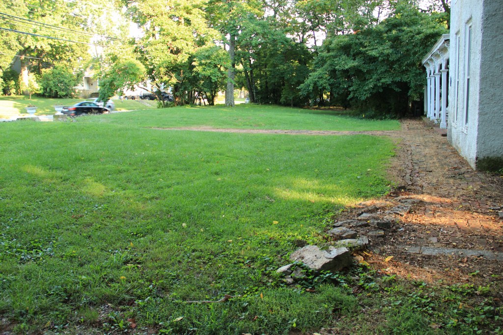

Present Day Post Auction

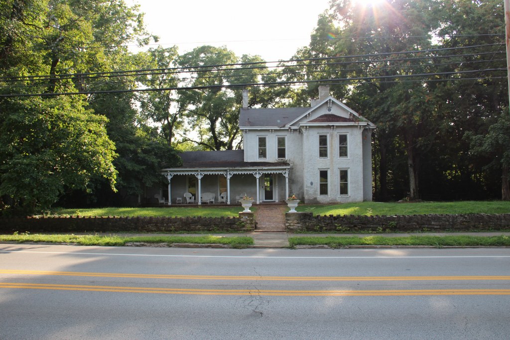

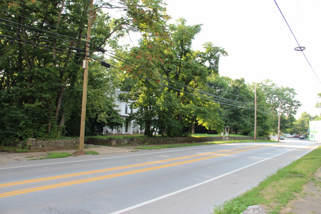

Front looking north

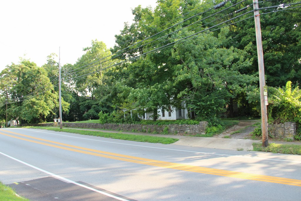

Front looking south

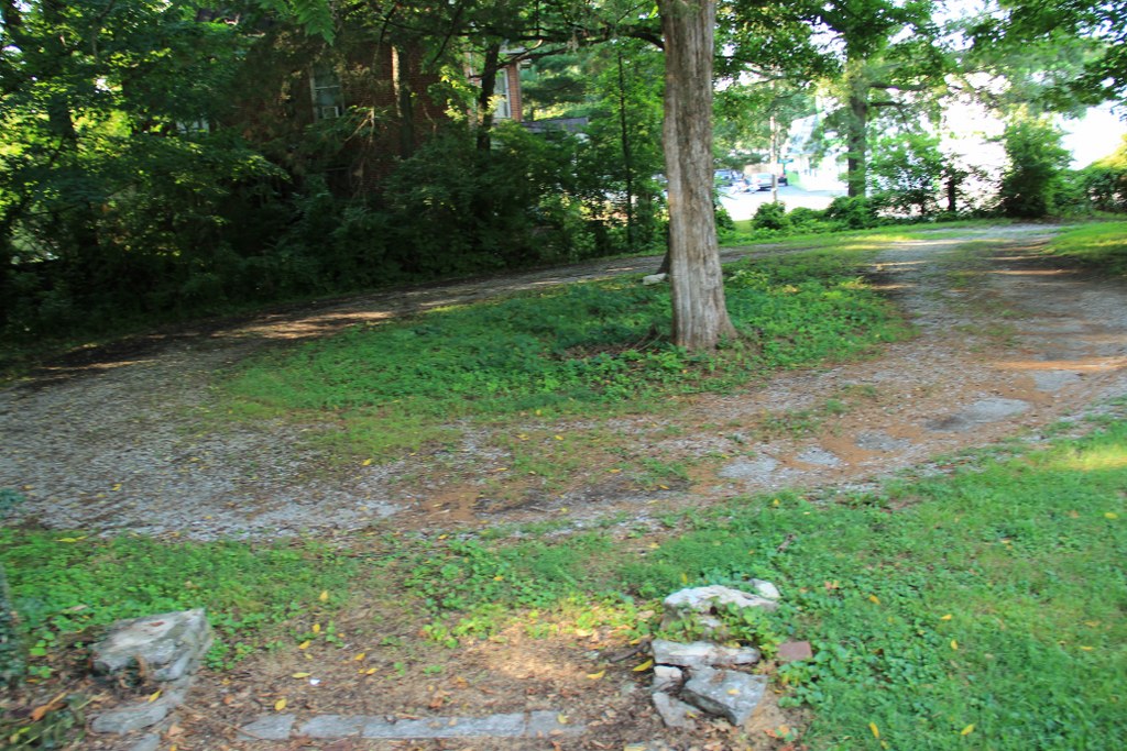

Circle drive on the north end

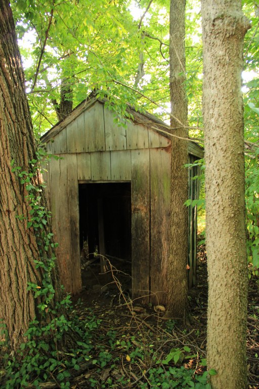

Chicken Coop (estimated at 80 years old)

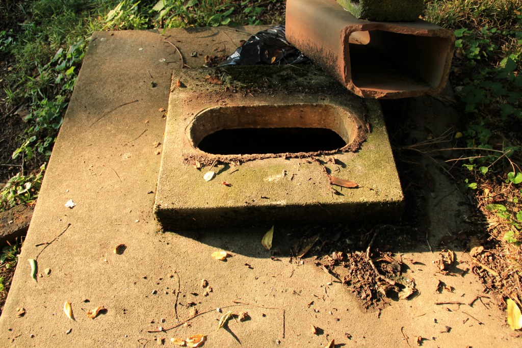

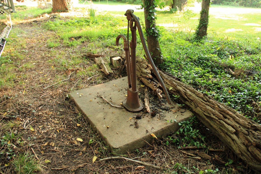

Well Pump (rusted and didn't work)

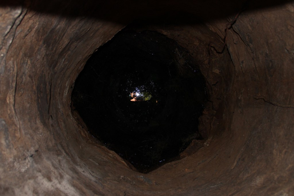

Cistern carved into the bedroock.

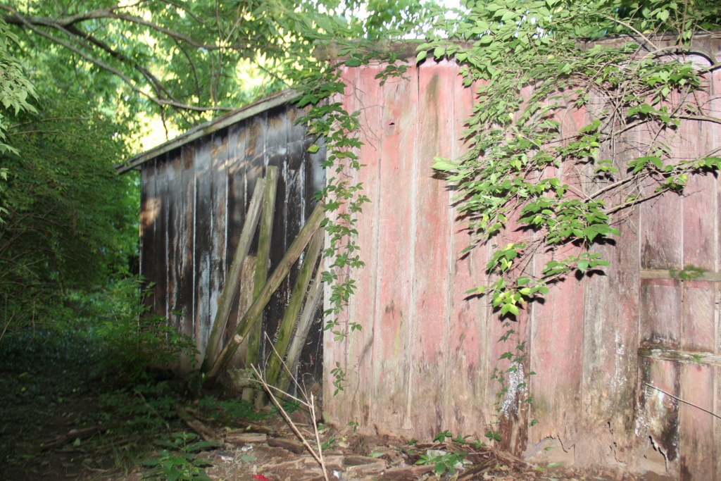

Shed.  Even the shed has an addition to it.

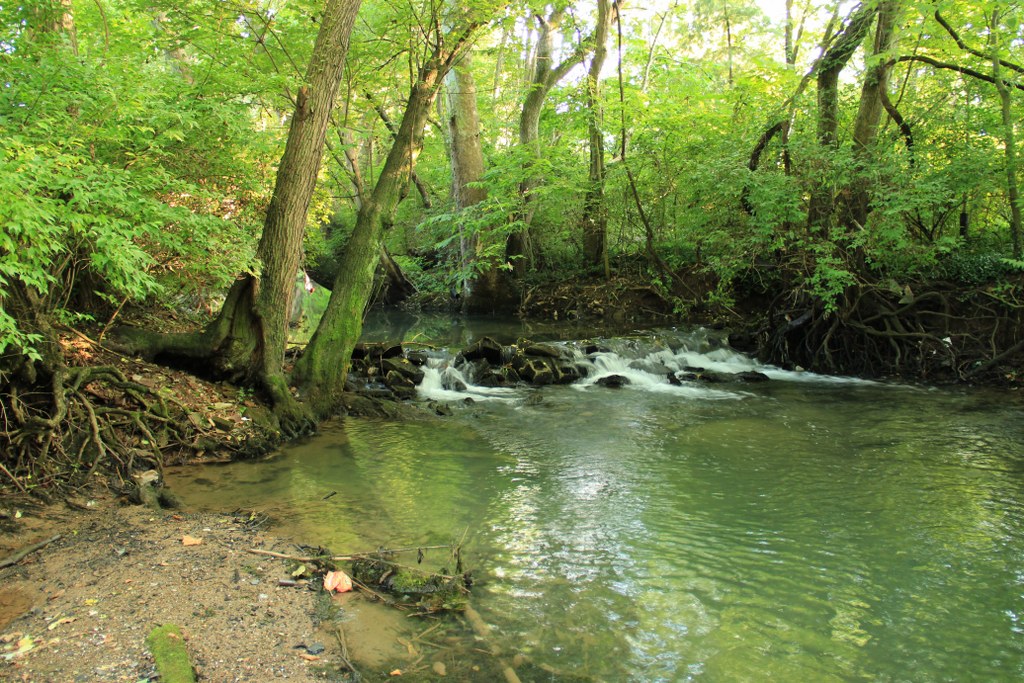

Creek view
A man-made waterfall in the creek

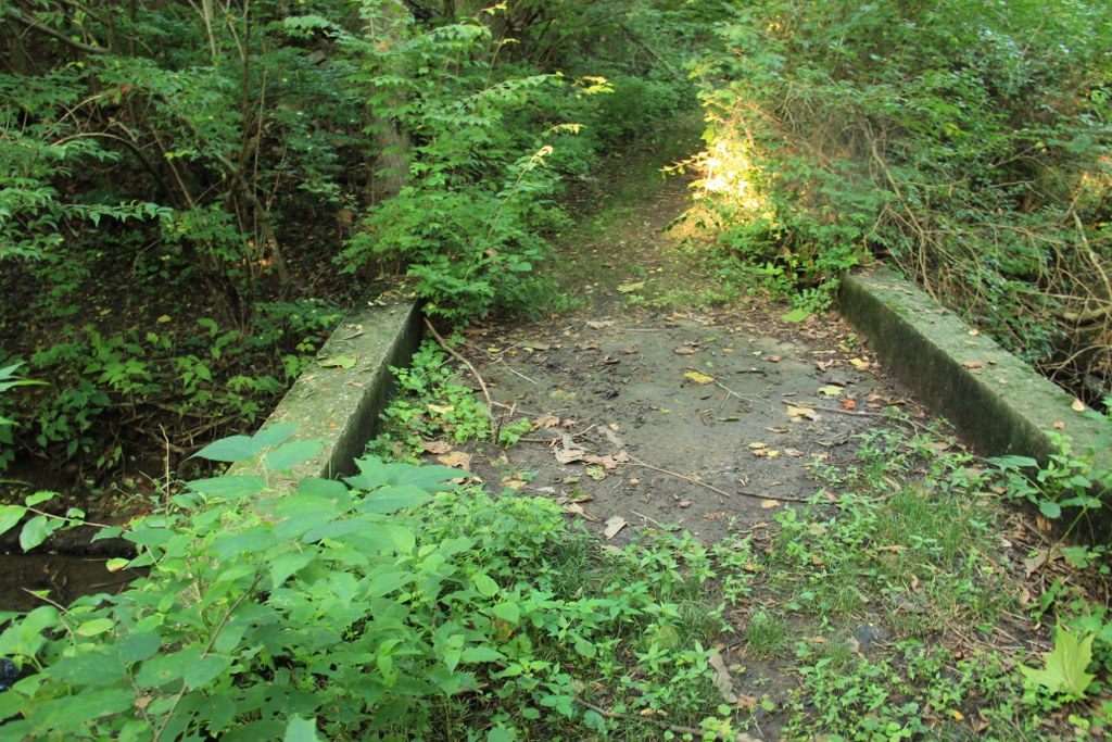

Concrete Bridge on limestone rocks

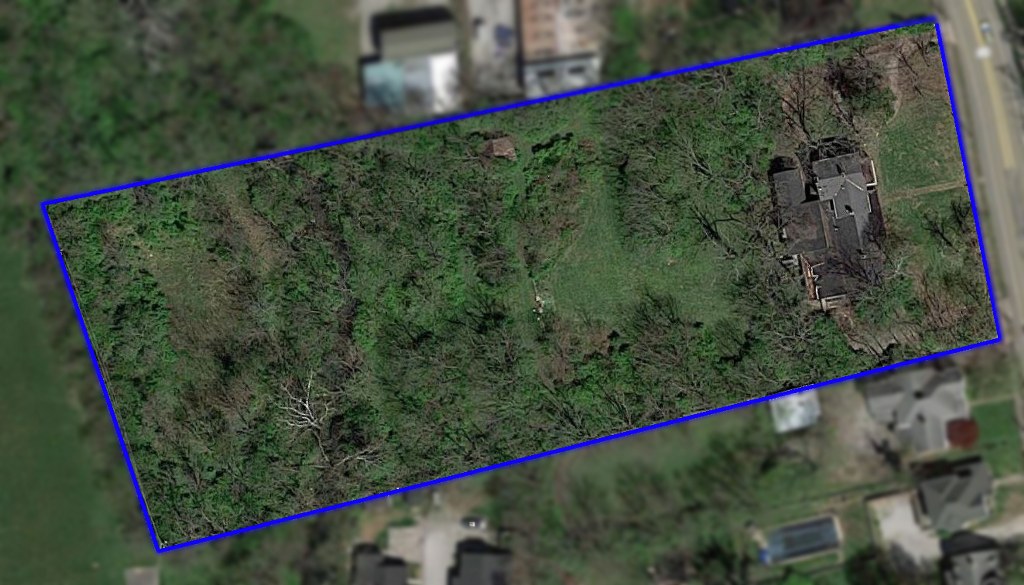

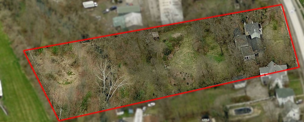

Aerial View from 2006
Aerial View early 2016.  You can see how the grounds were let go.

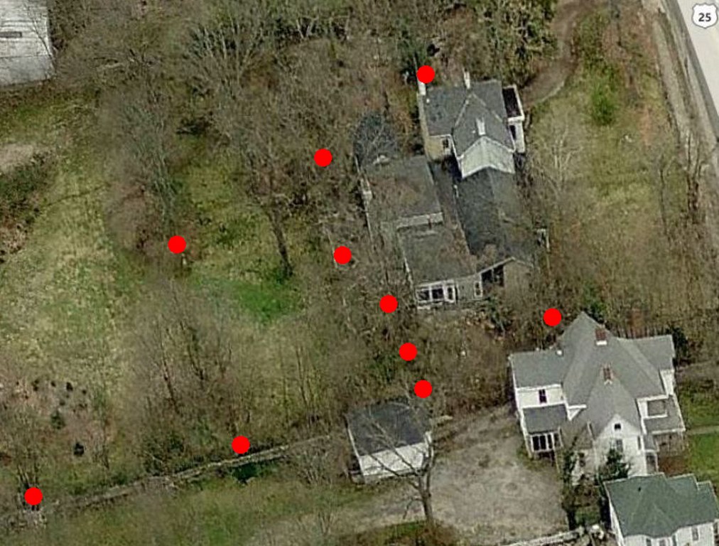

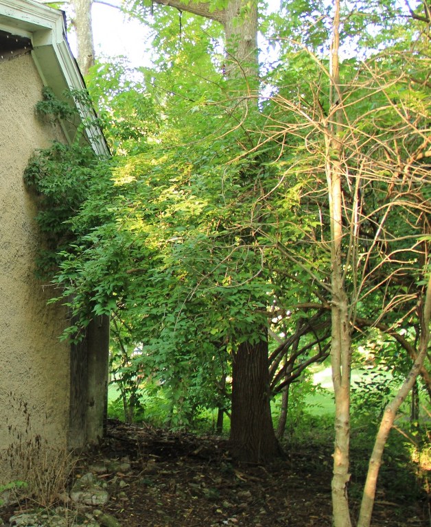

Black Walnut Trees.  There are more than I indicated but pretty accurate around the house.

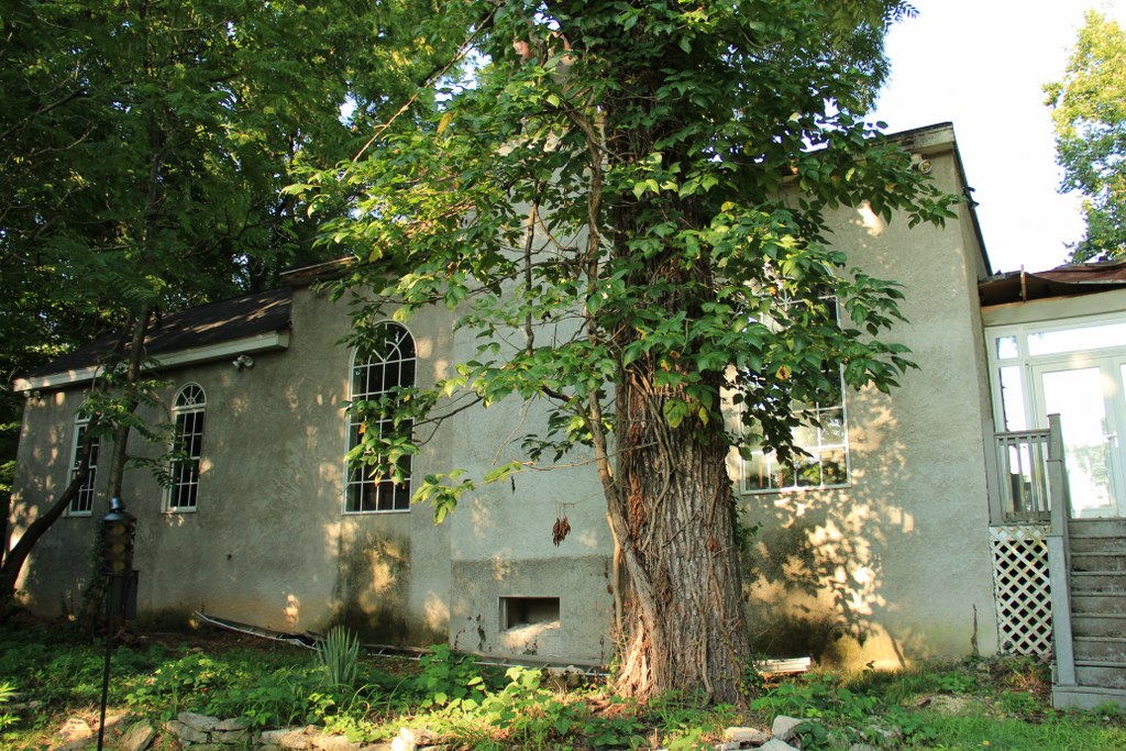

Several of the walnut trees are very close to the house.  This one is the closest.  It drops walnuts and leaves on the house and vehicles all summer long.
Poison Ivy Tree
Poison Ivy Everywhere

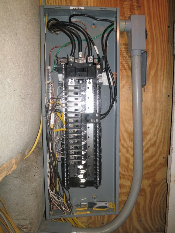

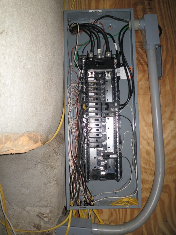

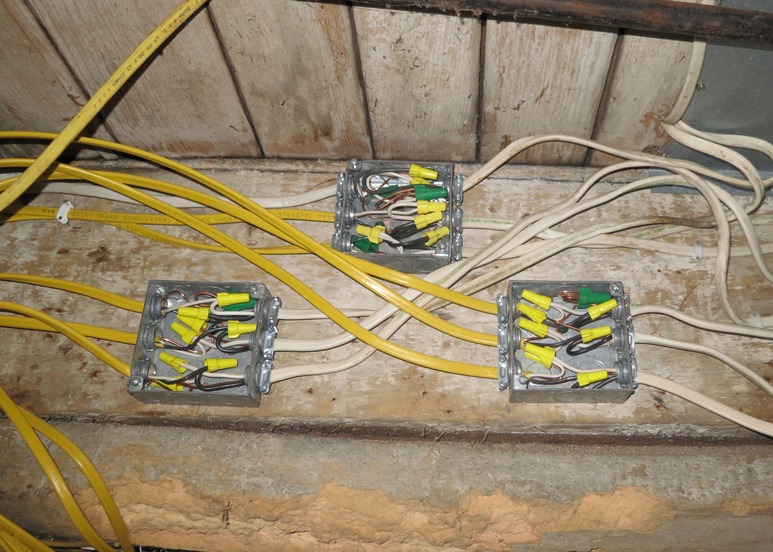

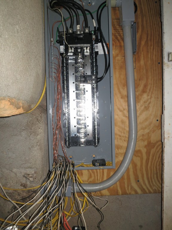

With this house I was familiar with it from previous visits but nothing recent.  The management company that held it for 9 months did nothing to protect the house.  They had someone winterize the place but multiple pipes still burst.  They had the power disconnected.  The flat roofs started leaking and they didn't patch it.  The auction had a 4 hour open house.  I didn't think I could afford the house so I didn't go.  I should have so that I would have seen how bad the management company let the place get.
By protecting it I mean things like changing the locks, locking the external basement door, and patching the roof.  That brings me to my first surprise I found after purchasing the place.  I refer to this as the "meth electrical panel".  Maybe it is a crack panel, who knows.  If you leave a house vacant and copper wiring exposed, it will be stolen.

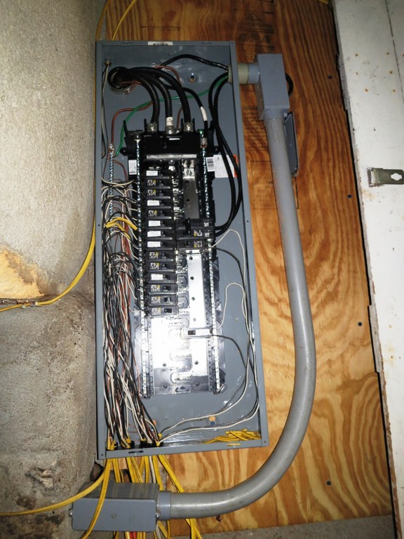

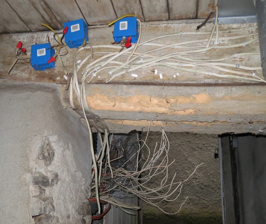

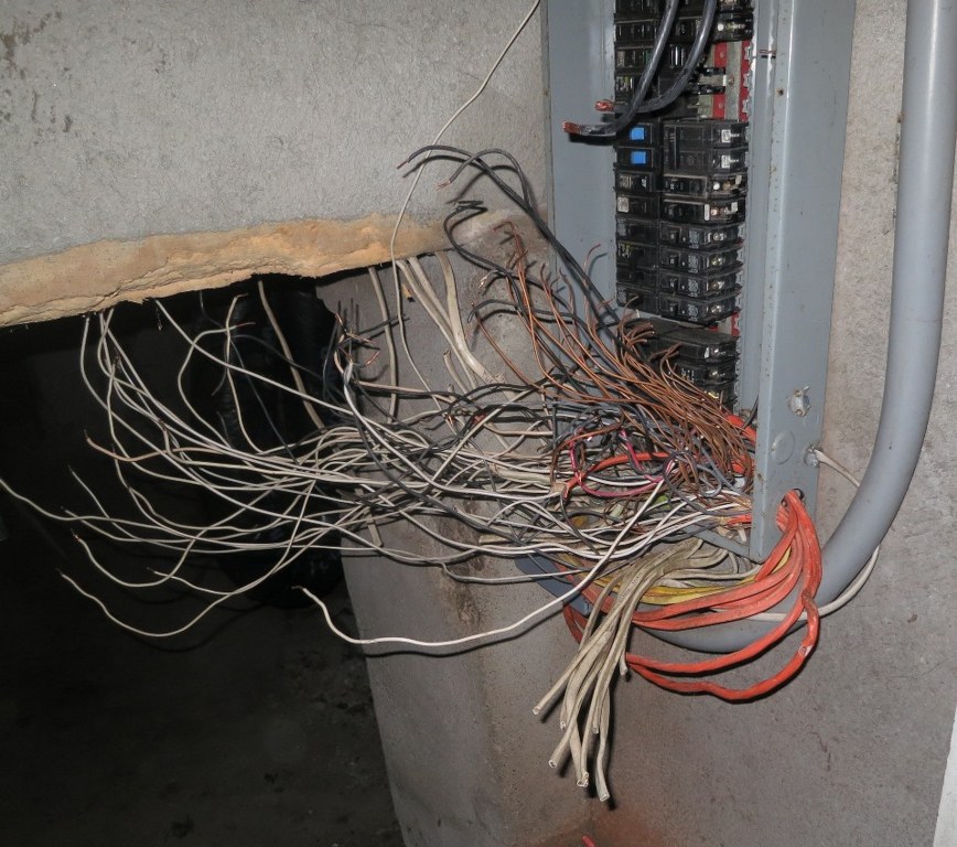

Then there are the meth circuits.  Clearly this was a very dumb meth head that decided to steal the copper.
The electric to the house was shut off.  I'm not sure if that happened before or after the person cut the copper wires.  The old panel was old and had mismatched brands of breakers.  Since the power was disconnected I took advantage of the situation and replaced the panel with a new panel and matching breakers.  Since everything had to be rewired anyway the only extra work was in removing the old breaker box.  I then installed junction boxes and patched the circuits one by one.  Thankfully the dumb meth head left enough wire that I could splice into it and left the thick wire going to a sub-panel alone.
Running the ground wires
Running the common wires
Running the hot wires
Rewired panel
Spliced together circuits

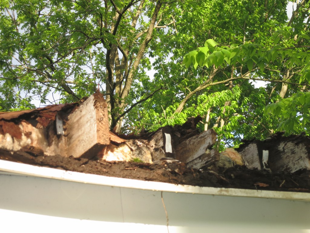

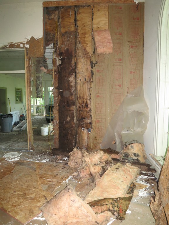

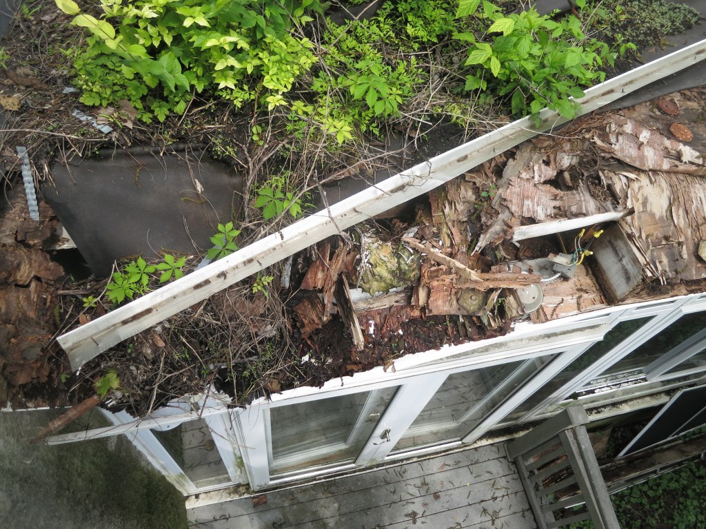

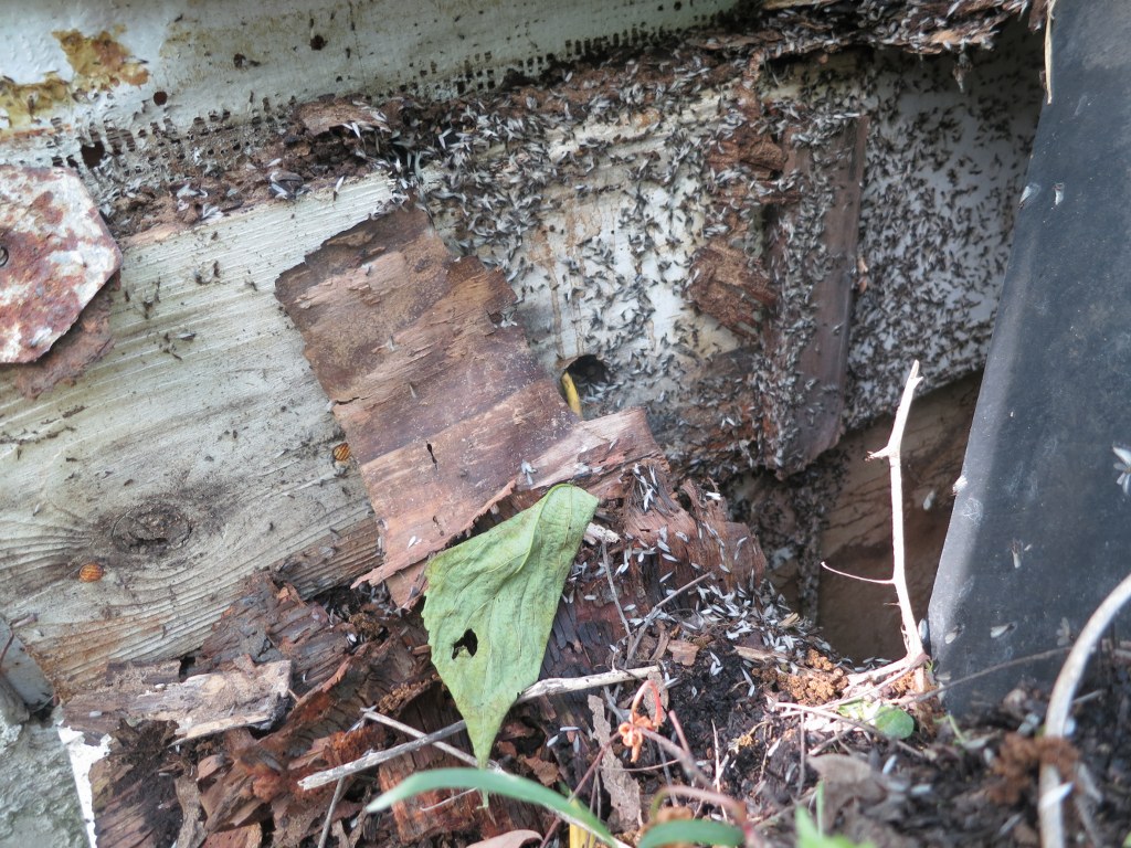

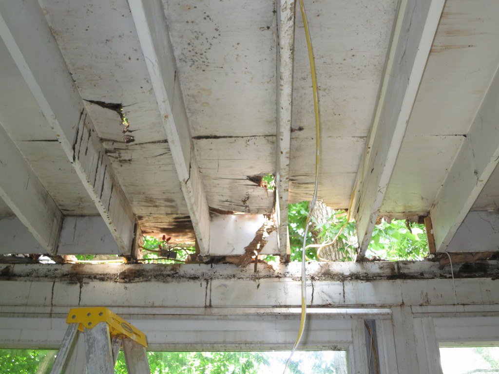

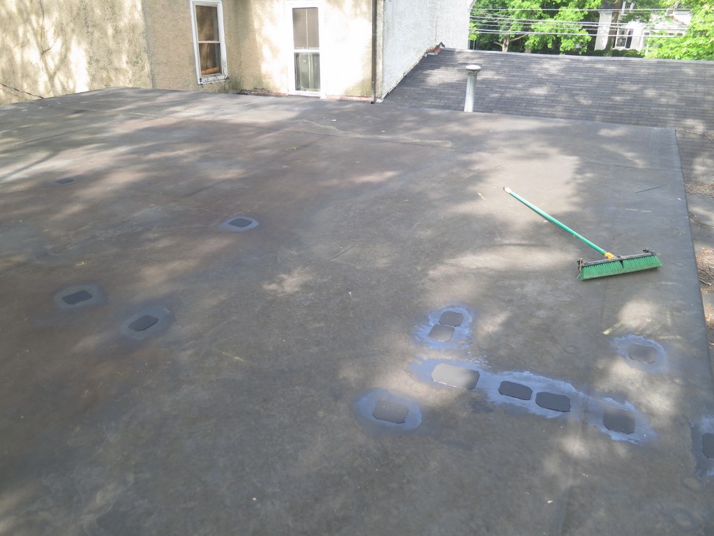

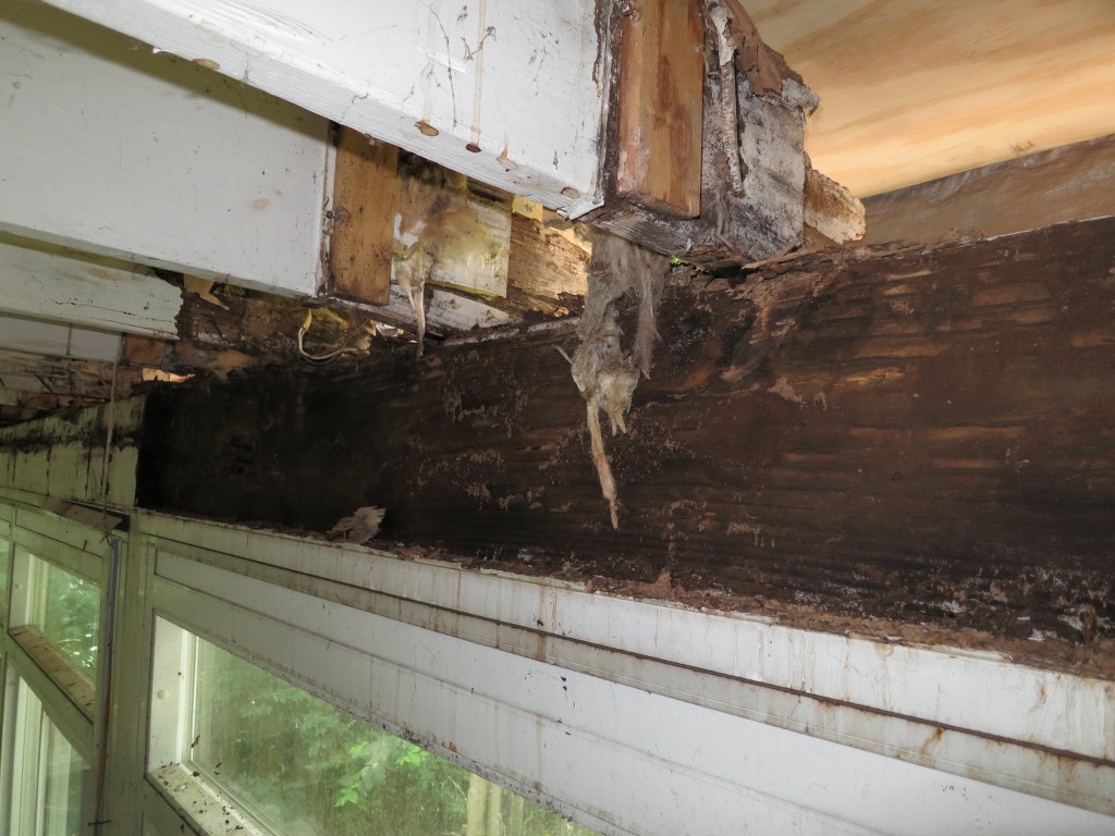

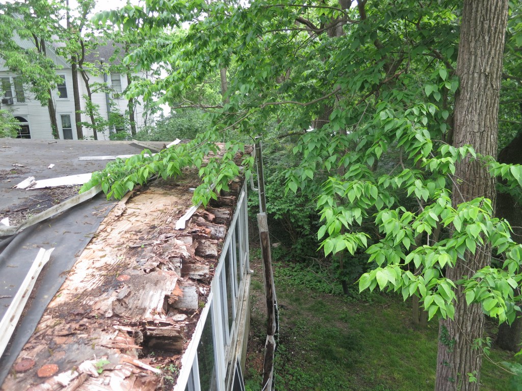

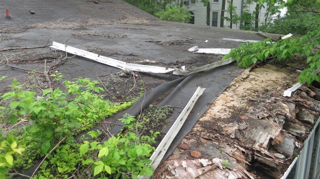

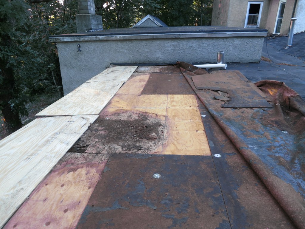

A Bad Day

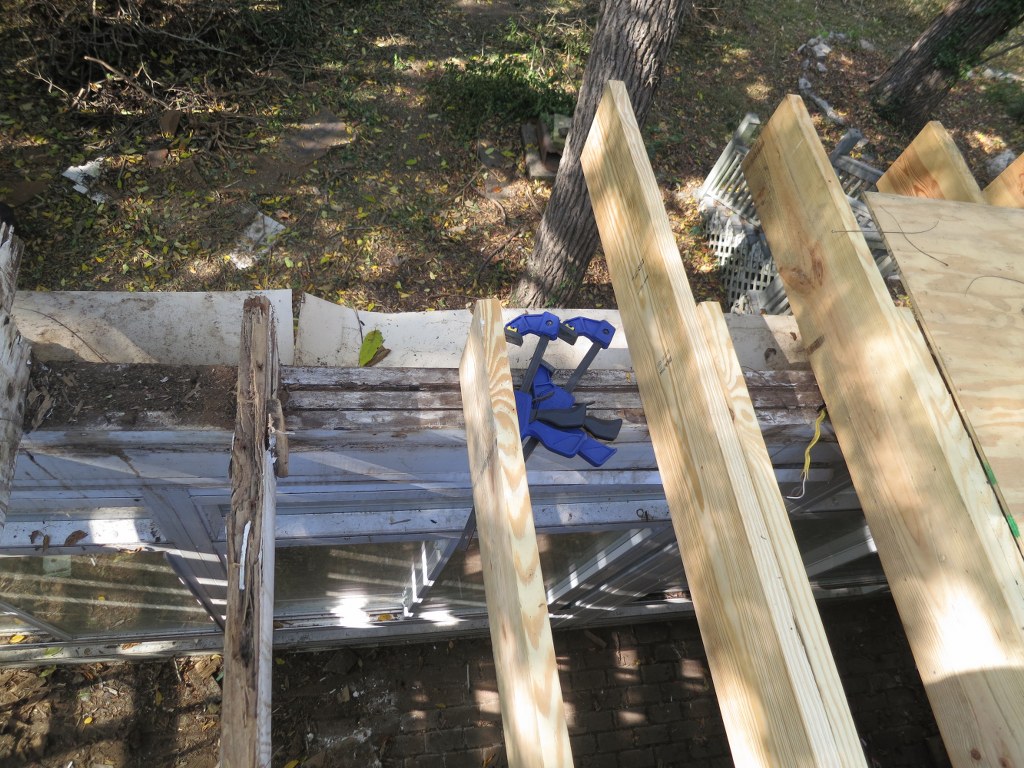

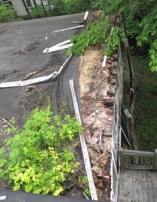

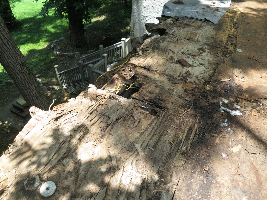

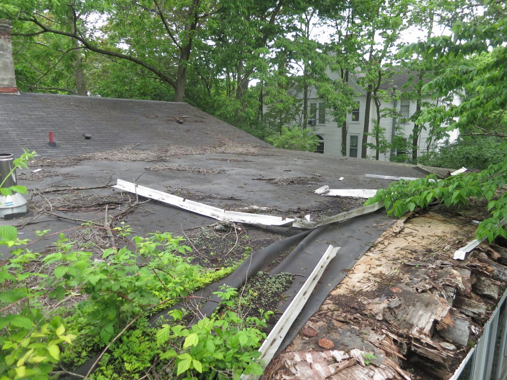

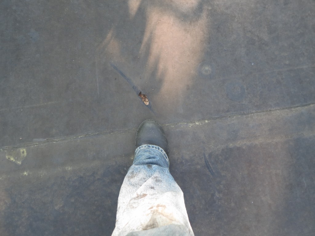

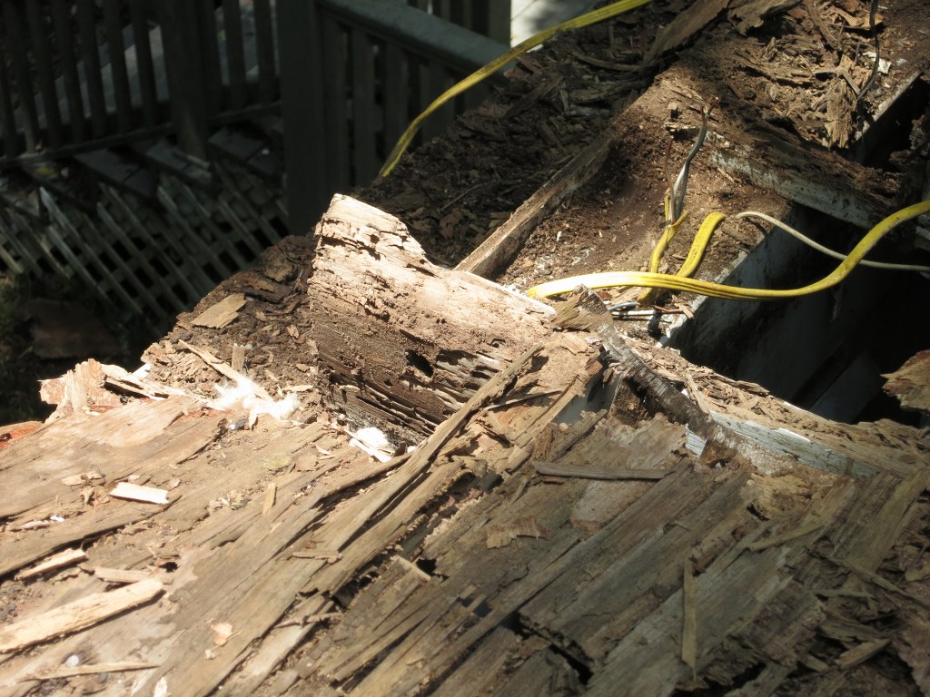

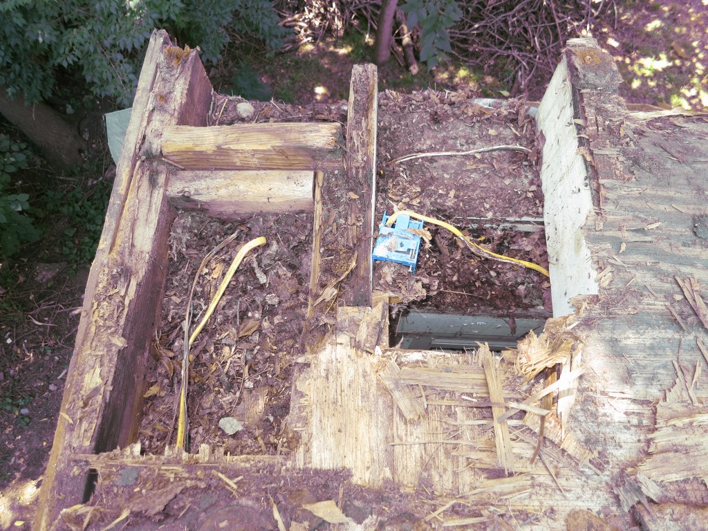

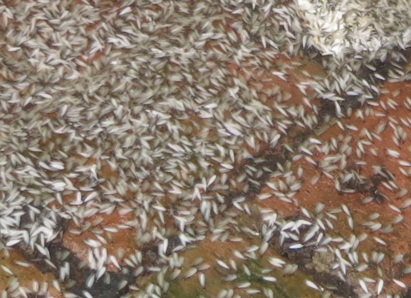

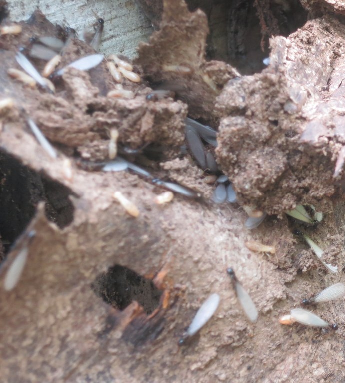

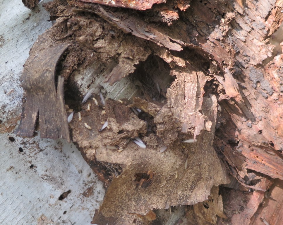

The second surprise was, not only is the roof leaking but it is infested with termites!!!!

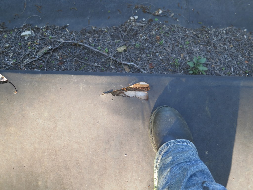

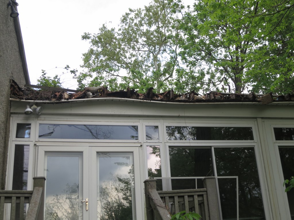

Damage to the lower section of the flat roof.  The management company actually pulled back the rubber roofing material which then directed the water towards the side instead of off the roof.  I'm not sure why as there was an overhang .  The damage to the would can be seen.  The fact that a bush is growing on the roof points to the neglected maintenance outside the house.  More on the roof later, this post is about the termites.

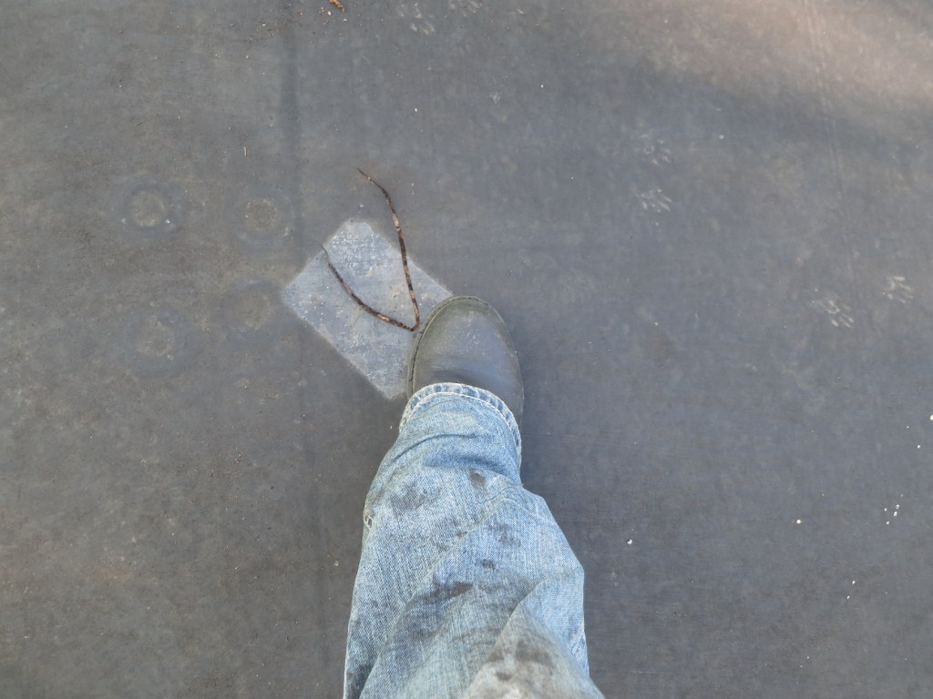

I knew about the leaking roof, that was very visible.  Once I got the house I took a ladder over and started pocking around a bit. This was early May right after a warm spell with rain, which is when termites swarm.  As I was inspecting what I thought was rot termites started exiting through the wall.

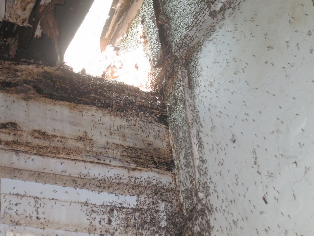

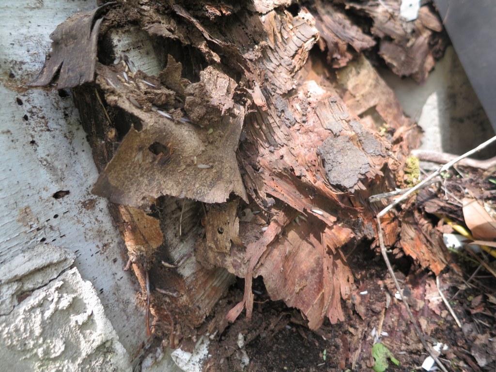

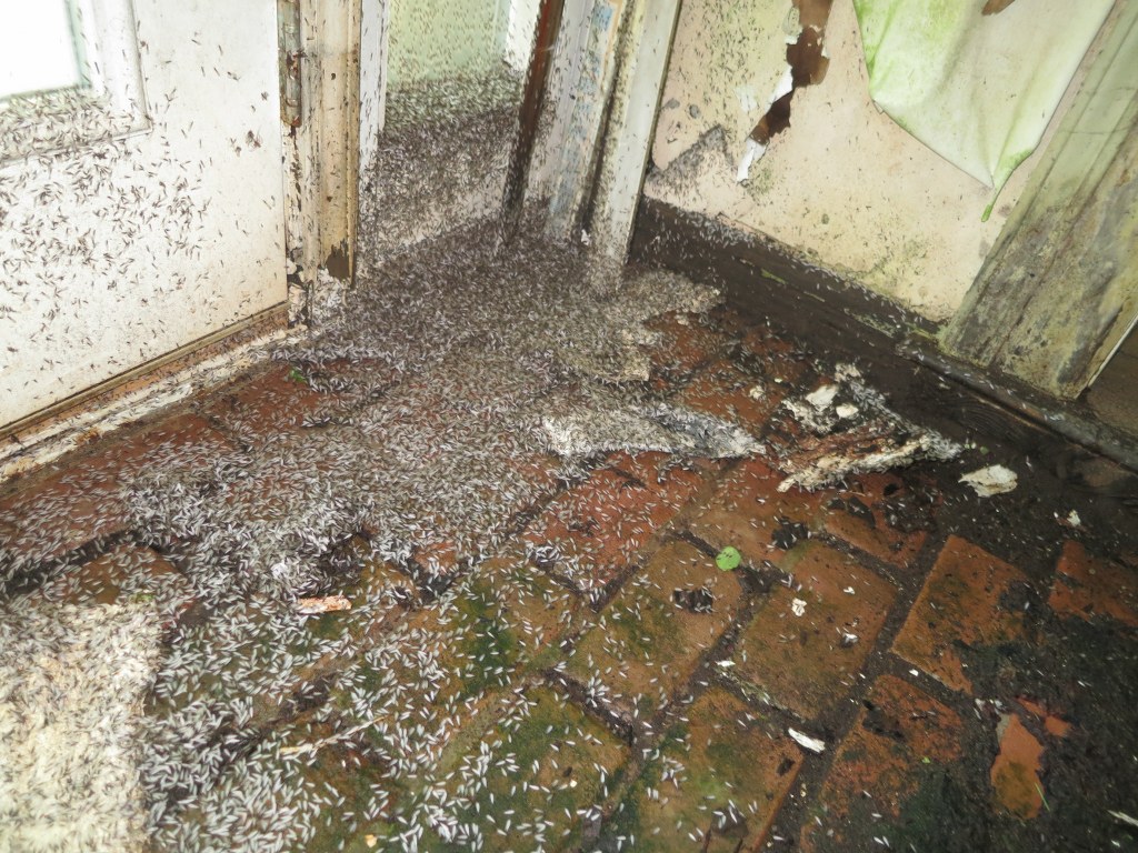

Talk about a bad feeling finding termites. To make things worse earlier that day the water company had been out and said they couldn't turn on the water because I had a major leak somewhere.  I left and went back to my other house.  I needed to fill a sprayer full of water in order to spray some of the poison ivy.  When I returned I noticed the wall was shimmering and moving.  That was obviously odd.  As I approached I realized what it was.  The termites had exited a wall inside the house and swarmed inside!!!  With some quick thinking I realized I had 4 gallons of water in my sprayer and some termite killer solution.  I quickly mixed it up and went to town on the swarm.  The end result was a termite massacre.
Every grain of rice looking thing or black spec on the wall was a termite.

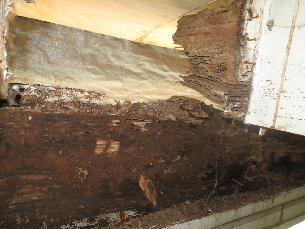

I got under the crawl space and found multiple tunnels from the ground up into the house.  I knocked down the tunnels and applied a quick termite treatment.  I will have to back and do a proper treatment but what I did should hold them off for a couple years.  Stopping the roof water from flowing through the walls and rotting the would is also a major step in stopping the termites.  They like softer easier wet wood.  Keep moisture out of your walls and it will help keep the termites away.

At that point I had no power, no water, an open roof, a roof so unstable sections could not be walked on, poison ivy everywhere, and not a termite infestation.  I was really questioning what I had gotten myself into at that point.

The roof pics and the termites pics are going to give me nightmares, and I don't even have to deal with the issues!

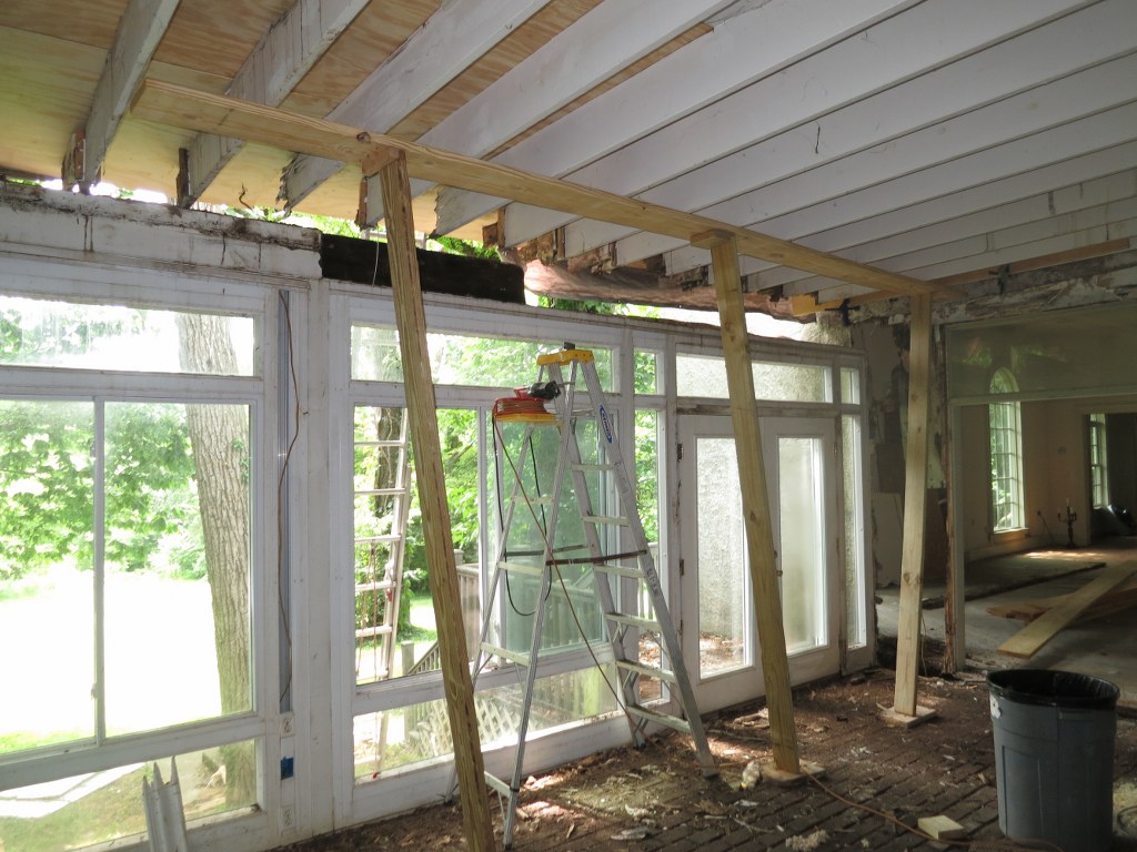

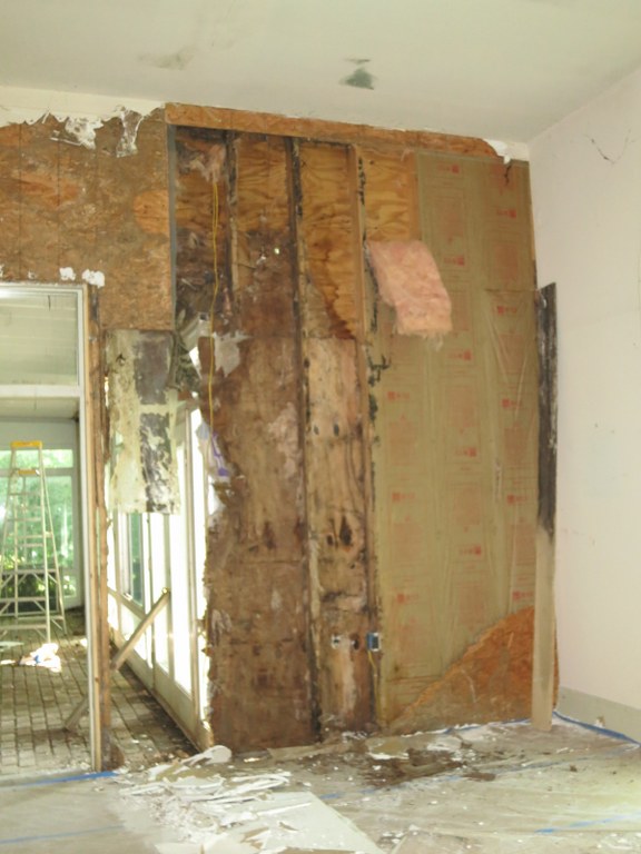

There are termites everywhere around the house.  Most of the house itself is fine as termites are not fans of dry slow growth lumber.  It isn't made with the fast growth soft pine we have now.  The addition was and the termites went to town on it as soon as it got wet.  Some of the wood was damaged by powered pill beetles or something like that.  You can see that in part of the electrical panel pictures.  They just turn the wood into powder.

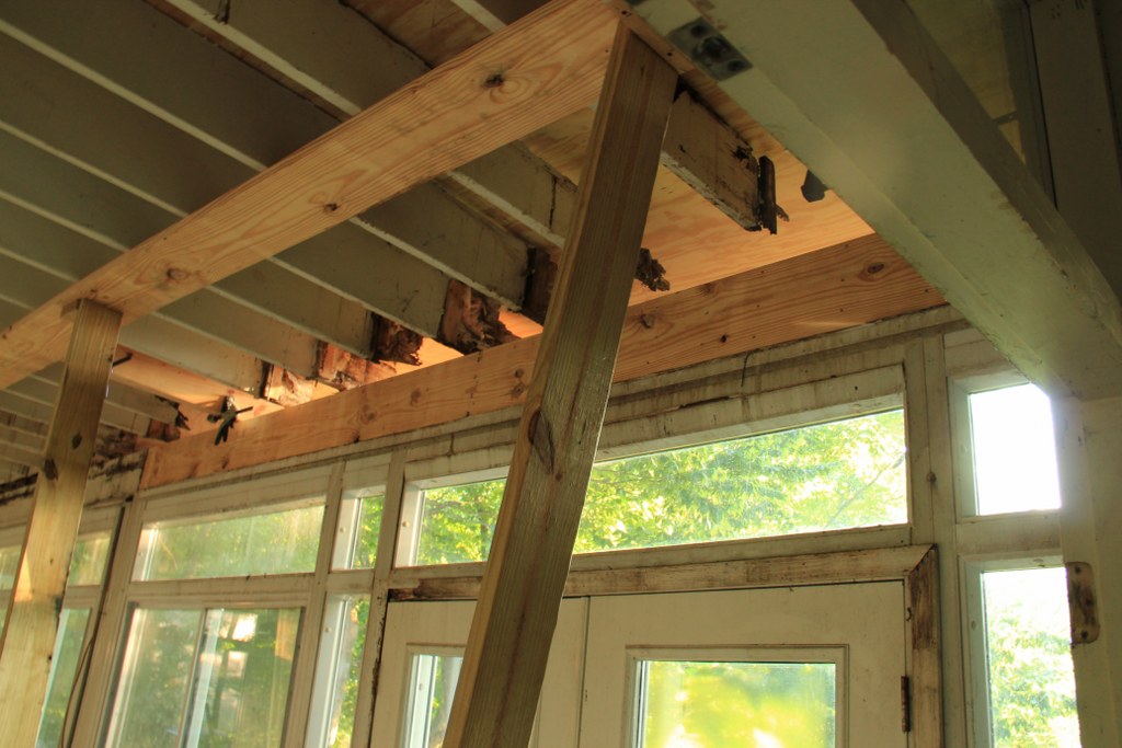

Structurally the majority of the house is very sound.  One corner of the 1812 house/addition had pulled away from the house and I believe the floor joists in a room on the second floor ended up pulling away from the wall.  The foundation was re-supported probably 50 years ago and is about 3 feet thick now.  There is a limestone rock wall, also 3 feet thick supporting part of the house.  It will need some work.
I've dealt with termites in my 1903 Victorian.  They have gotten into the house a couple times and may be back again.  They are everywhere in this area.  Treatments and keeping the wood dry generally keep them at bay.

I hate that you found termites.
The house where I grew up had swarms like that when I was really little.  We finally got it stopped, but I'll never forget what those things look like.

The first project that I focused on and it is still ongoing was the roof.  There is a 2 story section that needs to be replaced, a single story shingled section with at least 3 maybe 4 layers of shingles on it, and then the flat roofs with EPDM.  I knew nothing about EPDM before I bought the house.  Basically think of a it a thick version of inner tube rubber.  I'm sure it is made different but it acts just the same way.  It was a mad scramble to learn what the roof material was and how to patch it.  It is generally glued down to a fiber board or foam board insulation.  Seems straight forward enough but the glue is very expensive and the rubber shrinks.  Patching it requires overlapping any seam by 3" and using special cleaners and adhesives for the rubber which is different from the glue to hold it to the insulation.  I'm still working on the roof decking and issues I keep finding under it, like a raccoon skull and mismatched wires joined with electrical tape.  So until all those issues are fixed I can't seal the roof back up completely.
First up is the roof as it was when I purchased the place.
Roof Edge
Roof edge with a plant growing on the roof
Tree over hanging the roof
The hole under the plant was hole big enough for full sized raccoons to get in.  It also had holes through the tyvec where the termites had eaten through and the swarm exited.
The roof decking over the sun room not only had termite damage but it was also rotten from water damage.  Parts of it were not stable to walk on.  It was one of those situations where you had to be on your hands and knees to safely move around.  Even then the roof was unstable.  It bothered me enough that I had night terror one night and my g/f told me I jolted up in bed and got on my hands and knees just like I had been on the roof.  I don't remember doing that action but I do remember a dream where I thought I was going to fall through the roof.  Fun times.
Not only was the roof destroyed but since the management company did nothing to protect the property rodents chewed up the electrical wires.
Rotten roof with some new sheeting laid out on it so that I could at least walk on the roof.

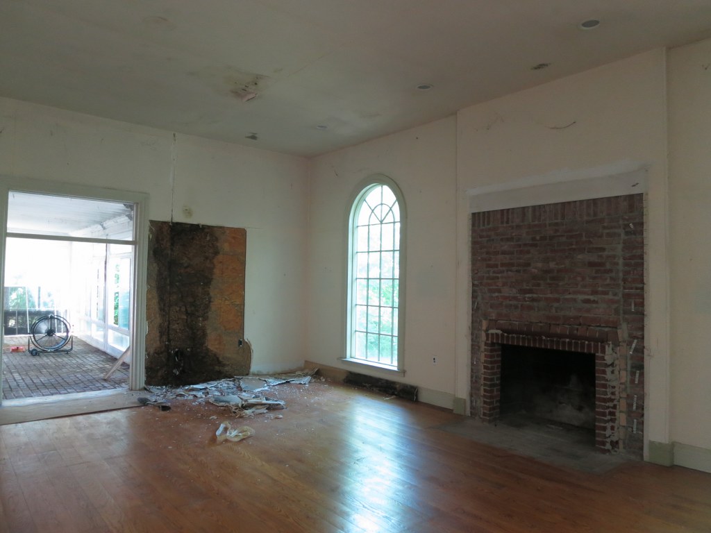

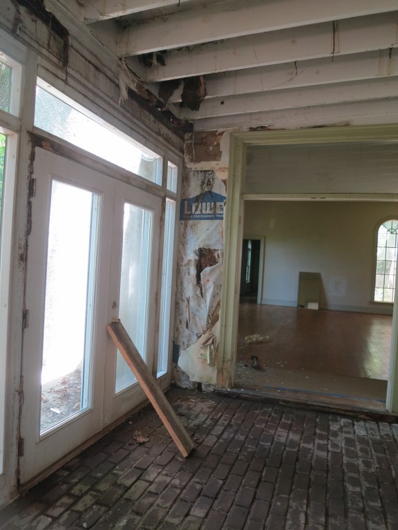

Now to the inside.  How did the termites get up to roof?  Through the wall and header support of course.  The roof was leaking into the wall and rotted the header and supports.
The roof over the great room is also flat and had small holes with a few larger tears.  In all I believe I put 29 patches on the roof.  It took a few hours.  In that respect EPDM is great to work with.
My first completed project, at least for that section of the roof.
The lower roof is the much bigger project.  The header had so much moisture and was chewed up so bad that when I was pulling it out earthworms started coming out of the header.  You know you are screwed when earth worms crawl out of wood 14 feet above ground.  I never thought that was possible but I swear it happened.
Just an FYI.  All of this work was completely solely by me.  I had help getting the 2"x10"x18' delivered but every piece of wood was lifted and nailed into place with no help.
The first step was to jack up the roof and get the weight off the rotten header.
Second step, install a new 2x10 by 3 with a plywood strip in the middle built.  I built it in place as there was no way I would be lifting the completed header by myself.
Even with the new header all the joist ends were rotten and not of much use.

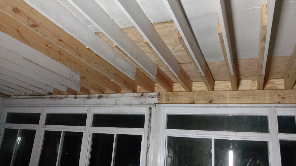

To solve the rotten joist problem I used sister joists and also cut off the ends of the rotten joist and "spliced" in good wood.  The reason for the splice is a good nailing surface for the sheeting seams.  While this technically isn't a proper fix it is good enough for now.  The whole roofing system needs to be redesigned and this will buy some time until that happens.
Finally (sort of) the rough framing is done.  I still need to put some braces in place where the exterior sheeting fits into the joists but the header, joists, and external sheeting are nailed in place.

Well as one of my other threads shows I have bad wiring under the roof sheeting.  Much easier to work on when I can open the roof.  So replacing the existing wires, running new lighting circuits, and running network cables for multiple security cameras.  Also the ladder rafter is nailed by a couple 2x4s.  Seriously, the 18 feet span only has a couple 2x4s holding it in place and it is already sagging.  So I need to push that back into place and then properly build it.
http://www.afterhourtechs.com/millspring/roof/roof_rotten_top.jpg
http://www.afterhourtechs.com/millspring/roof/roof_rotten_hole.jpg
http://www.afterhourtechs.com/millspring/roof/roof_rotten_chewed_wires.jpg
http://www.afterhourtechs.com/millspring/roof/epdm_hole1.jpg
http://www.afterhourtechs.com/millspring/roof/epdm_hole2.jpg
http://www.afterhourtechs.com/millspring/roof/epdm_hole3.jpg
http://www.afterhourtechs.com/millspring/roof/epdm_patched.jpg

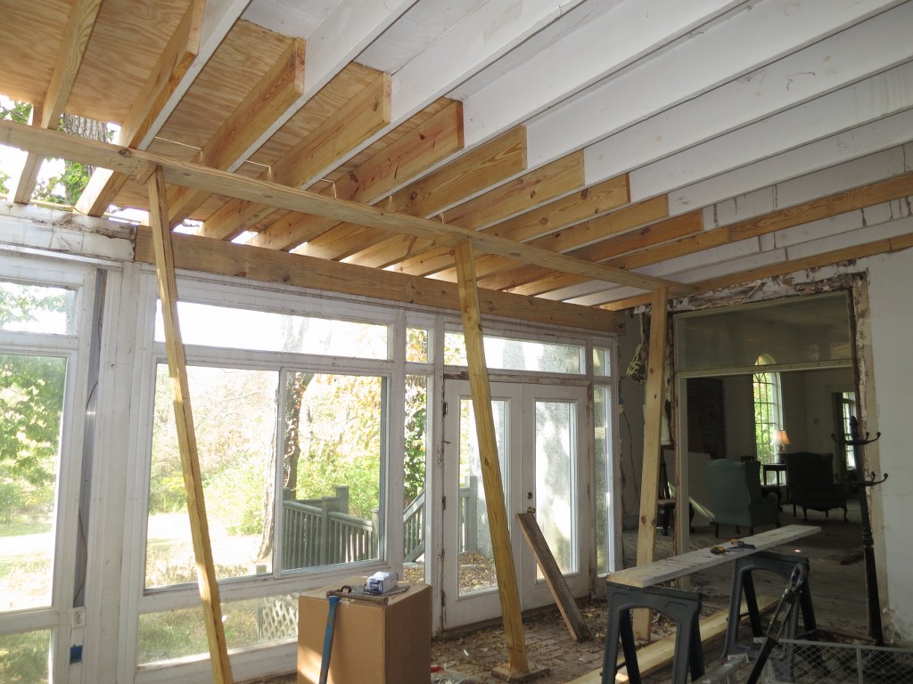

http://www.afterhourtechs.com/millspring/roof/header_removed.jpg
http://www.afterhourtechs.com/millspring/roof/new_header_rotten_joists.jpg
http://www.afterhourtechs.com/millspring/roof/new_header_sister_joists.jpg
http://www.afterhourtechs.com/millspring/roof/sister_joists_top.jpg
http://www.afterhourtechs.com/millspring/roof/roof_rough_framing_done.jpg

Originally Posted By protus:
Fyi.
On the flat roof.
Project I was on. They removed the old. Sheet..with tar..pea gravel. Replaced with a foam  base and rubberized sheet.  I'm sure tech has evolved in the last 15 years. But even then it's basic tar paper..them roll roof. Think shingles but in a 48 inch iirc roll. Similar to tar paper. Seal /over lap the seams.
Just from what I've had to do a see.
Mines pitched but it was replaced in 07'. I'd like to do a roof over . Thermal barrier and them metal.
At first I thought I had the rolled roof like you described.  Then I looked at replacing the roof with that.  Once I learned about the EPDM material though I liked it.  It is used a lot more in Europe than the US.  Instead of getting a 48 inch roll you can get 10 and 20 foot wide rolls.  Fewer seams means fewer seam leaks.  Patching is also very easy.  The previous owner wanted to preserve the original roofs to keep everything intact.  I'm not sure I will do that.  No one cares about the roof substructure.  I won't be changing it any time soon anyway.
