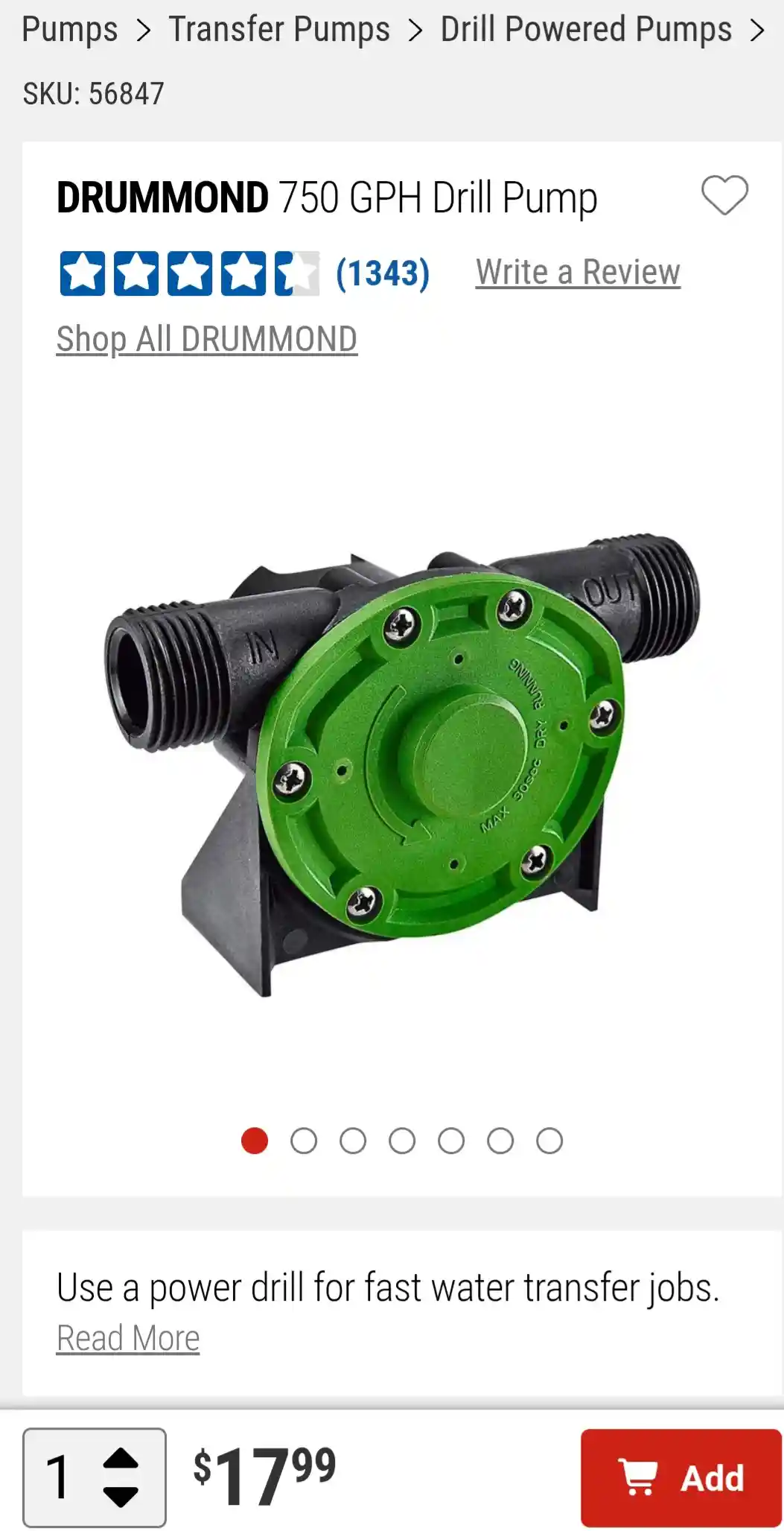

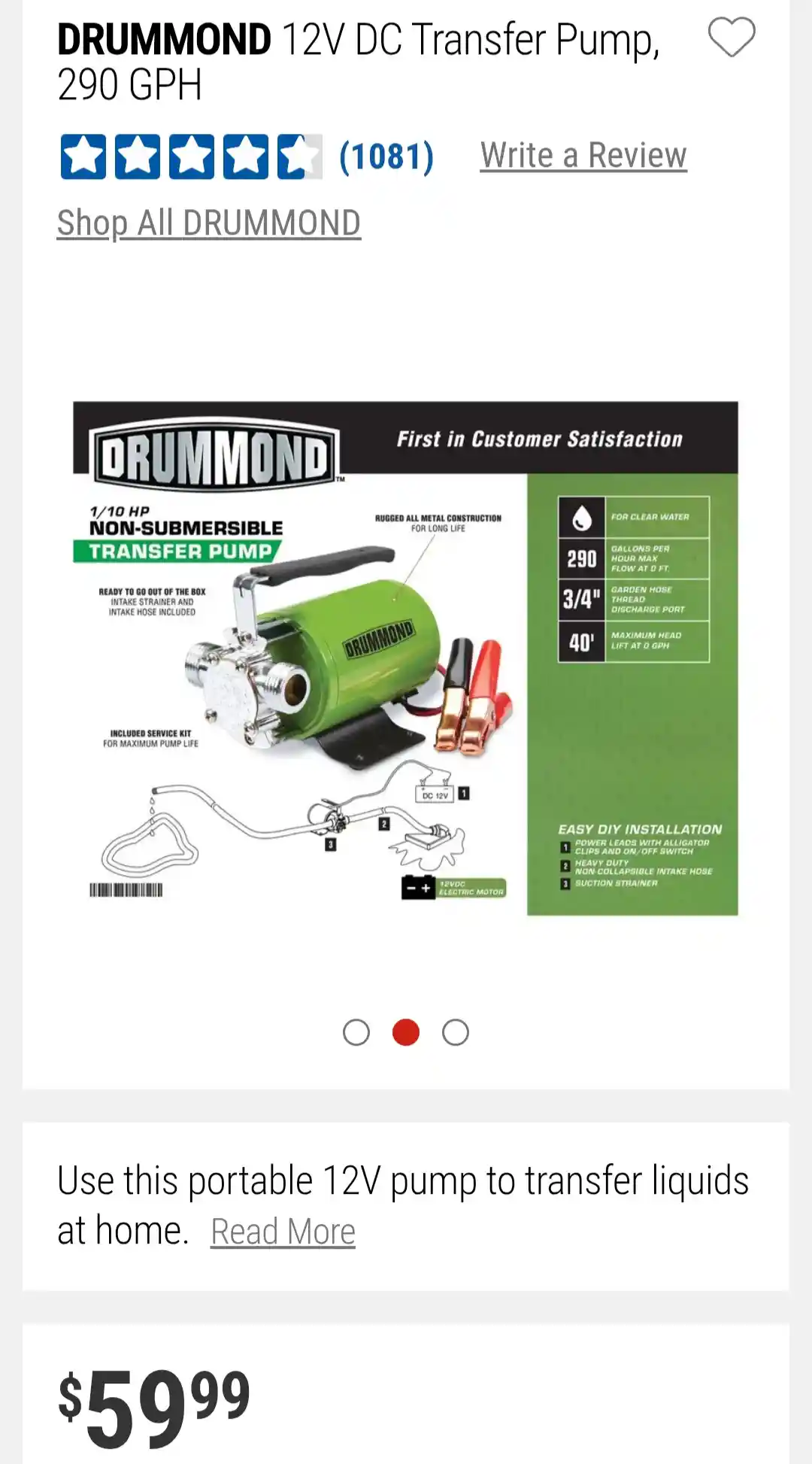

idk if this would work for what you need, but it's a drill powered and a 12v pump.
12v pump,
