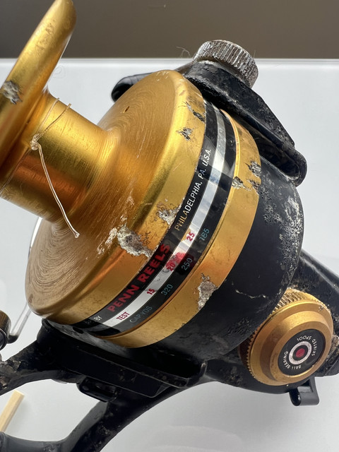

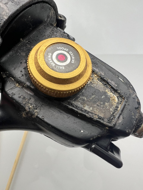

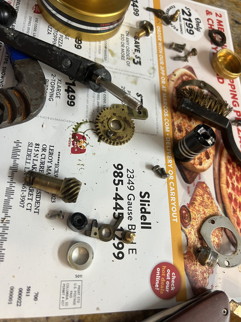

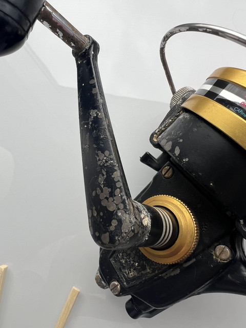

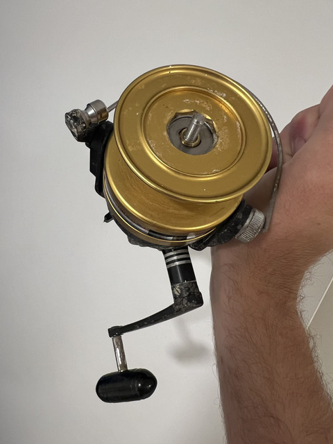

We were doing some fishing for peacock bass in the Fort Lauderdale area, found a reel in the grass. The spool was about 20 feet away from the body, drag cap missing, no rod to be found. Best I can tell, somebody who didn’t know about fishing brought a BIG old Penn out to a little pond, lost the drag cap, tried casting and the spool fell off. And then took the reel off the rod and left it there in the grass. So I cleaned it up in vinegar and stripped all the old line off the spool. It definitely spent some time underwater. But being a gen 2 Spinfisher, it was made between the 70’s and 1992 so who knows how many hurricanes it’s been through. I have it home now, got it completely apart in pieces and I’m degreasing the old 1970’s grease off the gears. I ordered a few new carbon drag washers, a new style levelwind gear and pinion combo, drag cap with seal, and some other small stuff for another reel I have. I love Mystic Parts (formerly Scott’s bait and tackle). I’m going to put it on an old ass 9’ surf rod and spool it up and fish it.

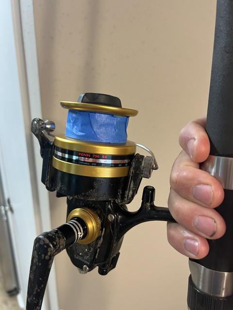

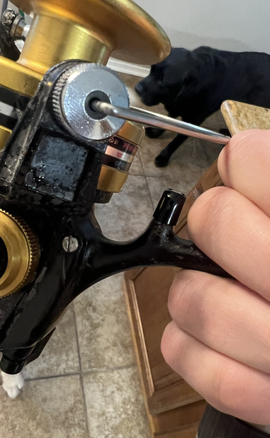

I got it completely cleaned up, greased the gears with some tacky lucas marine, soaked all the bearings in 30w oil, then coated the drag stack in starter bendix lube. In case you couldn’t tell, I have automotive lubricants lol. The drag stack was so salt crusted in, I don’t even know how it was spinning before. Now, it’s smooooth. All of the corrosion on the nail and other chrome/stainless parts was superficial and cleaned off with a pot scrubber. I’m going to have to take it apart again when the new parts show up, but now I know how.

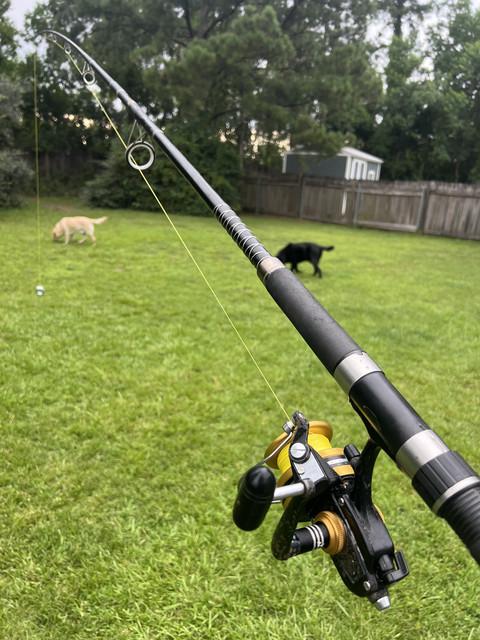

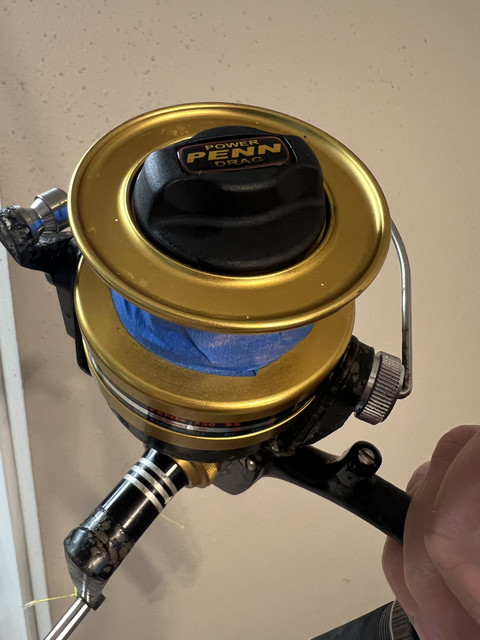

There we go, crosswind gear and block replaced with the updated version, Teflon washer inside the drag stack replaced with another greased carbon, and the drag washer hat installed. I’m happy with it. Can’t wait to kill some fish with it
