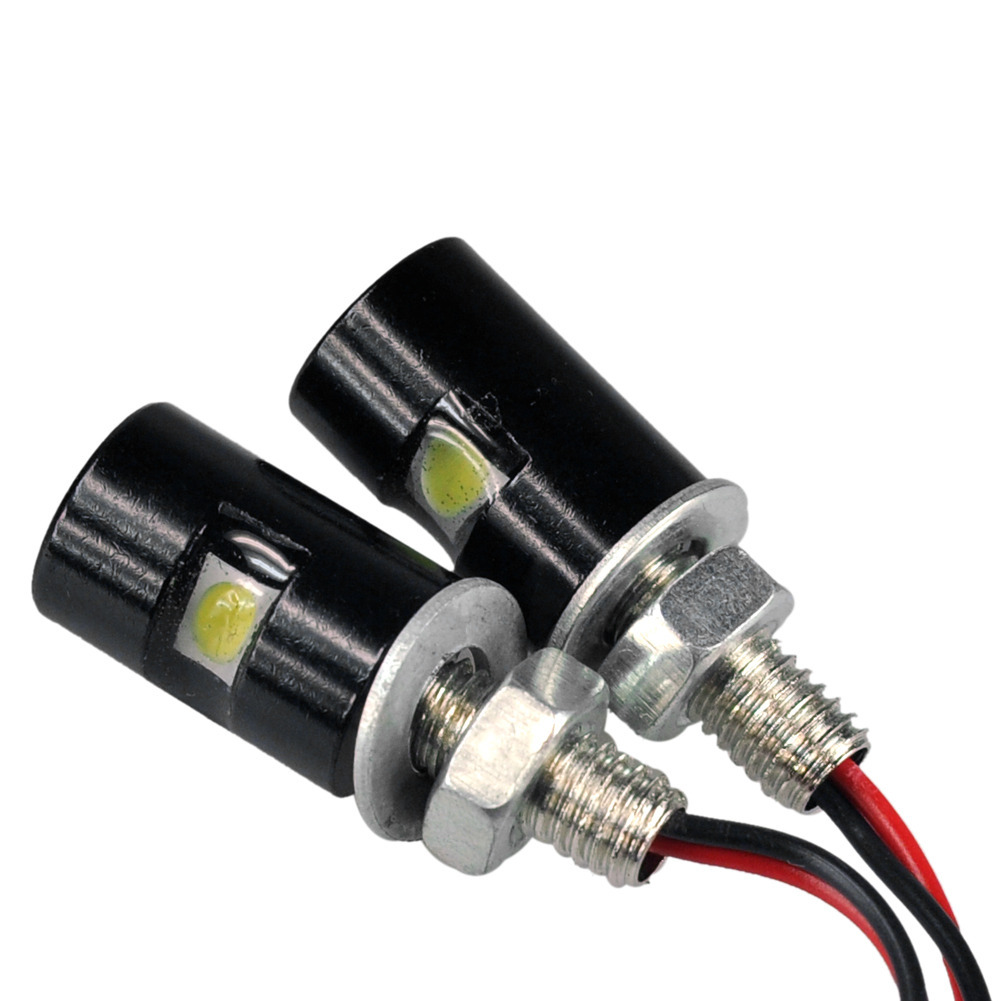

Nice setup. Don't forget a red (or other color ) led to shine down from the inside of the top. It's nice to be able to write without holding a flashlight.
3/18/2018 4:40:15 AM EDT
It's also nice being able to see the controls on the equipment, what with so few rigs having backlit knobs and buttons -
Fortunately, in this era of ricers and brodozers, we have a bazillion different styles of inexpensive LED sticks, adhesive-backed strips and "accent" lights to choose from...
