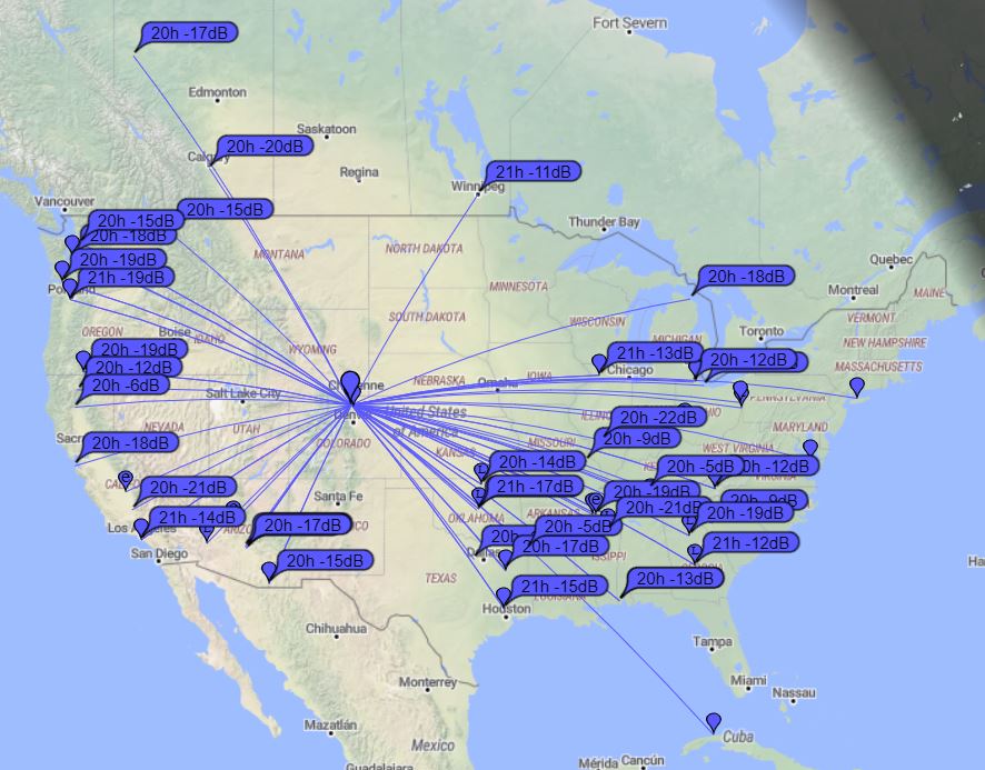

40m from dusk to dawn has been rocking for me lately, this was JS8 last night:
https://i.ibb.co/m8sB12j/Capture.jpg
Thats awsome!
