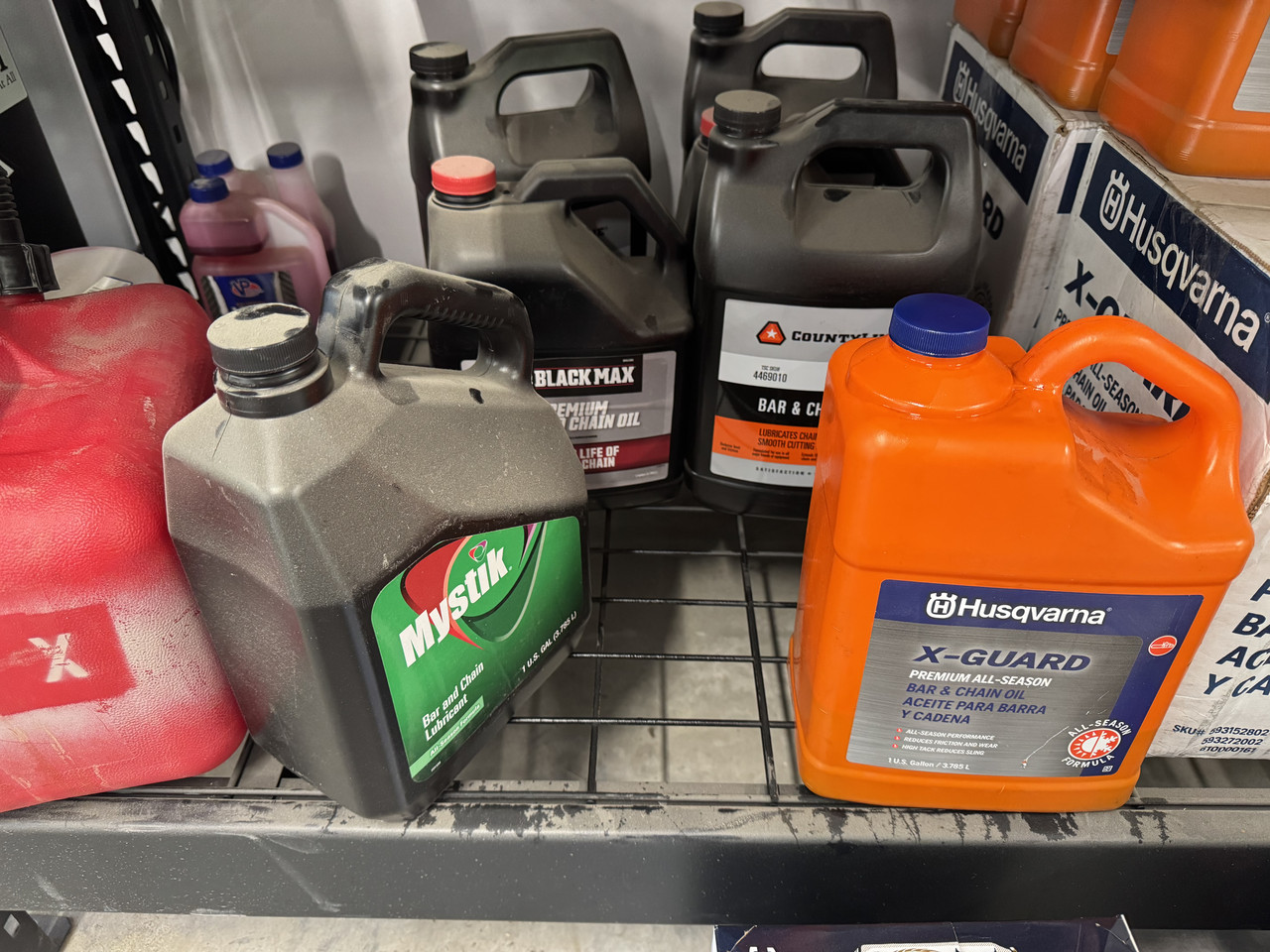

Damn people, don't do the used motor oil junk.  It's dirty, nasty, filled with stuff you don't need to breathe, and lubricates like muddy water.  Just because grandpa did it doesn't mean you have to do the same.  Save the used motor oil for the wholesome tasks like starting fires, treating wood trailer decks, or killing weeds.
Oil is cheap enough.  Bar oil is usually cheaper and better by far for the purpose.  Particularly when decent bars are well above $50 and chains are easily $30 and up.
I buy whatever is cheap.  Have four brands on hand now.  Was doing good with the local stuff until the Husky stuff popped up on Woot for like 11 a gallon with a 3 case limit.
I only use 2 gallons a year, so I'm set for awhile
No real need to bother with summer or winter blends for most folks.  I'll cut with this stuff into the double digit negatives*.    If your current stuff isn't oiling well enough you can thin it with a touch of ATF.
*  I try to do most of my felling in the winter.  Not bugs, no mud, and no dug up yard as the ground is frozen.
I like the Mystik best, but the store is almost 2 hours south of here.
