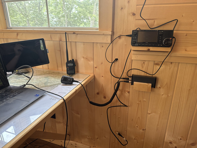

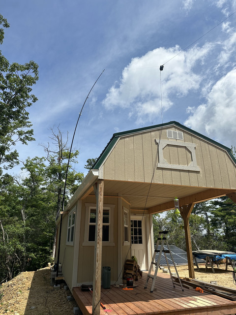

Ham radio installed and HF and 2m antennas put 30’ in the air (details in ham thread)
