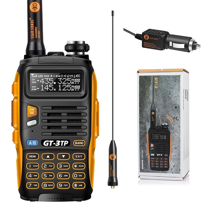

Originally Posted By aeroworksxp:
I have two GT-3tp radios. Work very well. Highly recommend. 8 watts.
https://images-na.ssl-images-amazon.com/images/I/71nnFehi7rL._SX679_.jpg
Cost?
