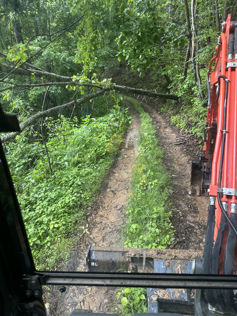

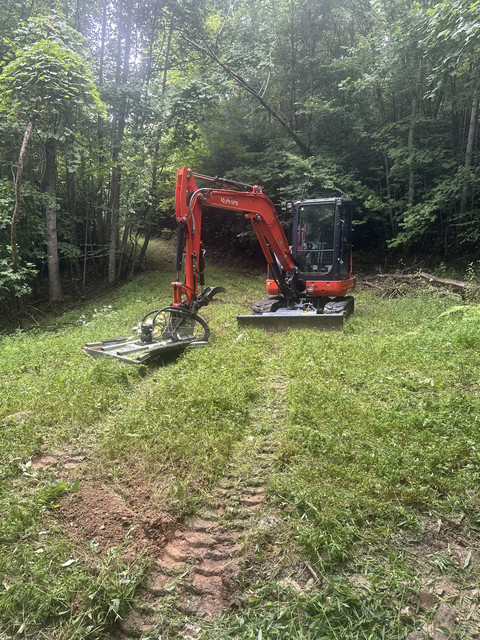

these are two of the last 3 pics i have on my cabin build thread in this forum.
kx-040.
I have been using it for 3 years now i think.  primary use is keeping the rhododendron out of my roads.  it grows so fast i have to cut it back about 2x a year.    it's also good for making the occasional trail or clearing out a bit of space in the woods, and will mulch trees up to 4" or so effortlessly.   I paid $5k for the bush hog (42" i think) and haven't had a minute's trouble from it despite accidentally hitting large rocks with the blades every time i use it.
the bucket/thumb comes in handy when storms knock trees across the road.  it's a lot safer than chainsawing in the rain on the side of a mountain, especially when two trees come down together.

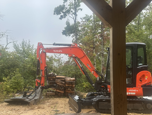

Another gratuitous pic since it’s right outside my window and pouring rain and I’m bored.
link to product, though may be different from 3 y ago:
https://www.bushmasterequipment.com/bushmaster-mx401-42sl/
