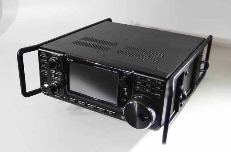

Nice, perhaps a pair of these rails would be in order to protect the VFO etc?
https://portablezero.com/
https://i.postimg.cc/c1nP7V6b/BD81-E082-F664-4-D76-AD87-BF1-D674-F36-C1.jpg
LIKE
I have those on my FT-818, they are really nice.

I've considered making side rails but currently I can put the ATU and 7300 in a single HF 4800 case. With side rails the radio would have to be rotated and the ATU put in a separate case.
