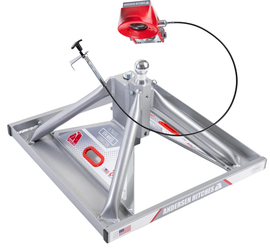

I am selling a big bumper pull and going to a 5th wheel.  I absolutely do not want a king pin hitch taking up a lot of room in my truck bed.  Since I have a goose neck work trailer, I want a 5th wheel with a goose neck hookup.
Tow truck is a Ram 3500 with the factory puck setup.
I have looked at Reese Goose Box, Anderson, ect., but not sure which is best.  I have also seen lots of conversion devices to add to the king pin to convert to a goose hitch but they look iffy to me.
What is the best option?
Here is the Gen-Y
Reese
Anderson Ultimate hitch

Thanks for your professional insight.  I am one of those rare guys who understands that my 1 ton is not the same as a semi and I have no desire to pull a 44 foot triple axle RV.  I am purposely sticking to about a 35 footer max and want to stay around 12K weight.  I like camping in the mountains and some RV parks do not have the most level spots so I want something easy to hitch up and unhitch even if my truck and camper are not level with each other.
I also like having some of the bed space available which you have with a ball hitch.
Finally, as I said in OP, I would prefer to just have the ball in my bed so I can easily switch between RV and my farm gooseneck trailer.
If the kingpin mount is the best option, I can go that route, it would just be a pain to remove every time I want to use my equipment trailer.

In your case I would go the gooseneck route with a coupler from one of the reputable companies (Reese, etc).
For the bed, if you don't already have a ball (which it sounds like you do) get a B&W Turnoverball setup.  The ball removes easily to completely free up bed space.  And I understand many trucks can have the B&W setup installed without bed removal.
Also the B&W kit allows the flexibility to couple just about anything with the right parts setup.
Finally if your truck doesn't have an adequate one, get an aftermarket camera that will allow you to guide the truck exactly into place for an easy coupling every time.  A  cheap dash cam with a remote monitor will be adequate. Cheat and put some stickers or Sharpie lines on the screen to make it idiot proof.

Just got done installing turnover ball on my SRW F350.   Bought a 35' 12k 5th wheel camper.   Got a deal on a 5th wheel converter that is "rated" for 20k towing. Didn't want to give up bed space for a full 5th wheel hitch.  If I don't like the converter, I'll prob buy one of the goose box type conversions like the Y2.
Going to try it out as soon as I get home from work sometime next week.  If you haven't pulled the trigger on something hit me up & I'll tell ya how it tows.

I have the Anderson conversion. The part in the bed weighs 39 pounds and can be installed or removed by one person in under 2 minutes.  It will not void any manufacturers warranty.
I have a Ram 2500 HD pulling a 39 foot Keystone Alpine.  The Anderson hitch was the best thing I have ever bought RV related.  With it, I have gone from FL to CA and back, to WA and back, to VT and back along with numerous shorter trips.
ETA got to disagree with Puzzygnu. My truck rides better, is more stable and handles better with the Anderson than it did with the 5th wheel hitch.  With the 5th wheel, we went from ID to FL then to MI and back to FL. So it is easy to make the comparison.

I did go with the Goosebox and B&W 4” Offset ball. Great setup for me in my situation.
The air bag does a great job mitigating chunking and I only have to adjust the air pressure a couple times a year. That airbag is something to consider bs the Gen-Y. I went Goosebox because it’s ~1.5” longer (from memory) from ball to pin box. So that moved the front cap away from truck cab. Easy to hook and unhook if you’re already using a gooseneck. I use a ‘22 F350 and haven’t had any clearance concerns. Either brand are good, but I personally would stay away from the Anderson due to a few failures I’ve read about.

had a B&W gooseneck set up for several years. Then we bought a 5th wheel trailer.
Went with their companion hitch, we have been happy.
