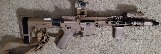

So I opened the packaging and assembly was simple. Pic 1 Pic 2
The goal was to have the gas drive adjustable without a tool, which unfortunately the DIctator was a touch too short. Mission accomplished, here is the finished product Pic 1 Pic 2

IIRC, RifleSpeed advises starting at position 4. I decided to start at position 3 (less gas) with one round in the mag to test the bolt catch. Interestingly the bolt locked to the rear.. sort of. The bolt locked but the bolt catch appeared to be behind the bolt lugs. Took out the mag and the bolt stayed open, very interesting. Opened to position 4 and had the same result. Switched to position 5 and got perfect function.
At this point I'd like to note, switching modes (with & without gloves) was easy. It wasn't too hot, I didn't need any tools, it was easy to grip, it was easier to adjust than the rheostat on some cheap stiff Chicom red dots I've tried, but was secure enough that I know it won't ever accidentally move.
I then put on my can starting at position 5. Perfect function, and I reduced it and reduced it, I reduced it all the way down the lowest position in position 1. I was still getting perfect function. It is worth noting I felt less gas in the face with RifleSpeeds position 1 (and less recoil) then my zeroed DIctator gas block, but then again in addition to the RifleSpeed gas block I also added an AR Gas Vent to replace the forward assist, so take that for what it is worth. But I did feel much less gas in the face than any other previous shooting with this host and this can.
I finished the day taking off the can and returning the block to position 5 and continued to shoot problem free (after switching to Magpul mags because my new ETS mags weren't feeding great).
