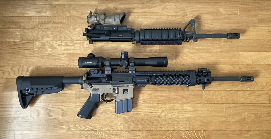

Lot of options similar to the CMR.. I’d look at MI offering
Just for reference here’s my 11” CMR on a 16” barrel

1/29/2025 1:55:09 PM EDT
https://i.postimg.cc/155hqzV6/IMG-3171.jpg

1/29/2025 3:07:55 PM EDT
[Last Edit: urbankaos04][Edited] [#9]
Now it’s working for me.

1/29/2025 3:10:06 PM EDT
[Last Edit: urbankaos04][Edited] [#10]
That looks good. What gas block are you using under the CMR?

1/29/2025 6:26:51 PM EDT
That barrel came with a standard FSB so I cut it down.. didn’t want to mess with different GB & set screws so I kept the original one with taper pins
